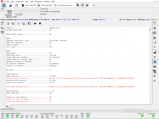

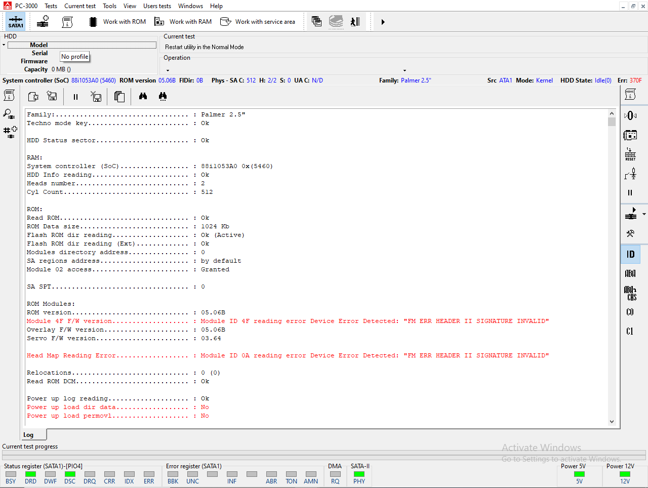

Hello everyone, I have a WD palmer family drive that shows 0MB, So I could have to try to write from donor ROM in this drive, is there any suggestion where I can find the ROM for this drive, I hope this process will help me right? Please advise guys. Screenshot attached.

Why would writing non native ROM help?

Thanks for the reply Melvin, I saw a video with the same issues and they fix it by writing the unlocked ROM and fix the case, is this not helping?

Unlocked ROM -yes it is used to fix SA related problems. You wrote about other than original ROM. This will not help.

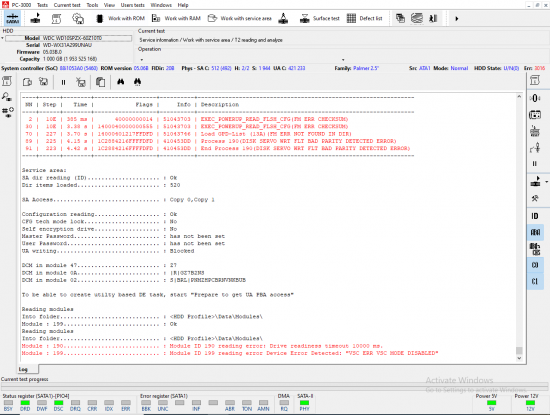

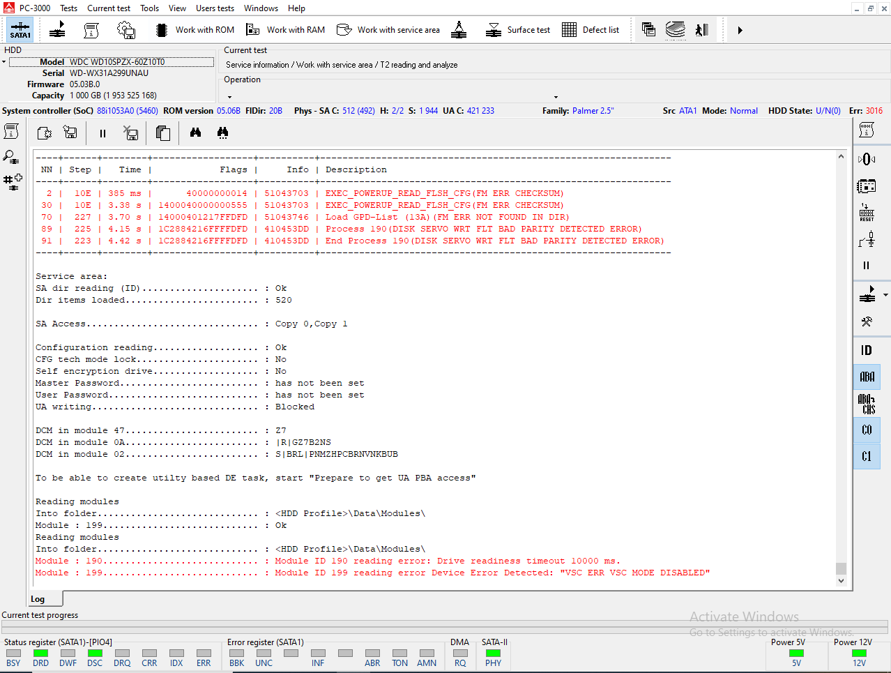

Thanks Melvin get access using donor unlocked Rom, But Know it access the sectors but no data in it, also when i tried to read Module 190 it keeps giving me errors.
Module : 190............................ : Module 190 reading error: ABA 714 251 C:1(1) reading error: Access violation at address 00000000004725DE in module 'PCKernelUDMAE.exe'. Read of address 0000000000000070
Please advise.
Thanks guys,
