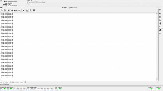

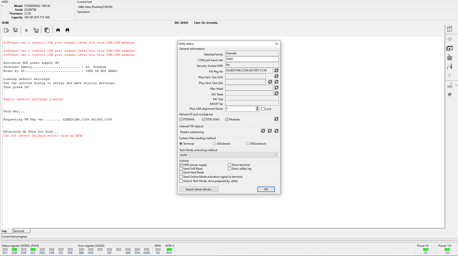

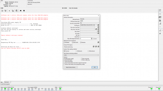

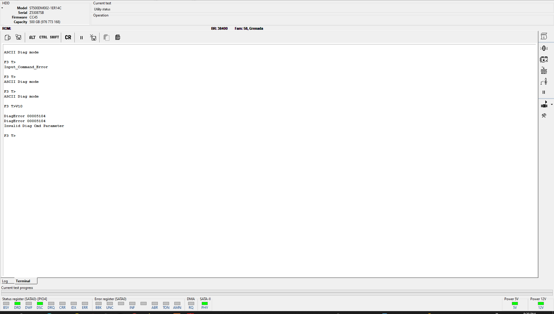

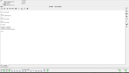

I have Grenada 58 family disk ST500DM002 -C45 , I am unable to get firmware access & hence proper sector access ( sector can be read but lots of defects even in MFT's)
What should I do now.

locked firmware?
Check in terminal if does accept commands.
If fw is locked, when you send commands on terminal, it will respond "locked"

michael chiklis wrote:
locked firmware?
Thanks michael
I can issue command so it seems is not firmware locked but I cannot access any system files .

you can send commands also if is locked, but if is locked it returns "locked".
For example, you can check if P-list is available with command V10 in level T if fw is not locked.
Does it show P-list log in terminal if you send V10 command?

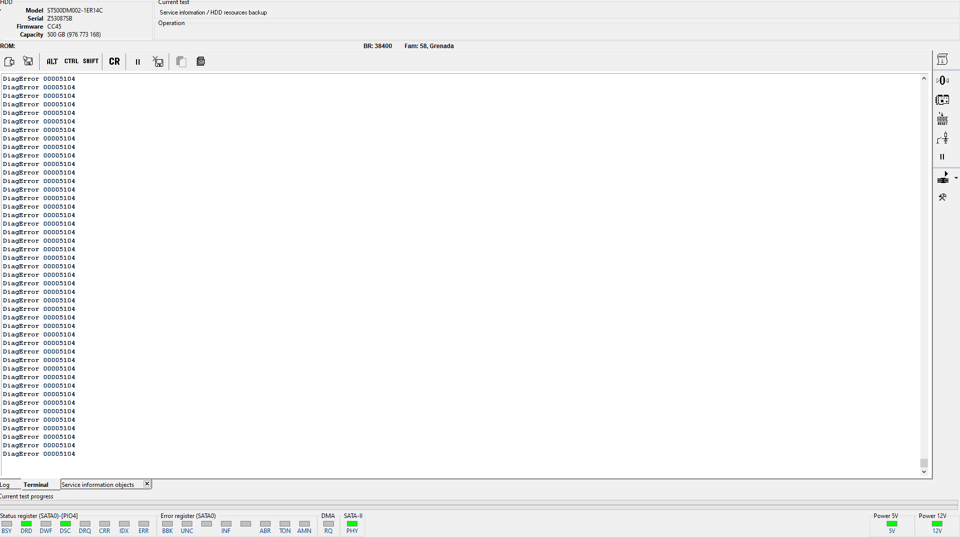

I get DiagError for both V10 & V40 commands.
 Post subject: Re: Grenada Firmware repair
PostPosted: January 5th, 2025, 9:19
Posts: 347
Location: Eastern Europe
Switch the power without turning off the terminal.
Then press Ctrl Z and Ctrl X.
This log will be more informative. Apparently (5104), not everything is read in the CA
Thanks SWM

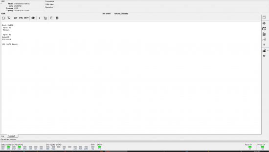

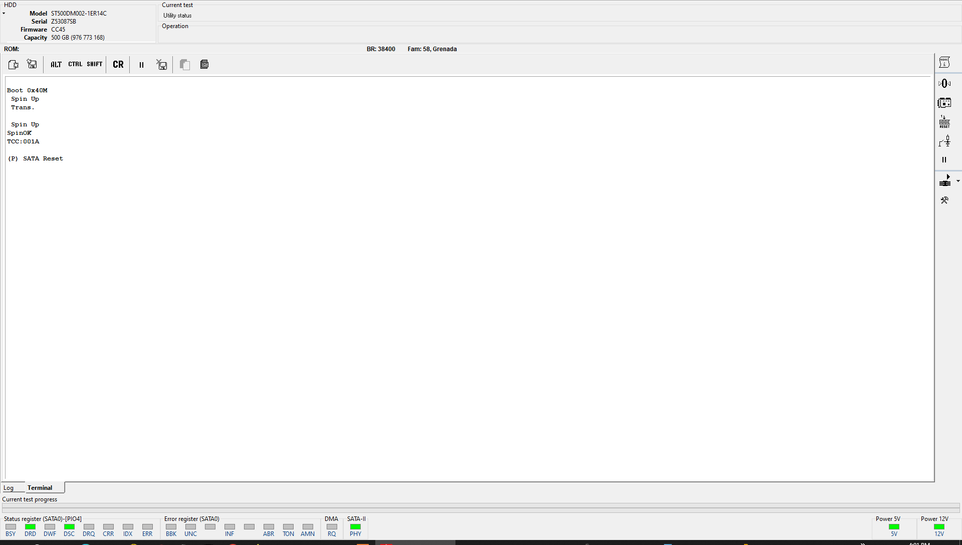

I tried this there is slight change in terminal message now
F3 T>V10
DiagError 00005104
DiagError 00005104
Invalid Diag Cmd Parameter
F3 T>
Boot 0x40M
Spin Up
Trans.
Spin Up
SpinOK
TCC:001B
ASCII Diag mode
F3 T>
ASCII Diag mode
F3 T>

After entering T> level press Ctrl+X and post here the result.

Nothing happens after CTRL+X .Drives does not show any output .It responds to CTRL+Z only.
Select the correct (USB-TTL) terminal voltage level.
I don't know how to do this on the PC3000.
Check the connections.
Thanks SWM
Finally only after head change I could recover data.
