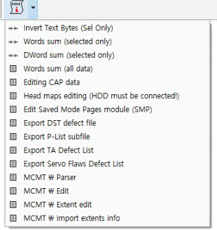

 Post subject: Re: I'm curious about smr such as Seagate Rosewood Mobile.
PostPosted: March 19th, 2025, 22:52
Joined: June 3rd, 2024, 0:06
Posts: 26
Location: 대한민국 서울특별시 송파구 문정동 96-6
taengukim wrote:
digisupport wrote:
If possible avoid writing anything to SA. Use write protection.
Read the necessary system files, how they are best read depends on the drive.
A lot of manual correction can be necessary, load into RAM and access data.
Part of the process is well documented in the manual and ACE blog.
Thank you for your response.
I read the article to activate the protection option, read the system file and applied it to low quality REM.
But is there a way to check the checksum when there is an error in the system file??
I'm curious about the checksum method.
Is there a way to check if the file system is corrupted after a forced read?
I'm asking to study!
I want to study about this function.
But how should I study this function?
If the original is broken, I wonder how I can check the checksum and how I can do it if both the fixed one and the original one are broken.
PostPosted: March 20th, 2025, 0:55
Posts: 4850
use good ones first to analyze the structure and find out CS protected blocks, etc
PostPosted: March 20th, 2025, 2:35
Posts: 26
Thank you for your answer!
Is it correct to buy a good one first and study firmware in it?
Thank you!
