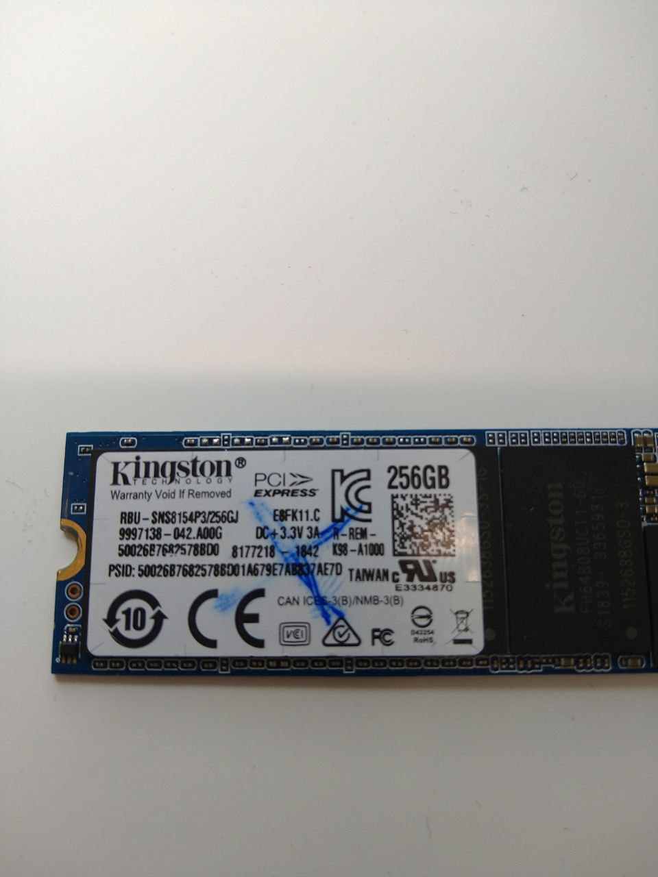

Hello everyone!
My name is Dmitry, and I need assistance with my Kingston NVMe SSD. When connecting it to Acelab PC-3000, the device is detected with a BYS error (state). I have checked the connection, and everything is physically fine, but I suspect the issue may be related to corrupted controller firmware.
SSD specifications:
Brand: Kingston
Capacity: 256GB
Model: SFH64B08UCT1-60
Serial Number: 115268365090-3
Controller: Phison FH64B08UCT1-60
Interface: PCIe NVMe 3.0 x 4, M.2 2280
Additional markings: RBU - SNS8154P/256GJ, 9997138 - 042A00G, 50026B728675B800, 8177216 - 3V.A. REM, 20-82-10073-A00.
Has anyone encountered a similar BYS error with a Phison-controlled SSD? Are there recommendations for diagnosing or reflashing the controller firmware? Could additional equipment (e.g., a programmer or adapter) be required to resolve this issue? I’d appreciate any advice or suggestions for data recovery!

upload a picture of the drive, but usually it's two points at the other end of the connector, they're pretty obvious.
Do you have pc-3000 portable III?

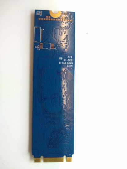

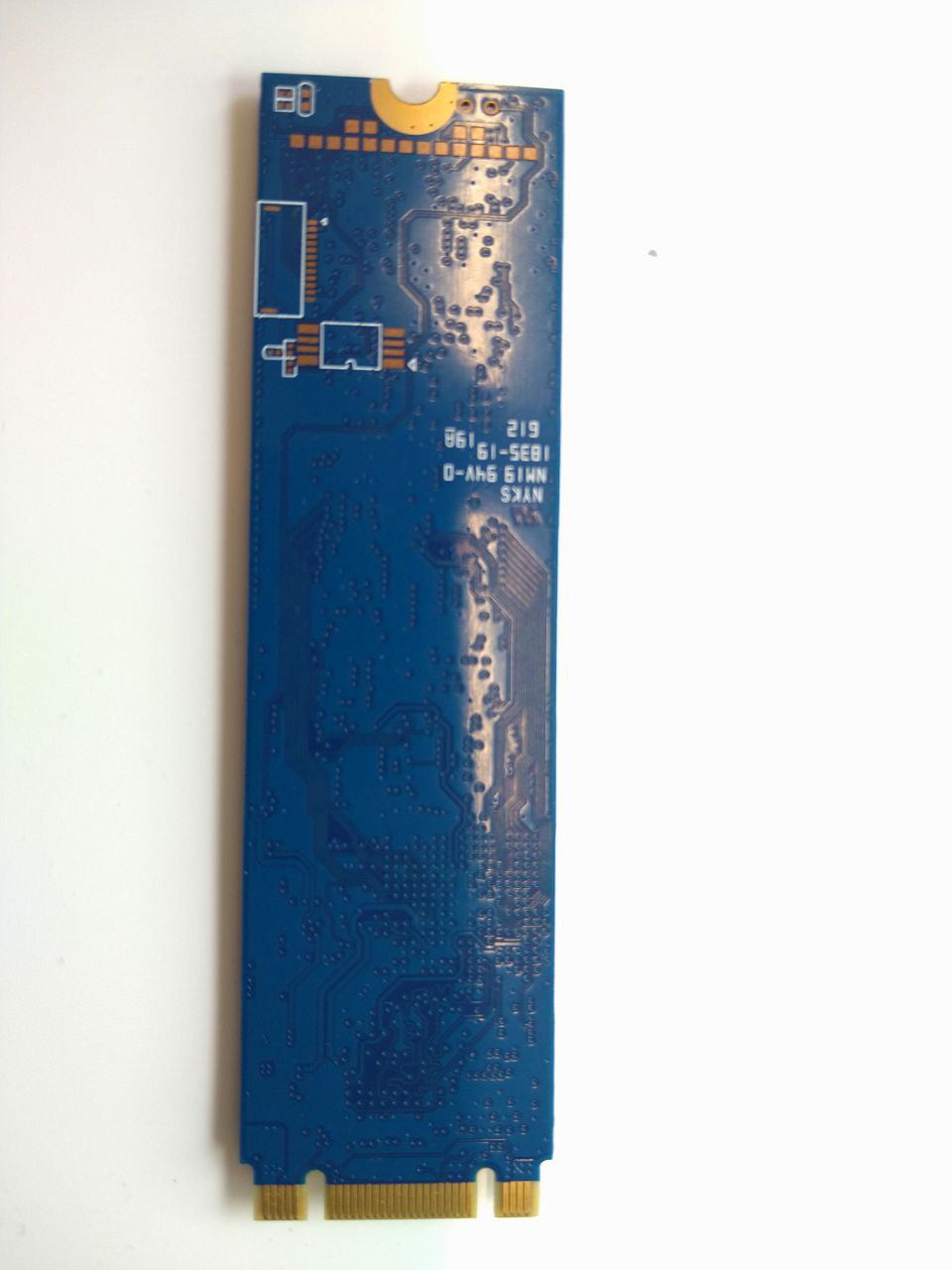

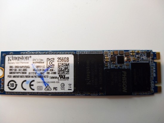

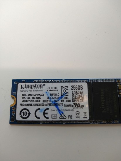

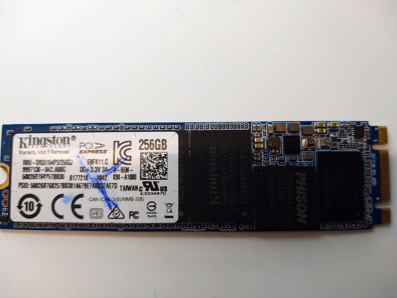

As requested, I’m attaching a picture of the drive to this message. Thank you for the tip about the two points at the other end of the connector—I’ll try to locate them.
Unfortunately, I don’t have the PC-3000 Portable III. Is there a way to resolve this issue without the PC-3000 Portable III, or do I need to purchase it? I’m very eager to learn more about this field and would be incredibly grateful for any advice or recommendations on how to proceed!

 Post subject: Re: BYS Error (State) When Connecting Kingston NVMe SSD to A
PostPosted: May 9th, 2025, 3:48
Posts: 3551
You're welcome.
However, without PC3k Portable, you won't be able to proceed.
Assuming that the drive suffers from a fw fault or a controller fault (which is not certain at this point and the drive needs to be evaluated properly), it would have to come to the so-called safe mode, then load an appropriate loader via pc3k, then create a virtual translator and start the drive with it.
Buying pc3k portable I think is a very steep move. I mean, it's 20k, I'm not in your pockets, but forking out 20k for one case is a bit crazy. And, as I've said, at this point you don't even know what's wrong with the drive.
My suggestion would be to consult someone in your area that owns pc3k portable and go from there.
