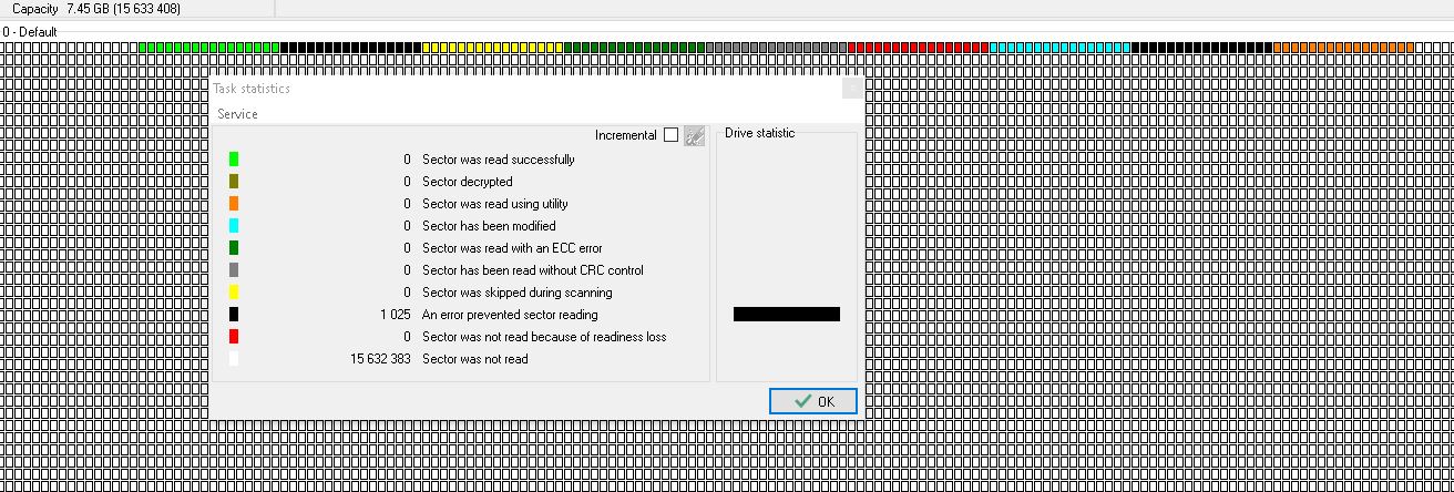

Has anyone created or know of a way to translate the sector map file from DE into a nice graphic image showing a clear image of the read patterns for easier explanation to our clients? DeepSpar DRE has it and there are dozens of times a year I wish I could do it with PC3K.

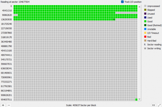

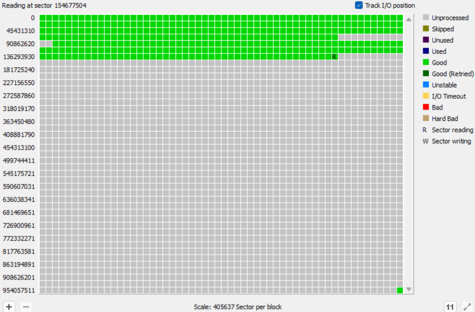

Even the zoomed out view of the image map from R-Studio can be screen captured for the client to see.

Quick look suggests not. Sample files attached, green = good, black = error, Yellow = skipped. 8GB Flash drive 15633407 total sectors.

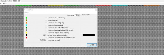

10 sectors of each 00 -> 09 and the legend from my version of DE.

PostPosted: June 18th, 2025, 17:44
Posts: 1321
Sorry my fault for not making it clearer, each map file is a separate read and after each read I cleared the map in PC3K resetting the file to everything unread (00). Everything 1024_ are all just the first 1024 sectors read in the different states, 1024_last are the last 1024 sectors of the drive also read in those states. It made more sense like that (at least to me) when exporting ranges to look for commonality in the files.
