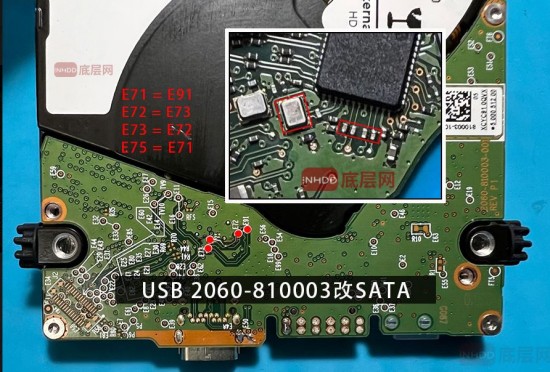

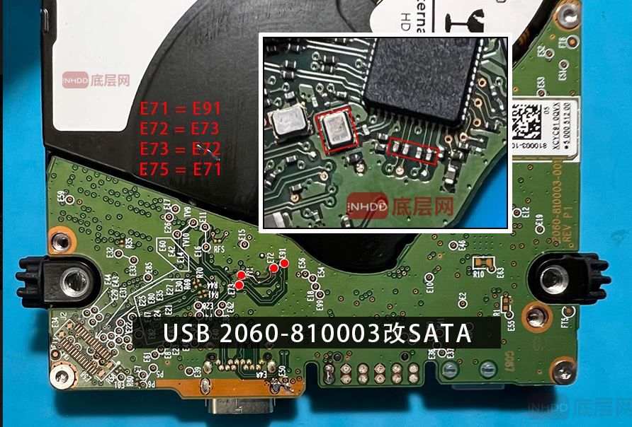

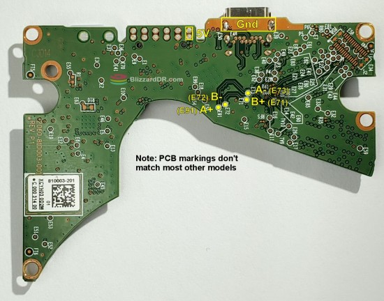

hello there i came across one page regarding "usb C to SATA" conversion by blizzard data for the PCB 2060-81003-001 REV P1 i believe the wiring is correct however i saw another post by chinese person were they did soldering on different PIN numbers so got confused..... do someone know which one is the correct? sorry im getting old

Looks identical to me.

thank you for the answer Sir. i dont know which wiring is the correct for my PCB
i found two different wiring on the web but im confused...can you tell me which one is the correct?

The two pictures are showing the same

I would find a photo of a SATA PCB with the same MCU and follow the SATA Tx/Rx pins from the SATA connector back to the MCU.
