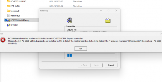

Hello everyone,

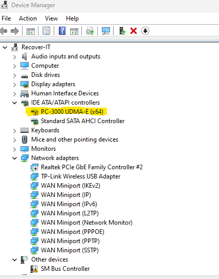

I'm trying to install PC-3000 UDMA unfortunately wasn't successful. The board is setup properly (power supply cable is ok, dioden of the board are lightining) so that it appears in device manager unfortunately with exclamation mark (see attached images).

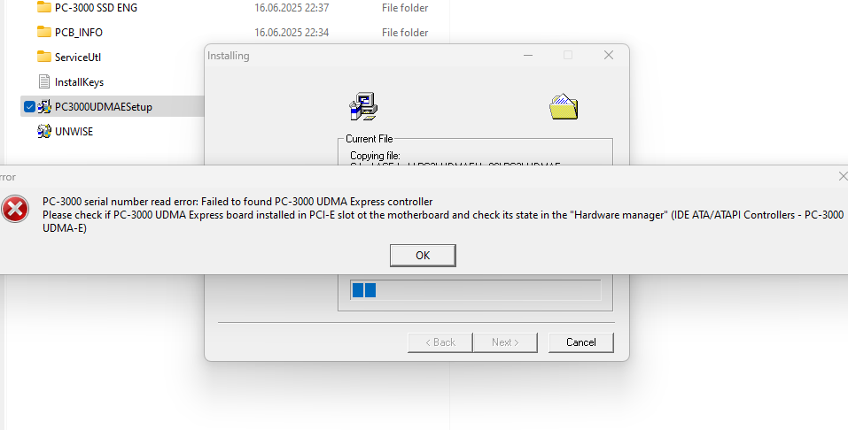

Therefor am not able to run PC3000UDMAESetup.exe, it gave the message the attached to this thread "like I mentioned the board seems installed proberly".
Tried many times to update the driver manually as per UDMA Documentation from folder "\Program Files\Commen Files\ACE Lab\PC3KUDMAE", unfortunately for nothing.
I'm really stuck and gave up, any help please?

Has it been working fine on that computer before?
Maybe check your chipset drivers, as there is also an SM Bus Controller error reported.
Additionally, try resetting the PCIe settings to default in the BIOS.

You've this one with short PCI slot, right?
i've same issue with my mrt when i disconnect all PCI cards and peripherals from the PC to do maintenance.
Then after i reconnect all the peripherals, including the mrt card, it gives me the same problems such as card identification error or incorrect serial number.
This happens especially when i attach MRT card on PCIe x1 slot, this because it is mechanically very instable, but when i connect it to PCIe x16 slot it is much more stable.
Once the card is properly inserted into the PCIe slot (check it by opening pc3k sw), lock it with the screw. Often this is another issue due to poor quality PC cases, this means that pc3k udma/mrt cards may seem a little crooked from the back side of the PC and the screw it will not help (or it can make it worse if you tight hard) because the card would not get aligned properly.
If this happens, you might want considering locking the metal bracket of your pc3k card (all your pcie cards) to your pc case with this type of vertical bracker
instead using the typycal screw that locks the card bracker to pc case.
That black vertical bracker with two screw on top and bottom worked very well for me.
I suggest also to clean you pcie slots and pc3k contacts.

Many thanks @michael chiklis, @digisupport and everyone tried to help. Problem solved
The issue was due to OS. Seemingly the PC-3K may have problem with win 11, once I installed it on Win10 it worked properly.
