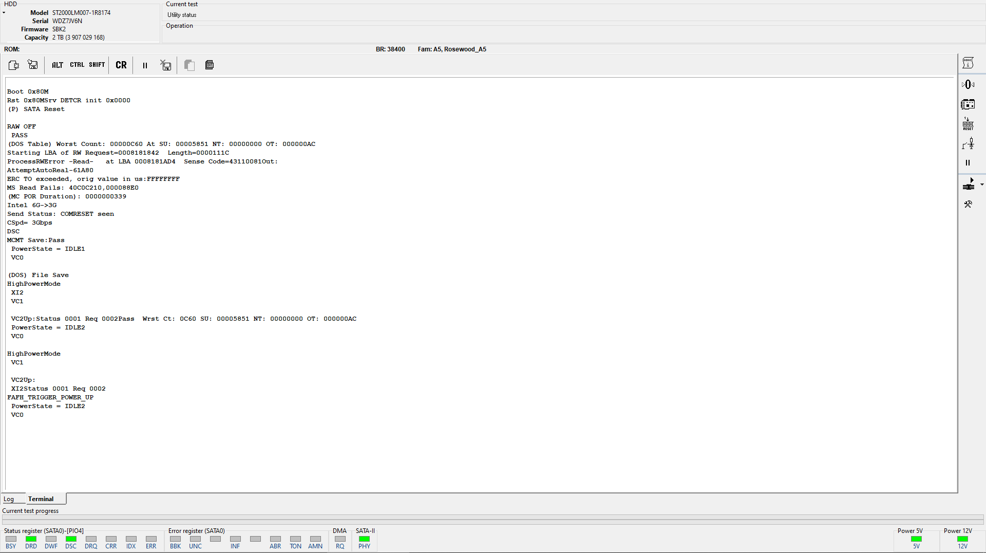

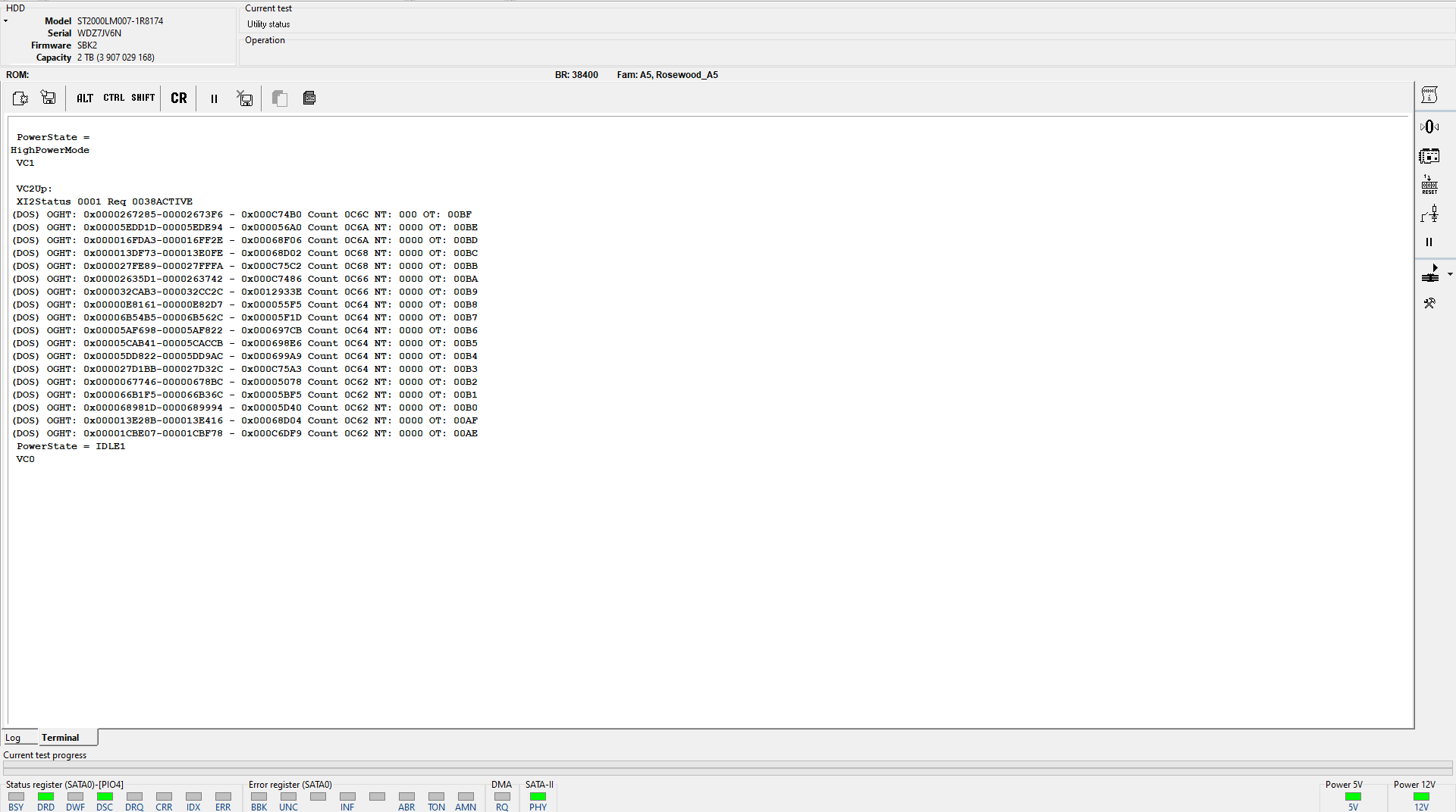

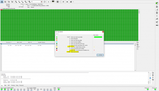

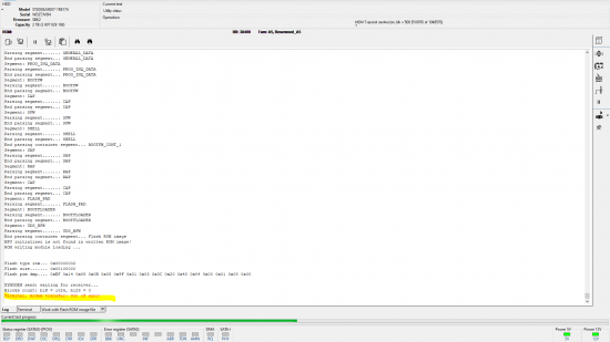

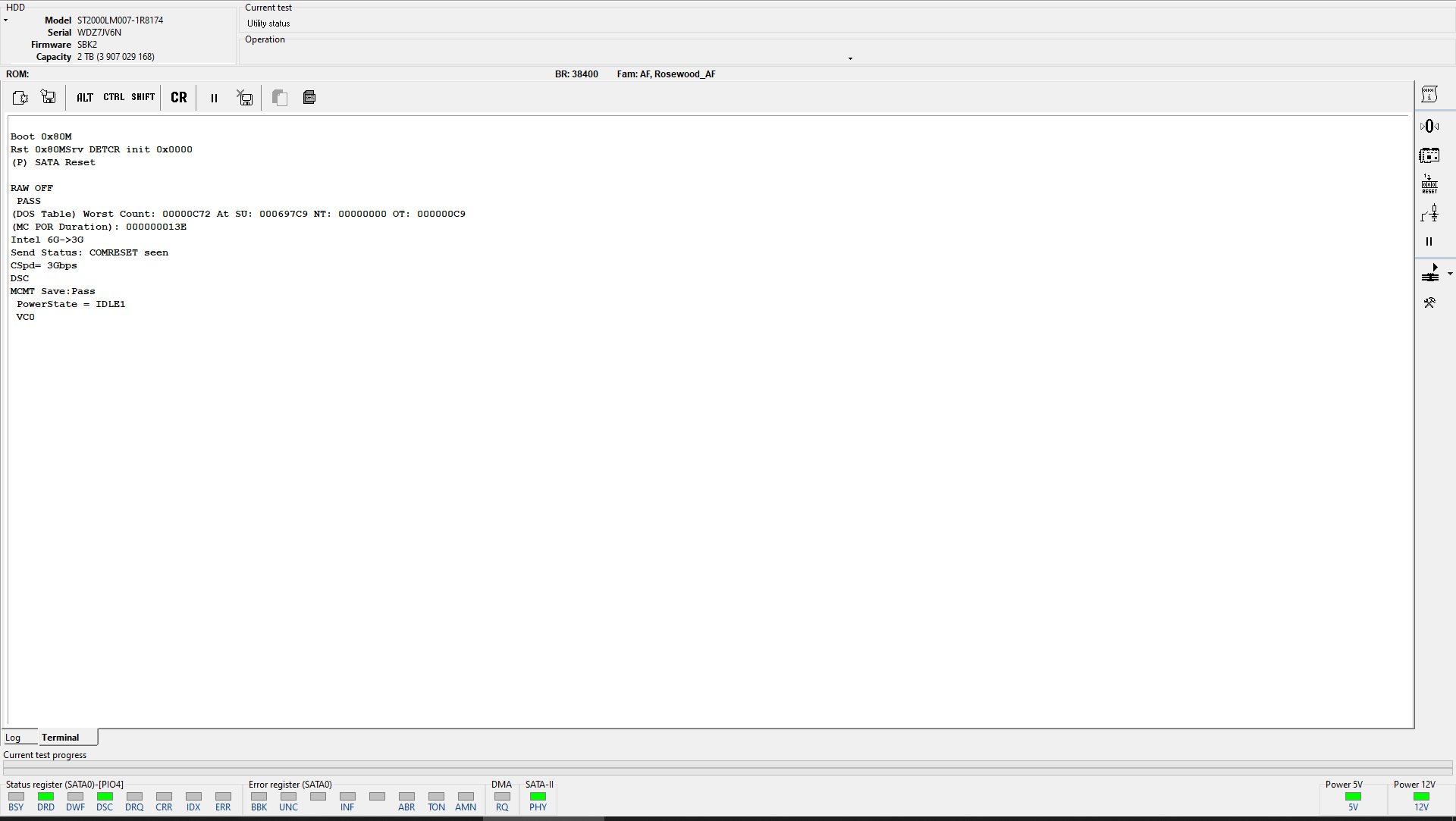

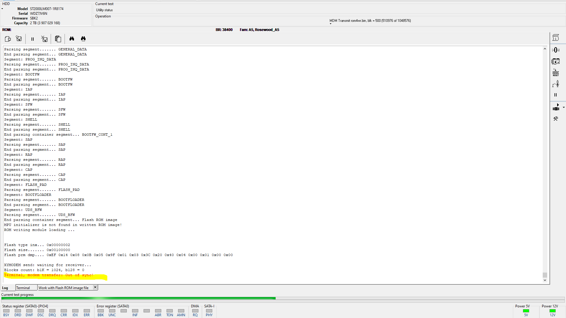

Hello friends.

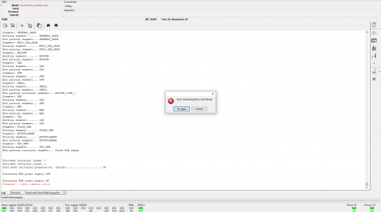

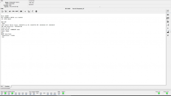

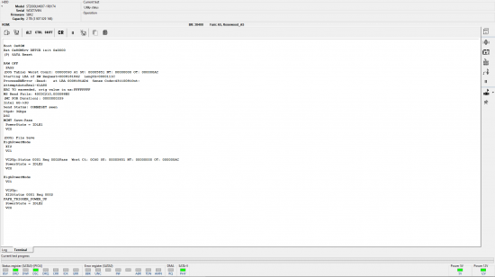

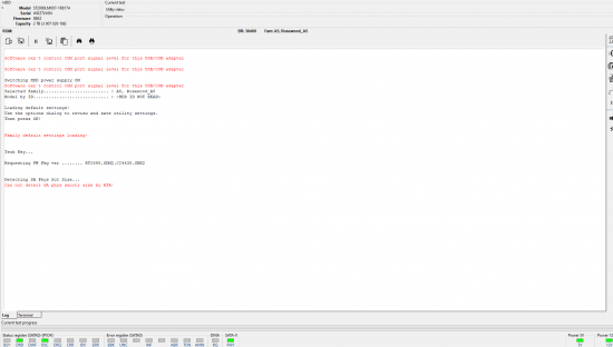

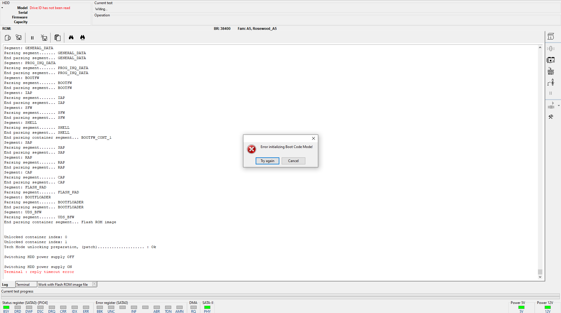

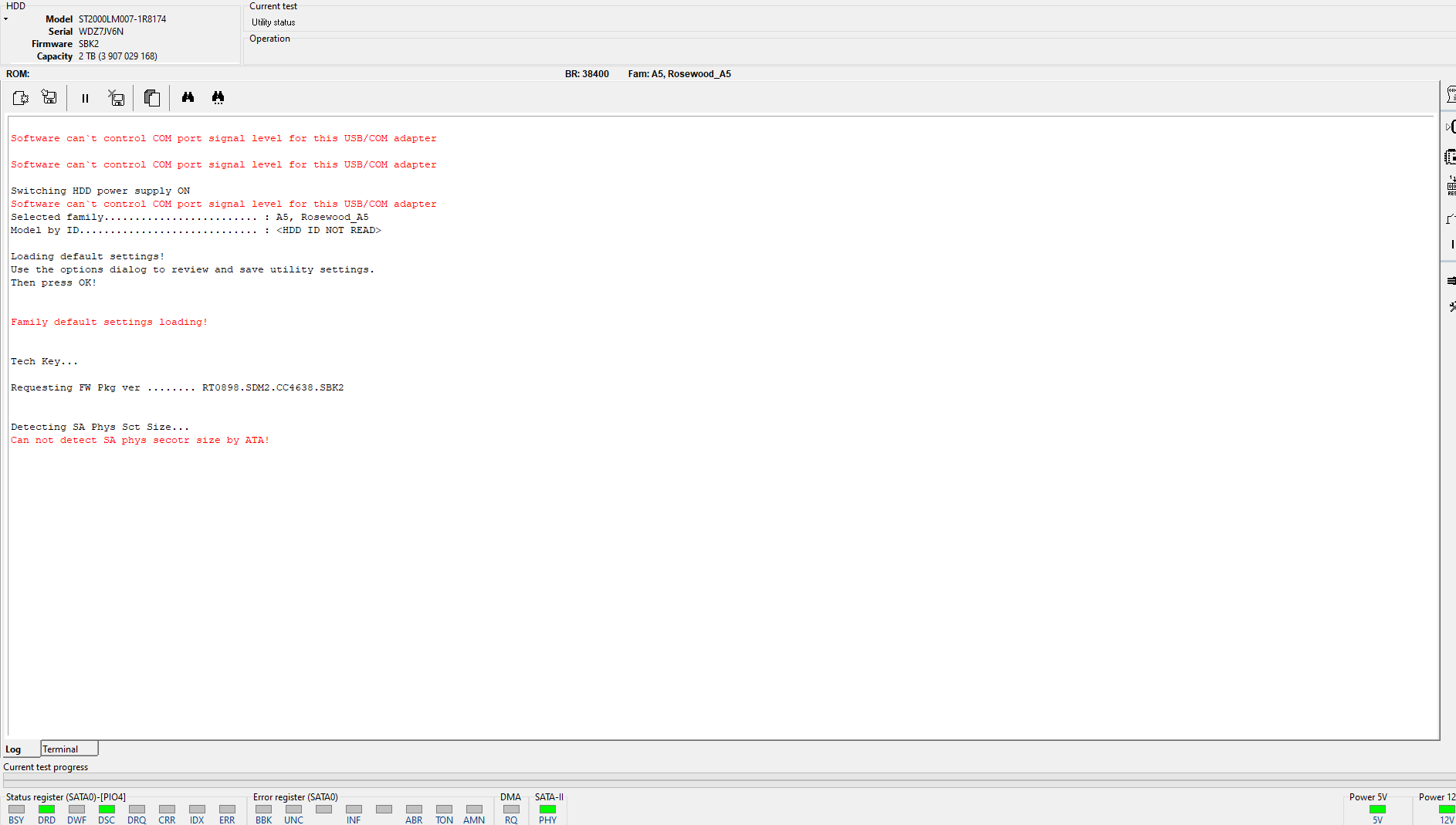

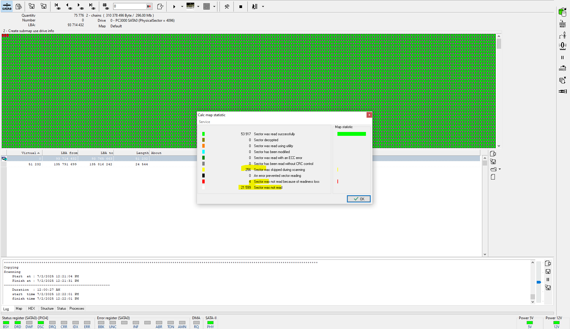

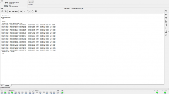

I have this critical rosewood disk. I tried to patch but something went wrong and disk lost detection.
I have somehow restored original rom with great efforts as even that was difficult
I am unable to know what is wrong with disk. I tried DE without patching disk gives sector access but becomes busy afterwards (may be one of the head is weak or failed)
can someone pls. suggest rightful action as I am bit skeptical about next steps.

What message is displayed in the log after trying to unlock the read ROM?
 Post subject: Re: Rosewood AF5 unlocking error
PostPosted: July 31st, 2025, 3:28
Posts: 196
Hi Lucas
Thanks for replying ,there wasn't specific error message displayed , somehow I have managed to recover partial data.
