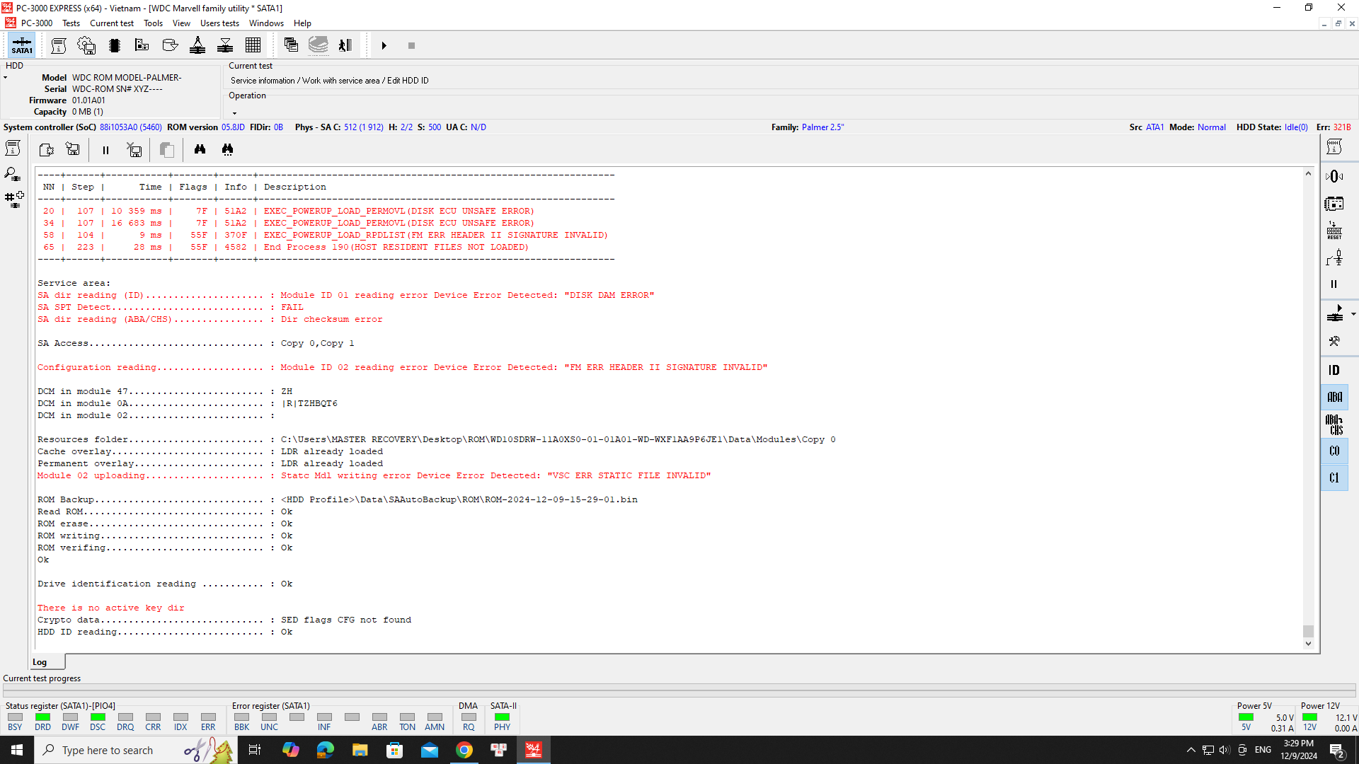

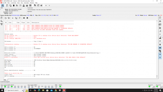

I have an external WD drive with USB connection that got dropped.
I already changed the heads, checked the platters, unlocked PCB and soldered SATA connection to the drive
I tried uploading LDR but
I cannot upload Module 2, cannot reach SA or data. Can anyone help me with this case?? Many thanks!
Drive identification reading ........... : Ok
Family:................................. : Palmer 2.5"
Techno mode key......................... : Ok
HDD Status sector....................... : Ok
RAM:
System controller (SoC)................. : 88i1053A0 0x(5460)
HDD Info reading........................ : Ok
Heads number............................ : 2
Cyl Count............................... : 512
ROM:
Read ROM................................ : Ok
ROM Data size........................... : 1024 Kb
Flash ROM dir reading................... : Ok (Active)
Flash ROM dir reading (Ext)............. : Ok
Modules directory address............... : 0
SA regions address...................... : by default
SA regions address (RAM)................ : by default
Module 02 access........................ : Granted
Zone allocation table................... : HDDs RAM reading error Device Error Detected: "SCT INVALID FUNCTION CODE"
SA SPT.................................. : 500
SA Translator loading................... : Module ID 30 reading error Device Error Detected: "FM ERR HEADER II SIGNATURE INVALID"
ROM Modules:
ROM version............................. : 05.8JD
Module 4F F/W version................... : 0085008J
Overlay F/W version..................... : 05.8KD
Servo F/W version....................... : 04.6B
Heads number in use..................... : 2
Switched off heads...................... : No
Heads map............................... : 0,1
Relocations............................. : 0 (0)
Read ROM DCM............................ : Ok
Power up log reading.................... : Ok
Power up load dir data.................. : Yes
Power up load permovl................... : Yes
Power up load CFG data.................. : No
NN | Step |      Time | Flags | Info | Description
20 |  107 | 10 359 ms |    7F | 51A2 | EXEC_POWERUP_LOAD_PERMOVL(DISK ECU UNSAFE ERROR)
34 |  107 | 16 683 ms |    7F | 51A2 | EXEC_POWERUP_LOAD_PERMOVL(DISK ECU UNSAFE ERROR)
58 |  104 |      9 ms |   55F | 370F | EXEC_POWERUP_LOAD_RPDLIST(FM ERR HEADER II SIGNATURE INVALID)
65 |  223 |     28 ms |   55F | 4582 | End Process 190(HOST RESIDENT FILES NOT LOADED)
Service area:
SA dir reading (ID)..................... : Module ID 01 reading error Device Error Detected: "DISK DAM ERROR"
SA SPT Detect........................... : FAIL
SA dir reading (ABA/CHS)................ : Dir checksum error
SA Access............................... : Copy 0,Copy 1
Configuration reading................... : Module ID 02 reading error Device Error Detected: "FM ERR HEADER II SIGNATURE INVALID"
DCM in module 47........................ : ZH
DCM in module 0A........................ : |R|TZHBQT6
DCM in module 02........................ :
Resources folder........................ : C:\Users\MASTER RECOVERY\Desktop\ROM\WD10SDRW-11A0XS0-01-01A01-WD-WXF1AA9P6JE1\Data\Modules\Copy 0
Cache overlay........................... : LDR already loaded
Permanent overlay....................... : LDR already loaded
Module 02 uploading..................... : Statc Mdl writing error Device Error Detected: "VSC ERR STATIC FILE INVALID"
ROM Backup.............................. : <HDD Profile>\Data\SAAutoBackup\ROM\ROM-2024-12-09-15-29-01.bin
ROM erase............................... : Ok
ROM writing............................. : Ok
ROM verifing............................ : Ok
Ok

gameboybin, Hi, do you from this hdd a good 190er modul? i have excact the same FW
thanks

This is the 2nd time i am having this same issue!
