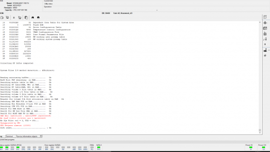

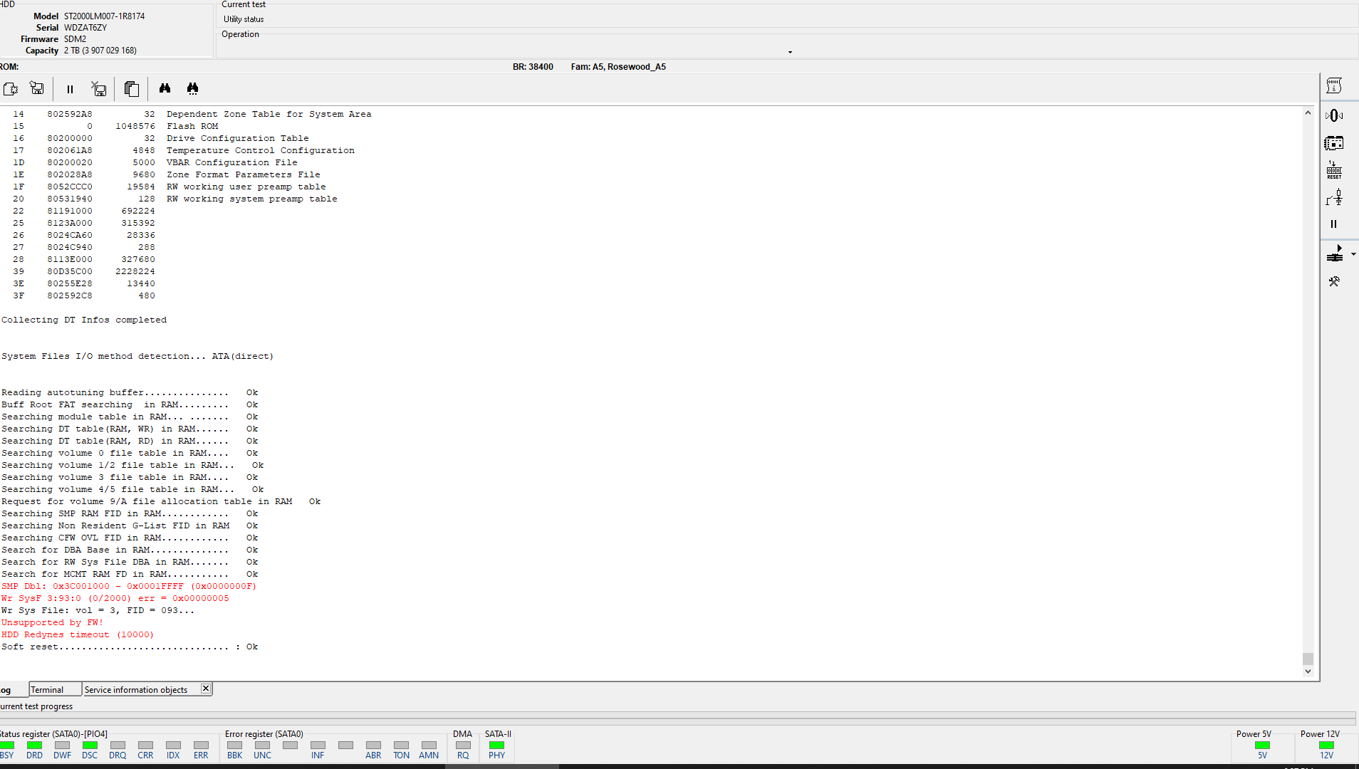

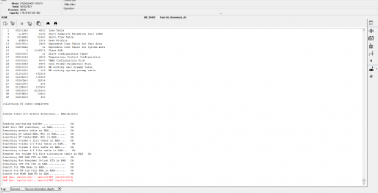

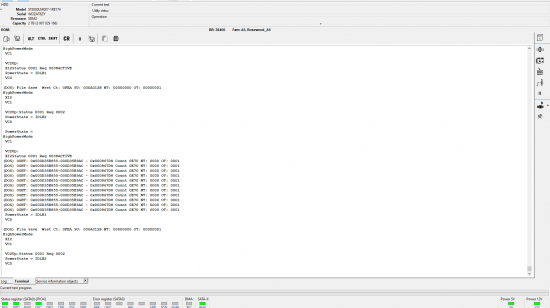

Hi
I am getting errors while clearing SMP flags , can someone pls. help.

You could try issuing the following Case Sensitive commands at Level T.
F"READ_SPARING_ENABLED",0,22
F"WRITE_SPARING_ENABLED",0,22
F"OFFLINE_SPARING_ENABLED",0,22
F"DAR_ENABLED",0,22
F"DISABLE_IDLE_ACTIVITY",1,22
F"BGMS_DISABLE_DATA_REFRESH",1,22
F"ABORT_PREFETCH",1,22
F"READ_LOOKAHEAD_DISABLED_ON_POWER_UP",1,22
F"READ_CACHING_DISABLED_ON_POWER_UP",1,22

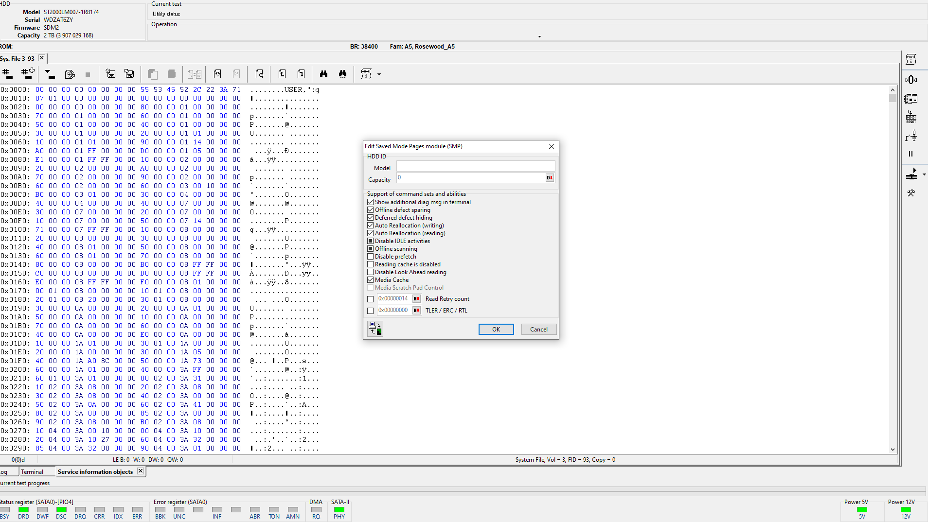

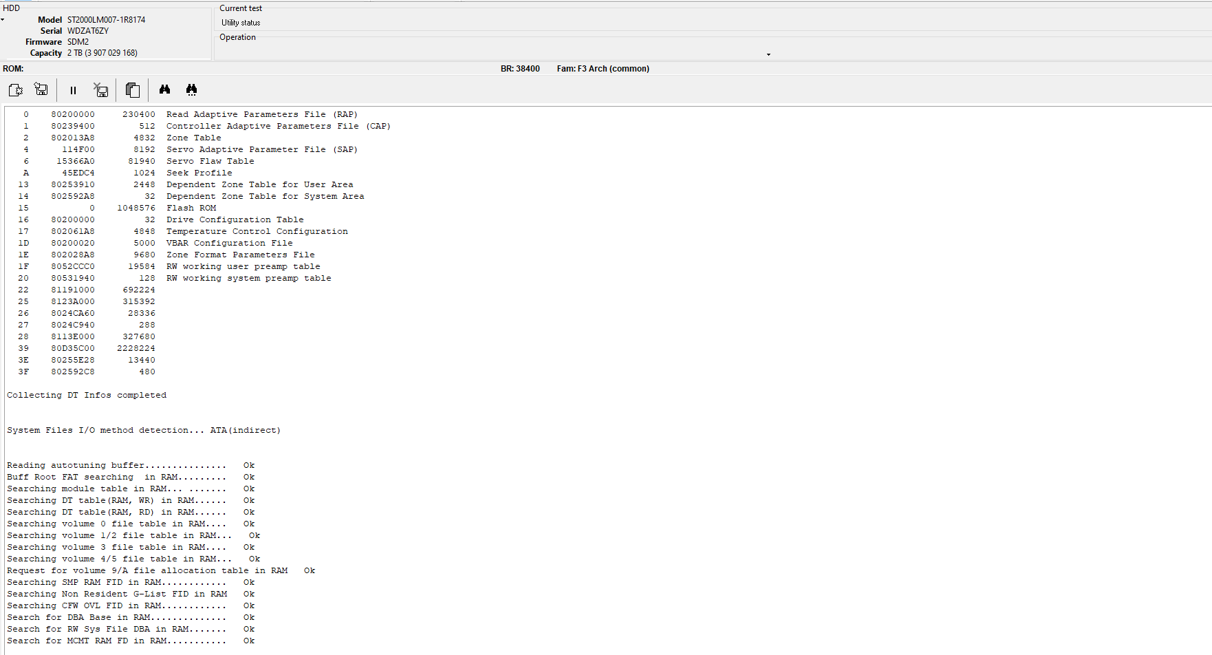

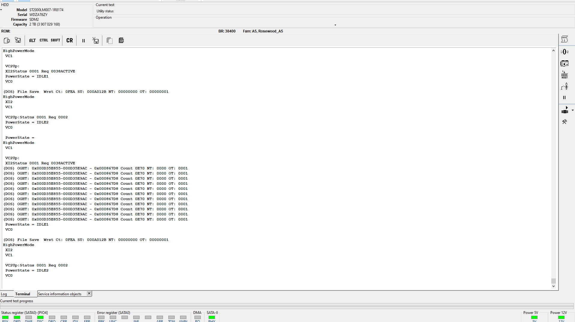

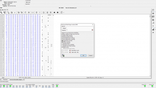

Thanks fzabkar , I am hopeful it will work. :good:[/quote]

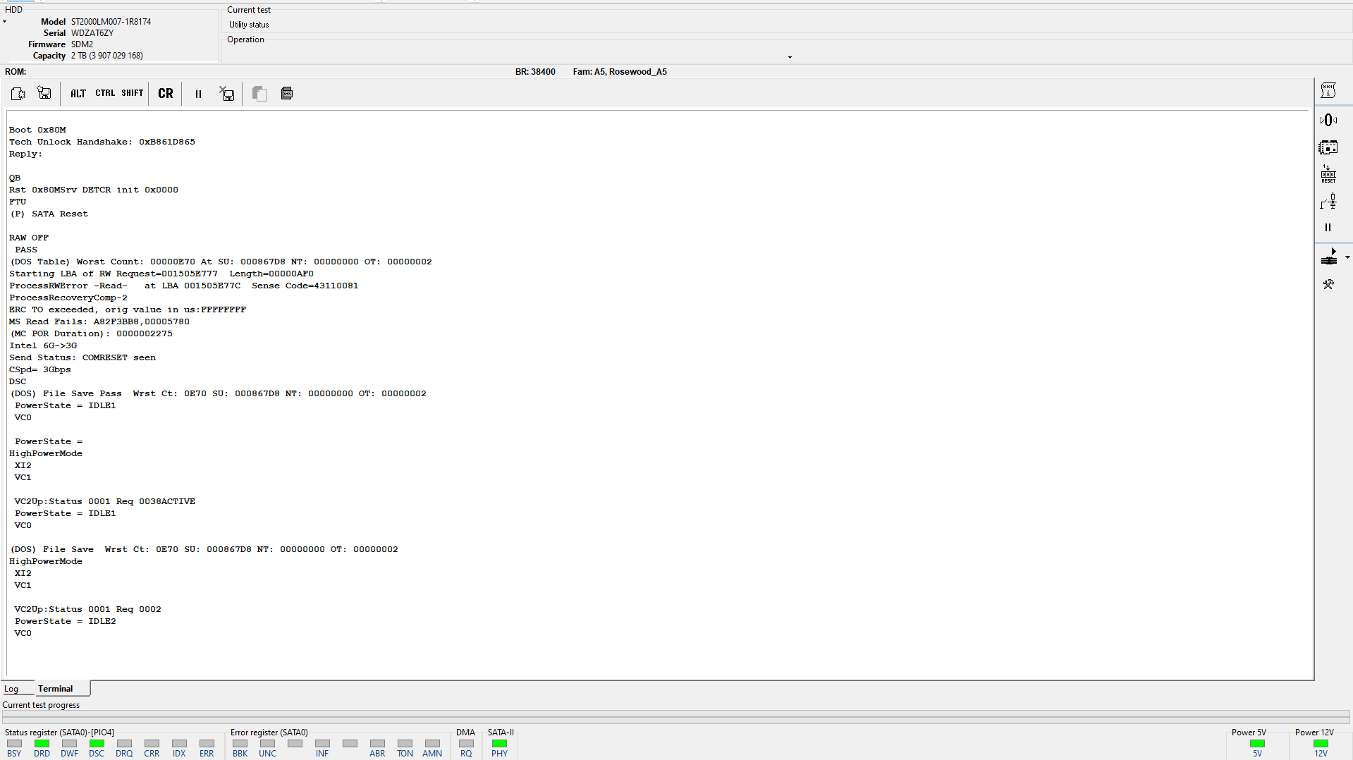

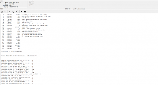

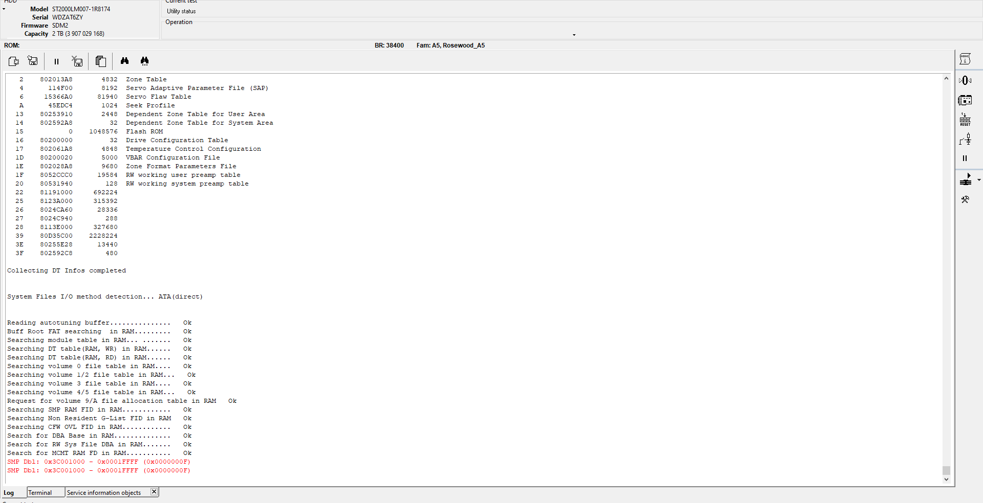

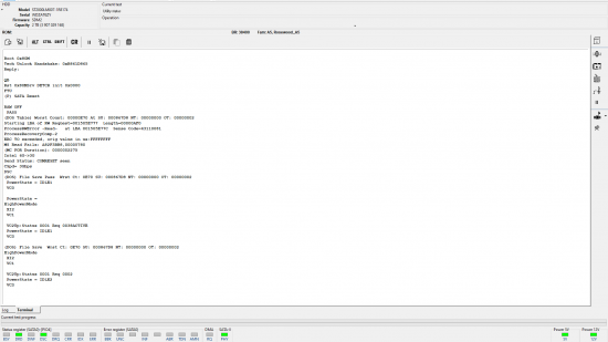

Can these commands make permanent changes or in Ram only , I have given all commands but changes are not reflected in sysfile , drive has same symptoms.

maybe i can't see the obvious, but what symptoms do you mean?
SMPs didn't get changed after issuing those commands. Didn't you apply wr protect patch by any chance?
Thanks a lot pepe
After issuing commands when I try to get sector access disk becomes busy & readyness is lost. Also when I check sysfile 93 all unchecked flags are not actually cleared.
SMP Dbl: 0x3C001000 - 0x0001FFFF (0x0000000F) and MCMT not available error is also displayed

Frustrated with drives behavior I outsourced this case & got a reply that Head 1 is weak & drive is having large TEC sectors , recovery will be partial & will need head transplant
