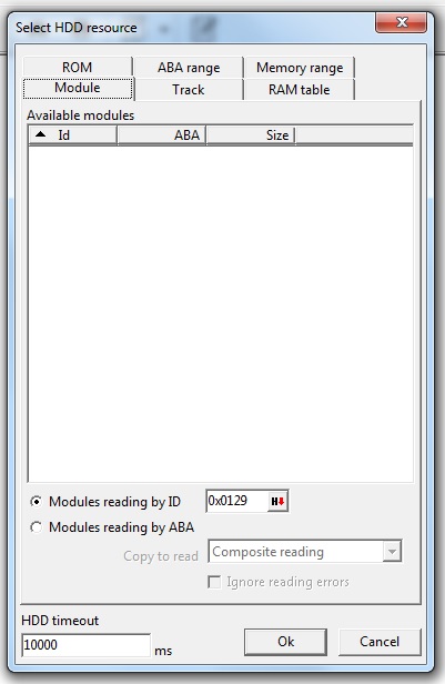

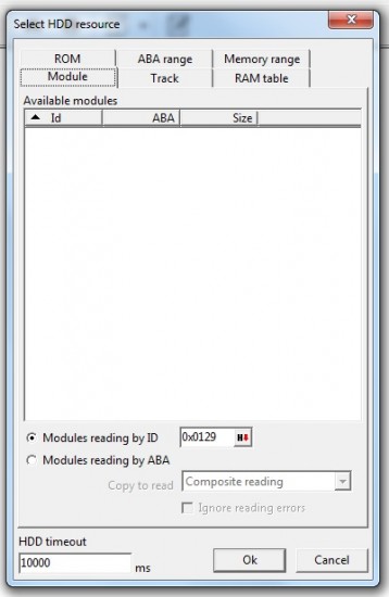

 Post subject: Re: WD palmer damaged rom file data recovery
PostPosted: November 5th, 2025, 13:30
Joined: May 30th, 2005, 17:07
Posts: 550
Modules 129 and 130 are not described in DIR.
These modules are described in ATA Ovl.
These modules can be read by ID.
Ctrl + Alt + 3 -> see photo.
To read these modules, ATA Ovl must be loaded into the memory.
With such limited knowledge, the easiest way is to find a drive with a very similar production date and get the ROM from it.
Mikippp

0000008C  1201 3B25 3200 0000 011A 0080 0000 0000 0000 0000
000000A0  1201 3B2D 2800 0000 011A 0080 0000 0000 0000 0000
000000B4  1201 001A 4000 0000 011A 0080 0000 0000 0000 0000
000000C8  1201 0506 0600 0000 011A 0080 0000 0000 0000 0000
000000DC  1201 0606 0600 0000 011A 0080 0000 0000 0000 0000
000000F0  1202 2901 C800 0000 031A 0000 A02A 0F00 A02A 0F00  <-- 0x129
00000104  1202 3001 C800 0000 031A 0000 682B 0F00 682B 0F00  <-- 0x130
