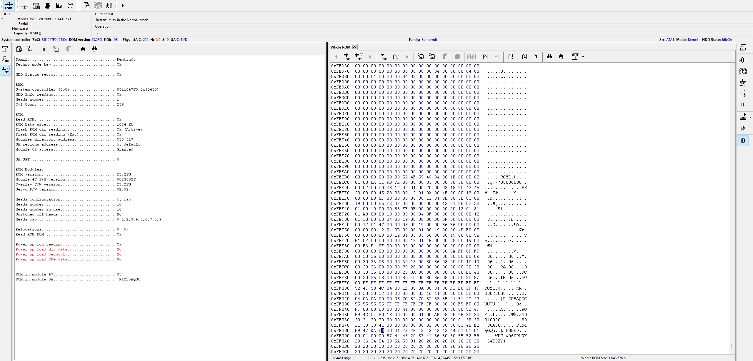

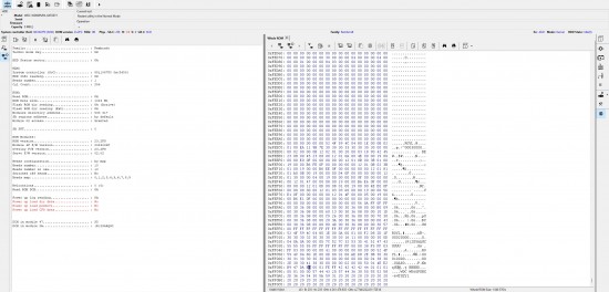

This ROM isn't locked.
What's the problem?
Can you show us the startup logo?
