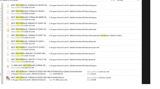

I'm searching for resources (ROM and loader) for WD Sequoia family drive.
WD1600AVBB-63SYA0 is the exact model-name.
My case have a burned PCB (CPU and spindle-motor-chip) and no external ROM. So I can't get it from original PCB.
This model seems to be very rare... I can't find a compatible ROM to get SA-access via loader to read the ROM-copy from SA.
Maybe somebody have resources for this drive?
Many thanks and greetz from Poland, Karol

Did the original preamp survive? Usually when the motor controller and MCU are damaged, this suggests that there was an overvoltage on the 5V input, which in turn puts the preamp at risk.

First, I need the right ROM.

Will any of these do?
Checking the preamp is just as important, starting the drive with a donor pcb and bad preamp puts the data to risk, no matter what rom the pcb is running...
