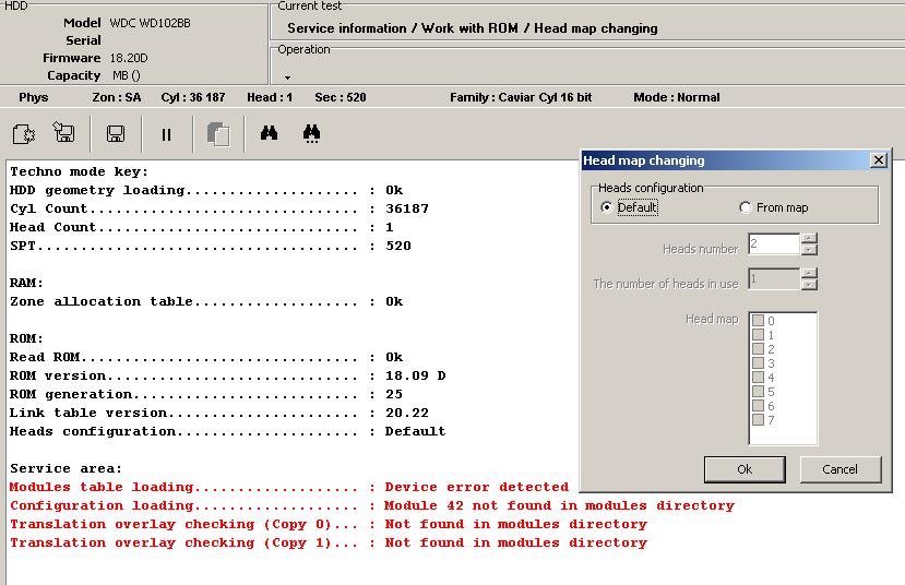

Your head count is 1.
Provide a full model number.
With one head it should be easy to change.
Probably your head is bad and it should not be difficult to change.

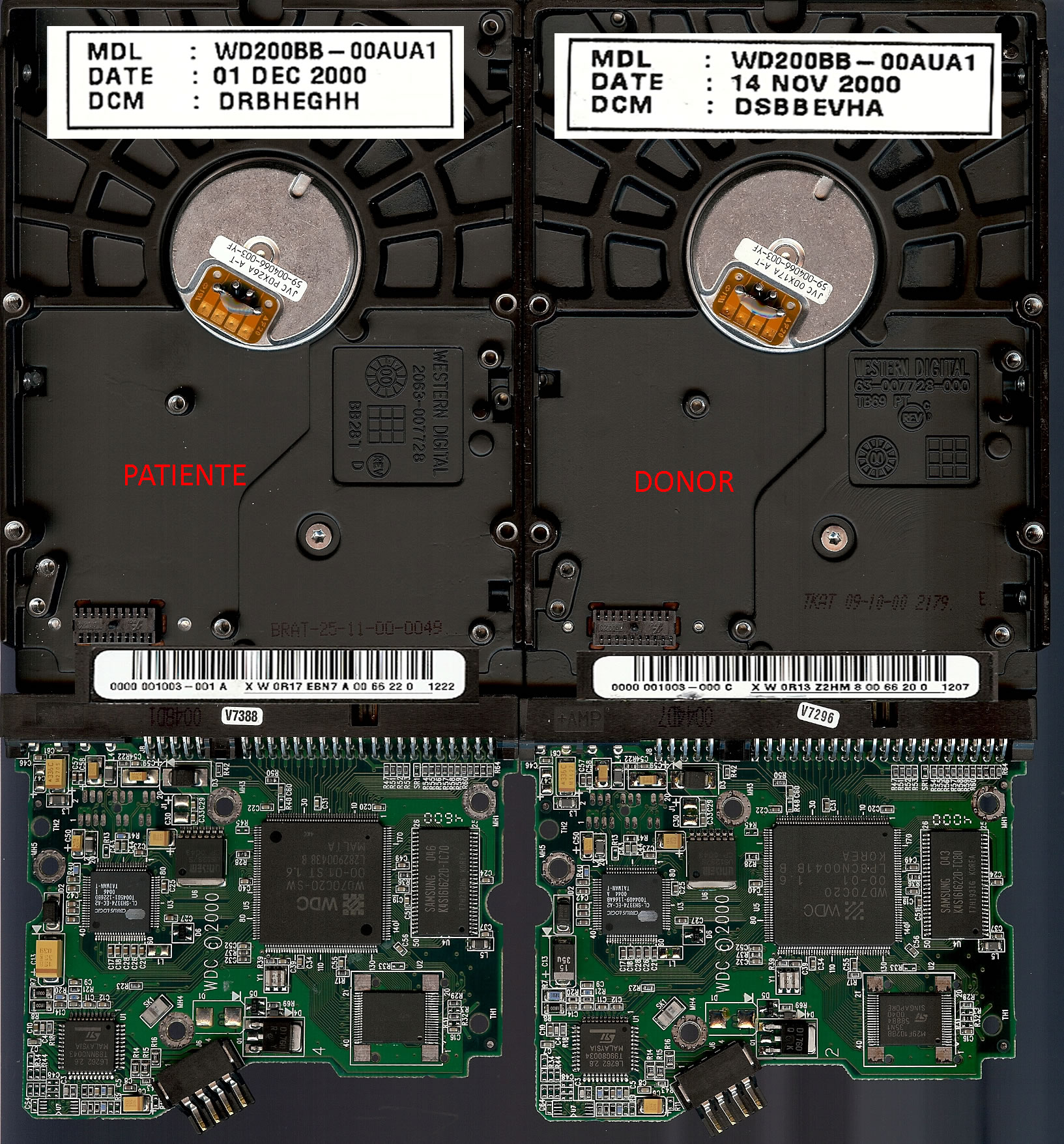

The full model is : WD200BB-00AUA1 01 DEC 2000
PCB:
Patient :0000 001003-001 A
Donor : 0000 001003-000 C
When i enter with the donor disk i have this: ( head map) one head in use, but dont know wich is.

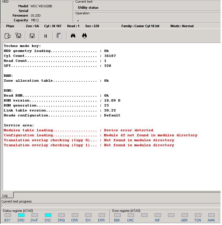

The patient disk with the donor pcb i have this:

All you need to do is download the correct ROM to the donor PCB. Or find a PCB from a drive of the same model number WD200BB-xxAUA1. Your donor PCB is not compatible as it stands.

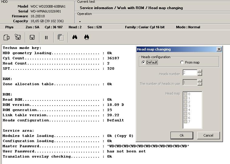

WD200BB-60AUA1

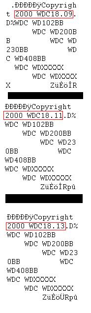

Test all the ROm but did not get the correct size.
The version off the ROM are different
Mikippp, your ROM give-me this
Writing ROM from file................... : <HDD Profile>\Data\ROM\WDC.18.11--ROM_1809D_25_2022_WD200BB-60AUA1.bin
ROM writing error (ROM data checking)
Also i have other ROM in the database with the same error, but it looks like a close match off my disk.
Writing ROM from database............... : /Caviar Cyl 16 bit/WDC WD200BB-00AUA1 18.20D18 WD-WMA6Y1883452/ROM
the version looks like the 18.20D
Any hint here?

need some help here.
i found other donor disk, i try hot swap and it start clicking.
i try the PCB again in the patiente disk and the same problem.
Now the disk that i have found as a donor, it have 15 days different.... it should work .... this model dont have too much adaptive info.
The different that i see from patiente disk, from the donor disk´s that i try in the ROM chip
the patiente disk have the eprom AT27C1024 and the donor disk have the flash M29F102BB
Any comments are welcome.
