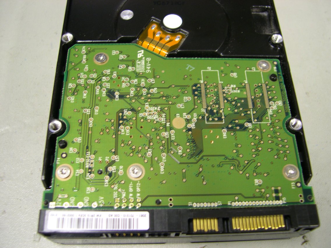

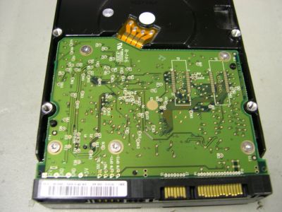

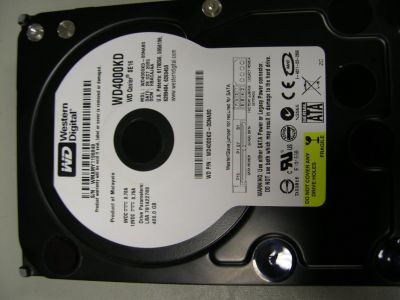

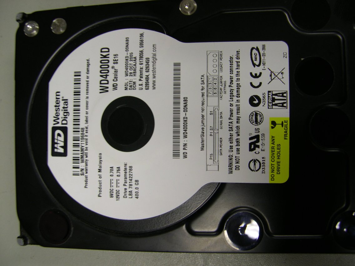

 Post subject: WD4000KD can UDMA unlock this drive?
PostPosted: February 20th, 2008, 21:49
Posts: 1241
Location: inside ROM
WD4000KD can UDMA unlock this drive? I tried and UDMA seems to recognized as Caviar 32 but the functions to check modules and remove password unavailable.
Thank's guys

 Post subject: Re: WD4000KD can UDMA unlock this drive?
PostPosted: February 21st, 2008, 10:03
Posts: 3598
Location: Chicago
the password stored in module 02 if it's Marvell-based HDD or in module 42 for WDC CPU
you can get original password from the module and remove it by standard command

Thanks Doomer, i cant even check modules, they're all empty, probably recognized incorrectly.
PostPosted: February 22nd, 2008, 11:29
Posts: 3598
Location: Chicago
This is Hercules family
This drive has WDC CPU
That means you need to somehow force PC3000 utility to understand that
Another thing if utility is gonna use physical access to SA commands the utility supposed to understand that because physical access commands were changed a little bit for this family
I'm not really familiar with PC3000 utilities but I think the utility is trying to use old style commands I suggest you to ask PC3000 guys for help maybe they can fix utility

Visually it looks the same as the WD5000KS drives. (PCB shape etc) Is it not?
PostPosted: December 14th, 2008, 15:21
Posts: 2288
Location: In ur HDD !
Shape is same but its different .
