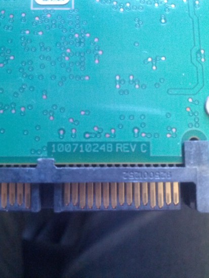

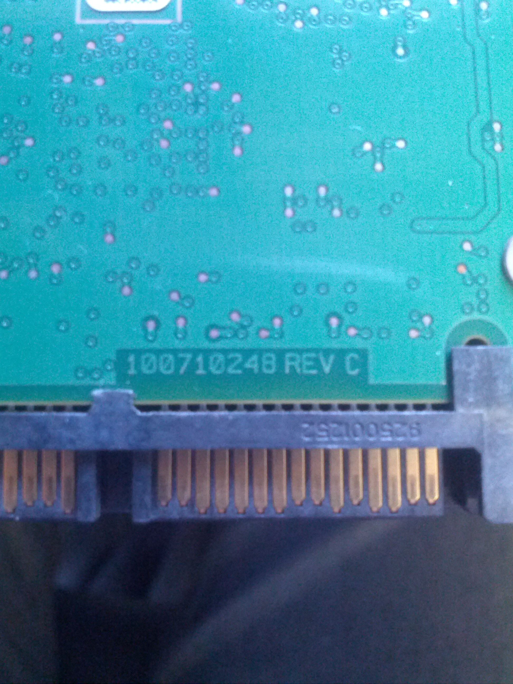

Yes, I'm sure that you can't cold swap. That may work in about 1 out of 100 cases, but it's very rare. You almost always have to transfer the ROM code. As for the number printed on the PCB it is usually in green like you see in this picture:
It is best if the motor control chip matches, however I've found that even if it doesn't it often works if the PCB number is the same. I generally don't physically move any chips over except in rare cases. I just use PC-3000 to read the ROM code and program it to the replacement PCB digitally. However if you don't have any tool capable of this, you can move the ROM chip over (assuming it has one).

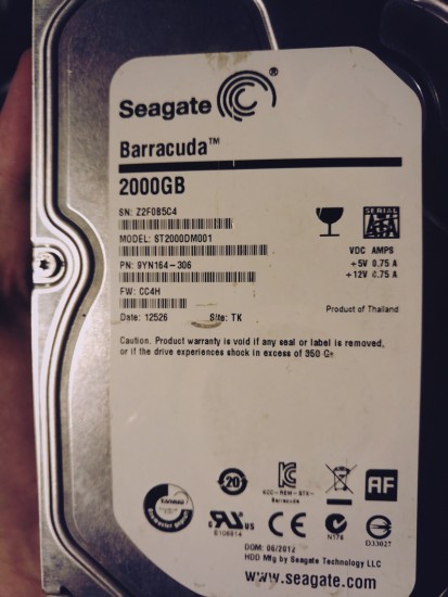

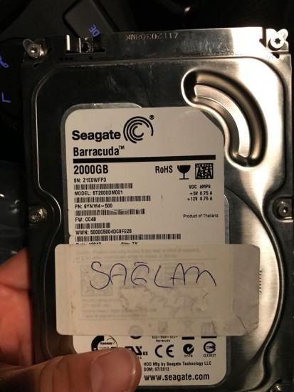

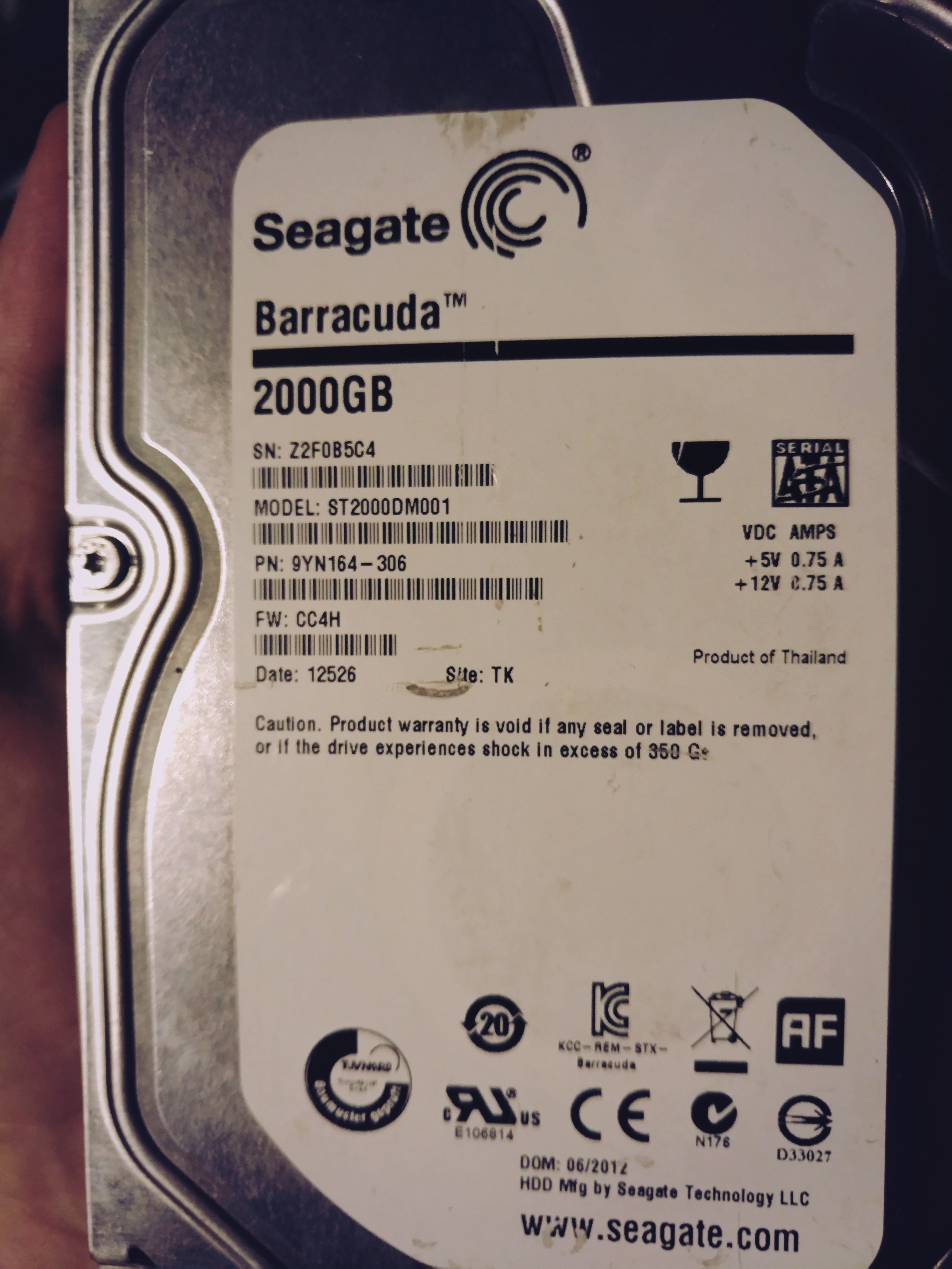

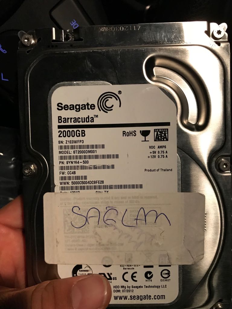

Guys i need help desperately.
I have seagate which model no:ST2000DM001 PN:9YN164-306 is bad head. When power applied head click 10-11 times and power down by itself and bios is not recognised hdd. So i learn i need to replace head a donor drive. I buy a a hdd which same model number and PN:9YN164-500 and open it but WHAT
9YN164-306 : 3 Disc and 5 Head reader (Not working)
9YN164-500: 2 Disc and 4 Head reader (Donor)
So what am i going to do? Which PN i need? All same or what?
Sorry for my bad language and thanks for all help.
