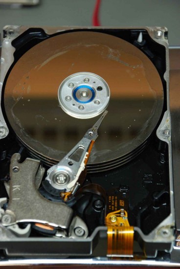

Ok, one photo ;)

June 3rd, 2010, 7:39
interesting how successful was the recovery of this drive how did you clean the other platters
would love to know more
Re: Disk after flood - recovery
June 3rd, 2010, 8:12
No success unfortunately. Heads are gone, massive platter destruction.

sometimes it "May" be better to keep the drive damp before you do any cleaning.

I think the main problem is not the water, but the rough conditions associated with flooding.
I agree with CK, about 60% or so seems reasonable recovery percentage for water damaged Hard Disks

Well, the drive on the picture was a Quantum, so if heads were gone even if media was recovered to acceptable conditions, THIS was the biggest problem.

BlackST wrote:Well, the drive on the picture was a Quantum, so if heads were gone even if media was recovered to acceptable conditions, THIS was the biggest problem.
BlackST has right.
When is clean water it is "quite easy" to recover data, but what about slime?
