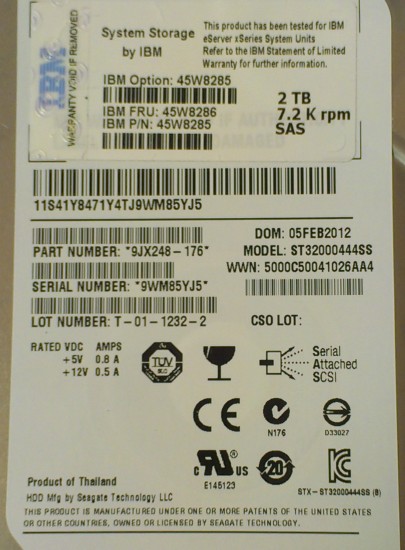

Hello! And I have a similar issue too.

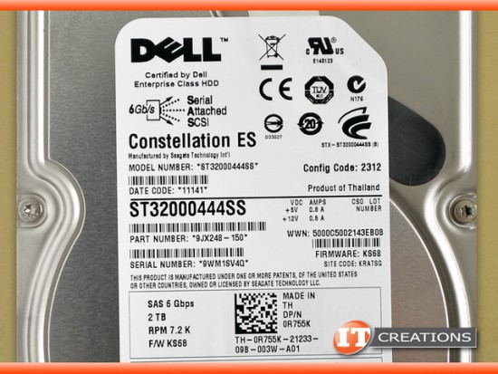

I have several HDDs from IBM System Storage, SEAGATE ST32000444SS and DELL MD3200 Storage. Photo attached.
Dell MD3200 Support Matrix contains this Seagete HDD, but with P/N R755K.
If I put drive into storage, it marks as "Unsupported":
http://en.community.dell.com/support-fo ... 51400.aspx
Is it possible to put DELL firmware into these drives to make them work with MD3200? And does anybody have this firmware here? Please, help.
Thanks!
Should be as this
My disk
