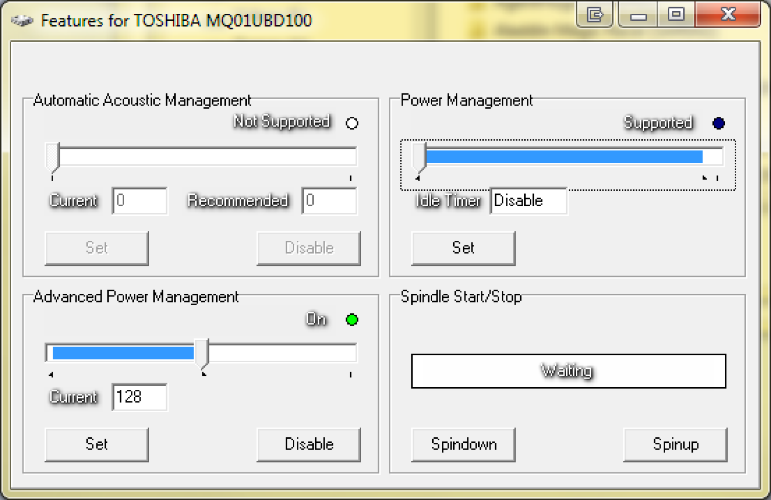

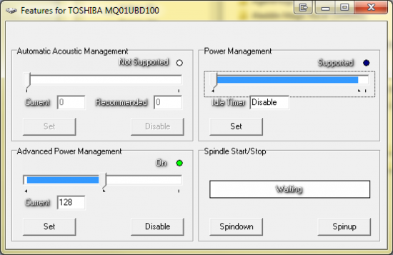

And the IDE Features dialog-box, screenshot enclosed herewith,
Rev 0001 HDDScan v3.1 IDE Features Screenshot (Before Idle)
for each drive shows Automatic Acoustic Management as Not Supported (white circle), with the options and numbers greyed out; Power Management is Supported (navy blue cricle), with the idle timer set all the way to the left at Disable; and Advanced Power Management is set to On (green circle) with the current value set to 128 - the ticker is in the middle. Spindown and Spinup buttons seem fully functional, taking about 2 and 4 seconds to process on average.

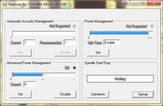

And now the IDE Features for Rev 0001 vary from what was originally stated; Power Management is Not Supported (white circle), though the button is not greyed out, and Advanced Power Management is Off (red circle) with the current value set to 0; screenshot enclosed herewith.
Rev 0001 HDDScan v3.1 IDE Features Screenshot (After Idle)
But, if I then take a large file from Rev 0001 and copy and paste it to one of my local drives, even though the operating light was already on, I suddenly hear the drive spinning-up and the light begins blinking rapidly while the transfer occurs. And if I generate the reports that had moments before produced duds, I now get full reports as I did when the drive was first plugged in, with even the IDE Features dialog-box reporting the original values. Strange, but reproducible exactly as described above.
