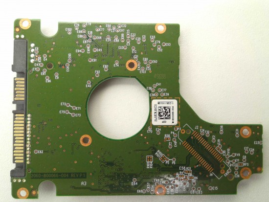

Well, with the Ref. to the prev. post here (DIY Spider Board):
viewtopic.php?f=13&t=38508And here too (Marvell JTAG) :
viewtopic.php?f=13&t=20324&start=80and finally here (The PCB):
viewtopic.php?f=13&t=38331It took me some time to test and verify few things before posting here.
attached here is
ONE of the pins (marked in
RED), the 1st. step to the answer.
(you may find the rest)
How to read it? Which App.? blah blah ...... you need to do your own homework.
good luck

June 23rd, 2019, 7:30
between this point, and another, using resistor you get tiny console?

HaQue wrote:between this point, and another, using resistor you get tiny console?
There is no way to get tiny console with hardware tricks. It is deactivated in MCU code.
AFAIR there is no tiny console on Palmer/Charger drives, it is just not in the code.
JTAG is locked on locked PCBs, unless you have PCB with disable security, finding JTAG pins will be pointless exercise.

if you can short cut those test points correctly. then the drive can enter serial boot mode. the serial mode has 4 sub command ( AA, FF, 70, 72, 2, 5)
70 - get serial baud rate list (min - 115200 ,max - 3125000)
72 - set baud rate
AA - sync
FF - get a ack pack, and set default baud
05 - Go
02 - upload data
for the jtag, you can not find any correctly config file in openOCD.

July 8th, 2019, 2:58
Doomer wrote:HaQue wrote:between this point, and another, using resistor you get tiny console?
Are you sure about that Doomer?
If you have both the Locked & Unlocked PCBs & JTAG pins ..... still pointless??
July 8th, 2019, 9:11
For JTAG to work you'd need PCB with disabled security. Regular PCB has JTAG locked on HW level
July 8th, 2019, 11:53
this mcu use secure boot(Chain of trust). Therefore ,to unlock. must be connecting a logic probe to a PCB track or a package pin

Well , unfortunately I can`t find it either. If you are interested secure boot,you can refer to this url
https://www.cnx-software.com/2016/10/06 ... -s905-soc/https://github.com/ARM-software/arm-trusted-firmwareif want to enable jtag ,can short cut test point (maybe e65 or e67 or e54, because I forgot)

I don`t think so. If can`t switch to uart boot mode, or change this port (0x30420064) value. Then is can`t unlock ....
never
July 10th, 2019, 9:57
flykiller wrote:or change this port (0x30420064) value.
This port reflects HW fuse settings, so it is not easy to change it
As I said unless you have PCB with disabled security, finding JTAG points is useless, UART is locked out too
