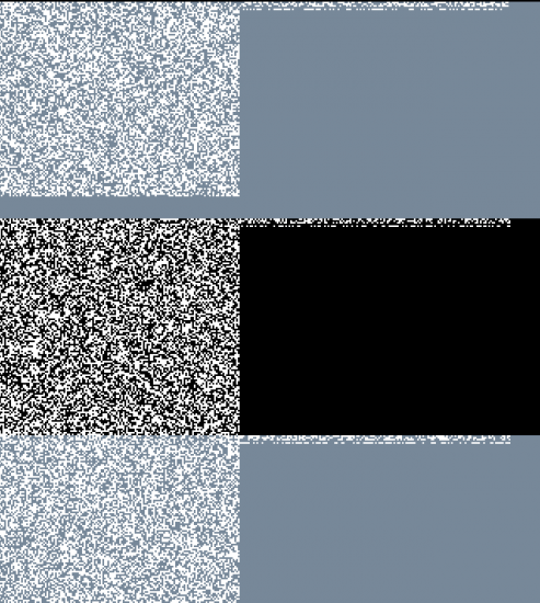

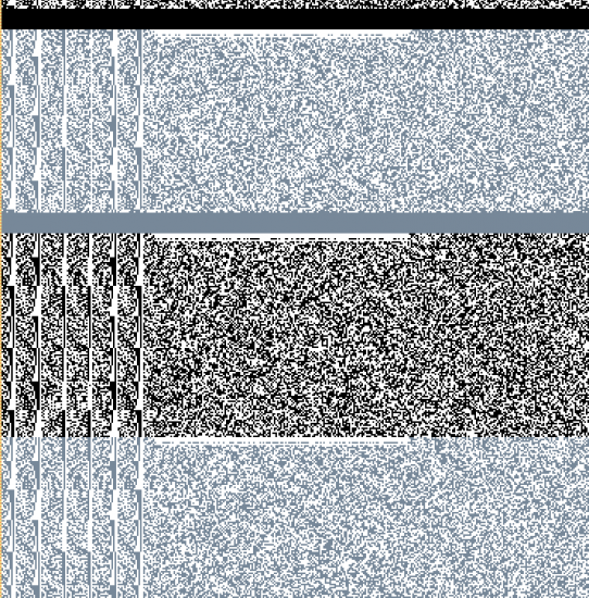

I will also add that Samsung abandoned its controllers in favor of SM in new MicroSD, UFD USB. For some reason in monolith USB they use standard configuration BCH ECC but not in microSD.
In all this chip you can find unxored marker "SMI". I also attach what LFSR looks like and there is no such thing, as far as I know, SM has never used LFSR.

Gregory wrote:SM has never used LFSR.
No, I don't think so. XOR capable of generating regular patterns is inevitably an LFSR, but not being able to see regular patterns in a bit map doesn't necessarily mean it's not an LFSR. It depends on the length of the seed function, the number of bits in the LFSR register, and the position of the tap bit. As long as the controller manufacturer is willing, they can add any secret sauce that can be easily implemented in conventional algorithms, thus producing unexpected effects
