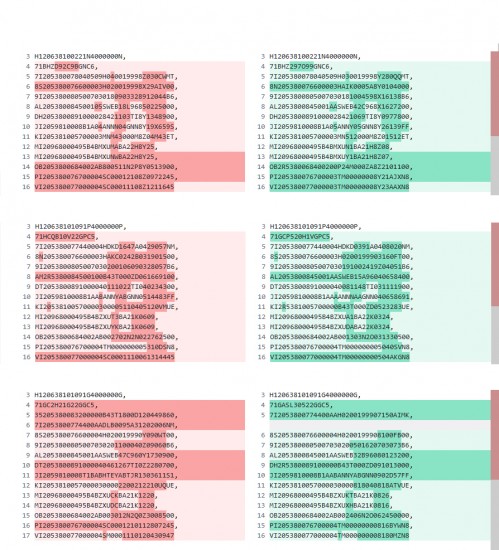

here is how the MCU unique code looks like..
close to figure out the equation with a shortcut to bypass :idea:

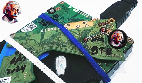

Hello Guys..
Finally WD MCU is really no more... we proudly announce that we are able to bypass WD MCU locked pcbs.
It took me some time to understand the MCU pinout but once you discover one the rest would be much easier to guess.
here is the breakdown results:
1st. there are many ways to bypass the MCU which are:
1- Move MCU from PCb to another --->> which is really not easy.
2- Thanks to my dear friend Mr. Leo Group who discovered a unique way to read he Unique Key and write it back to another PCB --->> not as easy as it looks but can be done
3- My Research which is based on the Chinese PCBs which converts USB to SATA. we have to remove few caps and jump wire few pins from patient to donor pcb
process takes few min. and you are set & ready to go. (probably will be released next year as a commercial bridge pcb by our Team)
The same concept works for 3.5" new WD PCBs which am still working on. WD 2.5" PCB are almost ready.
I advise you guys to think about AI. and try to ask the right questions such as: "inactive mcu pins"
All the best

1st of all
@pclab Thank you :beer:
@pepe
Since you are an expert DR here.. what would you do when you face faulty/broken pcb beyond repair from those locked MCU drives?
"MCU locked means if you write native ROM to donor usb pcb data would be encrypted such as new charger/SpyG2 for example" ---->>@fzabkar
The point of what i did is simply using Native MCU in donor PCB without moving it
