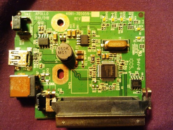

Hey guys, I need some help. I recently purchased a 'My Book Essential Edition 1 TB Hard Drive ( WDBAAF0010HBK)'.
It was working very good till one day i plugged it into my laptop and nothing showed up. No usb connect sound, nothing on my computer, nothing in device manager. I figured something went wrong with the usb port in the hdd. (Cable works fine, i used it with my phone to check). Not caring much about the warranty as DATA WAS PRIORITY. (I can always put it back in the casing. I didn't break it or anything) I thought connecting it via SATA to my desktop would allow me to get my necessary files. The drive inside is a 1TB WD10EADS Caviar Green HD, running smoothly (no clicking sound, very good condition). It doesn't show in my computer and when i go into disk management, it says that the drive needs to be initialized. The same thing happens on any system (windows 7, Ubuntu, OpenSUSE). I've even tried to use a SATA-USB connector wire.
I did NOT initialize as i know this will lead to formatting. Sat to read on this topic and have found out somewhat of bad news.
The USB-SATA connector in the enclosure has a INITIO-INIC-1607E chip. And i've read that it encrypts all data to the hard disk and vice versa.
Now. The data is extremely important to me and I live in a place with no WD support. I work in an IT industry and know what will happen if i give it to the IT people here. They'll try to recover using softwares, which won't work as it's all encrypted.
I read on a few topics that there's a way to solder the SATA connector to the 1607E IC. I cannot find the link anymore, after searching tediously. I am also uploading a picture of the USB-SATA Module.
So, Is there anyway to get my data back through softwares ? like something that can read encrypted data. Or any slight hardware method. Another friend of mine has a WD external drive too. If i replace the USB-SATA module with mine, will I be able to get my data back ?

JMAN You didn't mention the OS version however I am guessing XP or Win7 and NTFS. Sounds like the computer see's the drive which is a good thing since the hardware encryption is difficult if not impossible to overcome. I suspect you have some logical file system corruption and windows can't read the MFT table correctly and thinks nothing is on the disk. You can try r-studio http://www.r-tt.com or one of the other many data recovery programs to scan the drive and attempt to recover the data that way.
 Post subject: Re: USB of external My Book Essential Edition Not working.
PostPosted: March 20th, 2011, 17:41
Posts: 17310
Don't panic. The solution involves an easy DIY repair.
The usual problem, as reported in WD's forums, is a bad connection at the USB connector.
The simplest solution is to resolder the connector, or remove it and reattach it with fine wires, or reattach a larger connector.
http://pinouts.ru/Slots/USB_pinout.shtml
Alternatively, you can just replace the USB-SATA bridge board with one from another external WD drive.

Same boards with same chips , same version (rom and others) are compatible of course.
Angel Data Recovery
PostPosted: April 10th, 2011, 6:00
Posts: 17310
untree wrote:
Is hardware encryption same on all boards? Can you take symwave chip board and use it with drive that had initio board? :?:
A WD user tells me that she swapped Initio bridge boards between two different WD products but the replacement board was unable to decrypt her drive, no doubt due to differences in the Initio firmware.
