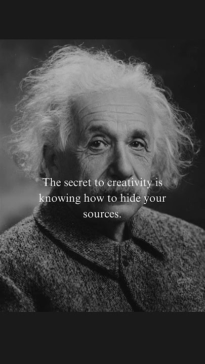

Forum rules
Post new topic Reply to topic  [ 96 posts ]  Go to page Previous  1, 2, 3, 4, 5
 Post subject: Re: WD MCU - No more...
PostPosted: September 5th, 2026, 17:46
Posts: 3590
Location: Chicago
WebClaw wrote:
Original PCB. Original MCU. Normal plaintext baseline. Modified the SA structure being discussed, power cycled, and read the same area again.
=Encrypted
Are you saying that non-original 0x8003 makes all data scrambled?
This sounds impossible. AFAIK is not read by the drive and it's written only externally.
I can check it when I'm back at work but very likely you made a mistake somewhere during the test
 Post subject: Re: WD MCU - No more...
PostPosted: September 5th, 2026, 18:00
Posts: 255
Location: Canada
I can certainly recheck. I'll use Spyglass and the same Charger for comparison.
 Post subject: Re: WD MCU - No more...
PostPosted: September 5th, 2026, 22:08
Posts: 17208
Can you also modify the foreign 0x8003 module by changing the reported SATA capacity to the IDEMA standard? For example, for a 2TB model, change 3906963632 to 3907029168. Then see if the reported capacity does indeed change. If it does, then this will be additional confirmation that the drive makes use of this module.
See https://forum.hddguru.com/viewtopic.php?p=320999#p320999
 Post subject: Re: WD MCU - No more...
PostPosted: September 5th, 2026, 22:24
Posts: 17208
Doomer wrote:
2. On top of that initial SysTick value also need to be exact as it was during original keys generation (not sure how it's achieved).
Could this have something to do with it?
RT-02450 1/31/2019 10:04:28 AM
 Post subject: Re: WD MCU - No more...
PostPosted: September 5th, 2026, 23:44
Posts: 255
Location: Canada
I'll have my re-test tomorrow when I head into the office.
This makes the most sense to me:
MCU-held secret / state + SA-held drive-specific value / state -> correct decryption context
 Post subject: Re: WD MCU - No more...
PostPosted: Yesterday, 4:06
Joined: May 9th, 2024, 14:00
Posts: 7
Location: india
Can you also modify the foreign 0x8003 module by changing the reported SATA capacity to the IDEMA standard? For example, for a 2TB model, change 3906963632 to 3907029168. Then see if the reported capacity does indeed change. If it does, then this will be additional confirmation that the drive makes use of this module.
See https://forum.hddguru.com/viewtopic.php?p=320999#p320999
In module 0x8003,
For Charger it is 3906963632,
while for CaramelR 7200 it is 3907029168,
Charger is self encrypting while CaramelR 7200 is not.
Hope it helps.
MSM DATA RECOVERY
 Post subject: Re: WD MCU - No more...
PostPosted: Yesterday, 4:12
Posts: 17208
The reduced capacity is typical of 2.5" Passport and Elements models. I believe the intent is to prevent the host from accessing the SmartWare encryption key at the end of the user area.
 Post subject: Re: WD MCU - No more...
PostPosted: Yesterday, 12:07
Posts: 3590
Location: Chicago
The reduced capacity is typical of 2.5" Passport and Elements models. I believe the intent is to prevent the host from accessing the SmartWare encryption key at the end of the user area.
it's space for a VCD with unlocking software
 Post subject: Re: WD MCU - No more...
PostPosted: Yesterday, 12:11
Posts: 17208
Doomer wrote:
The reduced capacity is typical of 2.5" Passport and Elements models. I believe the intent is to prevent the host from accessing the SmartWare encryption key at the end of the user area.
it's space for a VCD with unlocking software
I'm fully aware of that, but there is a twist. See my other thread on the subject. Normally, when the bridge is removed, the SATA drive then reverts to its full IDEMA capacity. However, this does not happen in recent USB models.
 Post subject: Re: WD MCU - No more...
PostPosted: Yesterday, 13:00
Joined: May 30th, 2005, 17:07
Posts: 545
Module 8003 is only an information module; it does not store information about disk capacity reduction.
Information about disk capacity reduction is stored in module 02.
Mikippp
 Post subject: Re: WD MCU - No more...
PostPosted: Yesterday, 13:06
Posts: 17208
Mikippp wrote:
Module 8003 is only an information module; it does not store information about disk capacity reduction.
Information about disk capacity reduction is stored in module 02.
Mikippp
Not in this case. See my other thread on this subject. All 5 capacity parameters in module 0x02 reflect the full IDEMA capacity. The SATA drive somehow knows that it was a USB model with a protected VCD area, and it continues to hide this area even after SATA conversion.
As for 0x8003 being an information module, that's what I assumed until @WebClaw's experiment suggested otherwise.
 Post subject: Re: WD MCU - No more...
PostPosted: Yesterday, 13:25
Joined: May 30th, 2005, 17:07
Posts: 545
Capacity reduction works via a switch in module 02.
Simply change 80 to 00 in one place and the full disk capacity will be restored.
Mikippp
 Post subject: Re: WD MCU - No more...
PostPosted: Yesterday, 15:02
Posts: 17208
Mikippp wrote:
Capacity reduction works via a switch in module 02.
Simply change 80 to 00 in one place and the full disk capacity will be restored.
Mikippp
I take that as a challenge. I've narrowed it down to three candidates in three separate sections.
When people convert these drives (Passport) to SATA, are they able to decrypt them with PC3000 by using the key in module 0x25? Or do they need to replace the coupling capacitors and decrypt the data via the USB bridge?
 Post subject: Re: WD MCU - No more...
PostPosted: Today, 2:32
Posts: 2847
Mikippp wrote:
Capacity reduction works via a switch in module 02.
Simply change 80 to 00 in one place and the full disk capacity will be restored.
Mikippp
I take that as a challenge. I've narrowed it down to three candidates in three separate sections.
When people convert these drives (Passport) to SATA, are they able to decrypt them with PC3000 by using the key in module 0x25? Or do they need to replace the coupling capacitors and decrypt the data via the USB bridge?
I told you, you should think about investing in DR,,,
I was away for few days and i saw some good progress, some are moving forward and others are going to the wrong direction.
Just a little final comment here for anyone who thinks am bluffing..
"Send me any healthy drive from those MCU locked families, in addition to the native ROM (hate to waste more time testing) and i will send you here screenshot of what you have inside"
i believe this is the best proof of concept i can do to prove that am not bluffing. (in addition to my fees in advance)
@msmdatarecovery Welcome here, Its good to know someone new here singing the same song well.
AE.jpg [ 64.05 KiB | Viewed 45 times ]
 Post subject: Re: WD MCU - No more...
PostPosted: Today, 5:14
Posts: 17208
einstein9 wrote:
When people convert these drives (Passport) to SATA, are they able to decrypt them with PC3000 by using the key in module 0x25? Or do they need to replace the coupling capacitors and decrypt the data via the USB bridge?
I told you, you should think about investing in DR,,,
Why is even the most basic question treated like an industry-busting trade secret?
As for the quote "the secret to creativity is knowing how to hide your sources", "there is no substantive evidence that Einstein ever made a remark of this type".
https://quoteinvestigator.com/2014/06/01/creative/
In any case, the phrase means that you are telling us that you are not creative. Instead, you are saying that you have appropriated someone else's work and are passing it off as your own.
 Post subject: Re: WD MCU - No more...
PostPosted: 14 minutes ago
Posts: 2847
einstein9 wrote:
When people convert these drives (Passport) to SATA, are they able to decrypt them with PC3000 by using the key in module 0x25? Or do they need to replace the coupling capacitors and decrypt the data via the USB bridge?
I told you, you should think about investing in DR,,,
Why is even the most basic question treated like an industry-busting trade secret?
As for the quote "the secret to creativity is knowing how to hide your sources", "there is no substantive evidence that Einstein ever made a remark of this type".
https://quoteinvestigator.com/2014/06/01/creative/
In any case, the phrase means that you are telling us that you are not creative. Instead, you are saying that you have appropriated someone else's work and are passing it off as your own.
You know me ; I don't waste my time on pointless arguments.
If you were in DR you will understand my research like the others who replied, and it is not my job to explain every single word from what am writing to YOU here.
Post new topic Reply to topic  [ 96 posts ]  Go to page Previous  1, 2, 3, 4, 5
Users browsing this forum: No registered users and 104 guests
