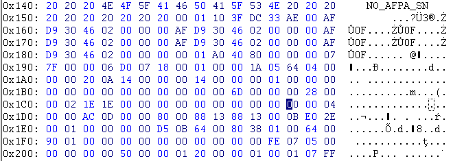

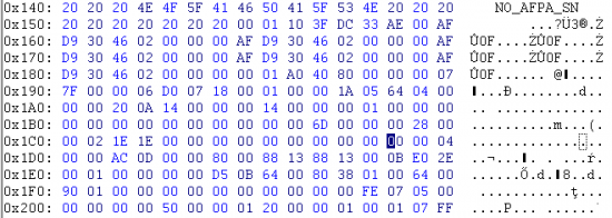

Forum rules
Post new topic Reply to topic  [ 109 posts ]  Go to page Previous  1, 2, 3, 4, 5, 6
 Post subject: Re: WD MCU - No more...
PostPosted: Yesterday, 1:54
Posts: 2848
https://dokumen.pub/qdownload/the-ultimate-quotable-einstein-course-booknbsped-9781400835966.html
Albert Einstein wrote:
Many things which go under my name are badly translated from the German or are invented by other people.
To George Seldes, compiler of The Great Quotations (1960), cited in Kantha, An Einstein Dictionary, 175
https://www.youtube.com/watch?v=QW_YM_cFUNI
 Post subject: Re: WD MCU - No more...
PostPosted: Yesterday, 12:00
Posts: 3592
Location: Chicago
Doomer wrote:
Are you saying that non-original 0x8003 makes all data scrambled?
This sounds impossible. AFAIK is not read by the drive and it's written only externally.
I can check it when I'm back at work but very likely you made a mistake somewhere during the test
I tested it
0x8003 and 0x8028 have no effect on drive's encryption
I took a Spyglass2UL and wrote the modules from a Charger - no effect on drive's encryption or capacity (not a surprise).
 Post subject: Re: WD MCU - No more...
PostPosted: Yesterday, 13:50
Joined: May 30th, 2005, 17:07
Posts: 546
Mikippp wrote:
Capacity reduction works via a switch in module 02.
Simply change 80 to 00 in one place and the full disk capacity will be restored.
Mikippp
Tested on WD50NDZW-11A8JS1
>ROM version............................. : 00.0AA
>ROM F/W version......................... : 0000000A
>Overlay F/W version..................... : 00.0BA
>Servo F/W version....................... : 03.7B
Mikippp
Spyg2ult.png [ 12.82 KiB | Viewed 137 times ]
 Post subject: Re: WD MCU - No more...
PostPosted: Yesterday, 14:14
Posts: 17214
Mikippp wrote:
Mikippp wrote:
Capacity reduction works via a switch in module 02.
Simply change 80 to 00 in one place and the full disk capacity will be restored.
Mikippp
Tested on WD50NDZW-11A8JS1
It's at offset 0x46 in section 3. That was one of my candidates.
mod02dump.7z [3.46 KiB]
Downloaded 4 times
 Post subject: Re: WD MCU - No more...
PostPosted: Yesterday, 14:19
Posts: 4808
without research, merely supposition: when a true SED drive is locked by pw using the wd sw, the bridge must present something to the host for the user to be able to unlock it, and that's the vcd partition. It is likely read from the 'missing' area by the bridge in some way. But this area does not contain any info related to decryption keys, only the sw, most probably. Basically the 'who cares' type of info for me, there are lot more interesting things about these drives...
 Post subject: Re: WD MCU - No more...
PostPosted: Yesterday, 14:40
Posts: 17214
pepe wrote:
without research, merely supposition: when a true SED drive is locked by pw using the wd sw, the bridge must present something to the host for the user to be able to unlock it, and that's the vcd partition. It is likely read from the 'missing' area by the bridge in some way. But this area does not contain any info related to decryption keys, only the sw, most probably. Basically the 'who cares' type of info for me, there are lot more interesting things about these drives...
I now realise that this area is not important for data recovery purposes, but I'm still interested to see what's there. The interesting thing, at least for me, is that the VCD area that is hidden by the bridge is actually larger than the 65536 sectors that are hidden by the SATA HDD.
 Post subject: Re: WD MCU - No more...
PostPosted: Yesterday, 19:46
Posts: 4808
how do you know the size of the VCD area?
 Post subject: Re: WD MCU - No more...
PostPosted: Yesterday, 19:47
Posts: 17214
See my other thread.
 Post subject: Re: WD MCU - No more...
PostPosted: Today, 2:03
Joined: June 25th, 2006, 13:51
Posts: 143
Location: Italy
@einstein9
I suppose you say it is not 1,2,3 because it is required to solder some micro tin wire to some of the MCU I/O pins
and the second part could be setting up the R/W operations
would you like to share the difficulties?
Just in case, thank you in advance
R.
Post new topic Reply to topic  [ 109 posts ]  Go to page Previous  1, 2, 3, 4, 5, 6
