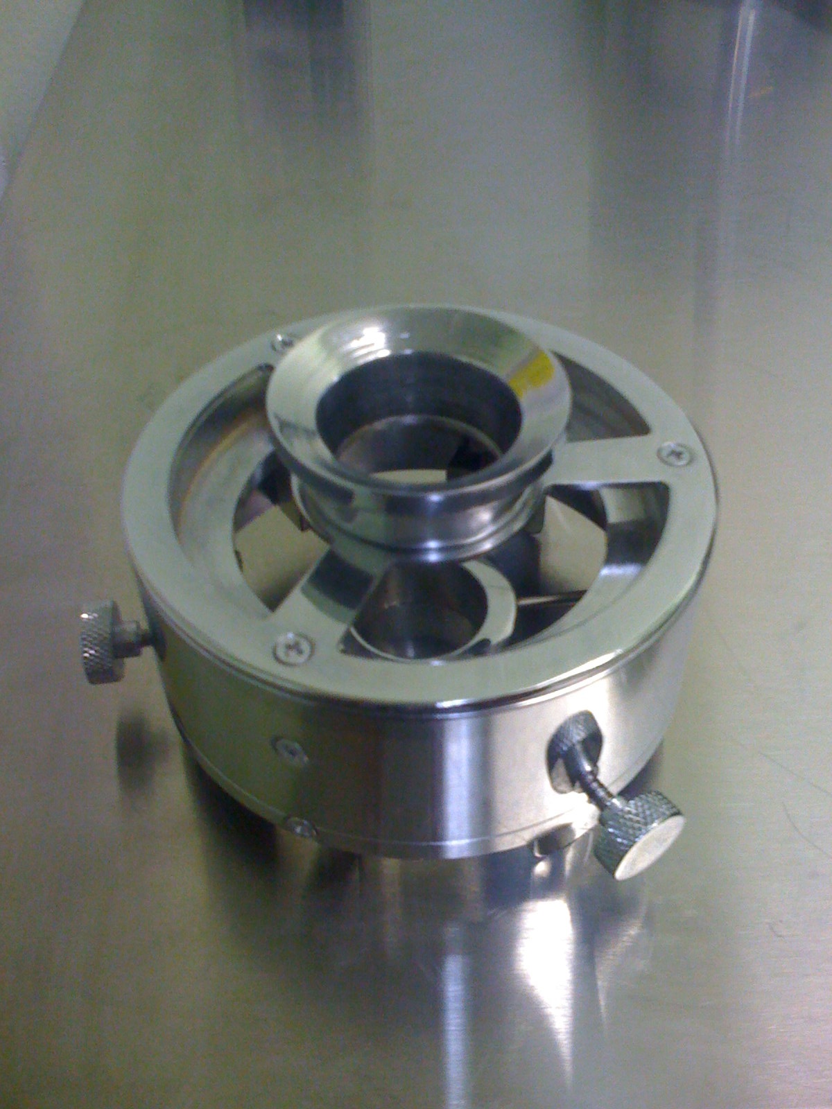

As a self-proclaimed tool junkie, I would say that the new SD tool is quite heavy and appears to be well designed and of superior construction.

Indeed it is, appears very sturdy. Got mine this morning.
However, I'm struggling to get it to grip two platters in a test Seagate well enough to lift them out.
Maybe I'm doing something wrong, I'll persevere.

I also I have my new SD SP,
I have found it has a pretty significant design flaw.
The 3 tabs that are meant to grip the platters are too thick to fit between the HDA case and the platters.
This isn't a problem on all drives, but all of the new drives that we need this to work on do not work.
Specifically Seagate 7200.11 drives
That being said the tool is wonderful on drives where it does fit. It has a VERY sturdy grip and you can practically throw it in the air while holding platters and not worry about losing alignment, or washers sliding about.
Maybe someone from SD can response regarding the thickness of the grips; it seems like something that would not have been overlooked (seeing as this tool is needed on newer drives that are designed like this)
I am guessing reducing the thickness may significantly reduce it's reliability to grip the platters.

I believe if it could fit in between the hda case and the platter then you would not likely have problems with eccentricity.
I am guessing eccentricity is caused by the methods being used not putting enough vertical pressure on the stack of platters causing it too loosen ever so slightely, enough to cause the washers to shift even a small amount. On a high density drive like this even one of the washers moving slightely can cause these eccentricity issues.
As I said on the drives that it does work on the grip was very sturdy, including plenty of vertical pressure to hold the washers in place.
