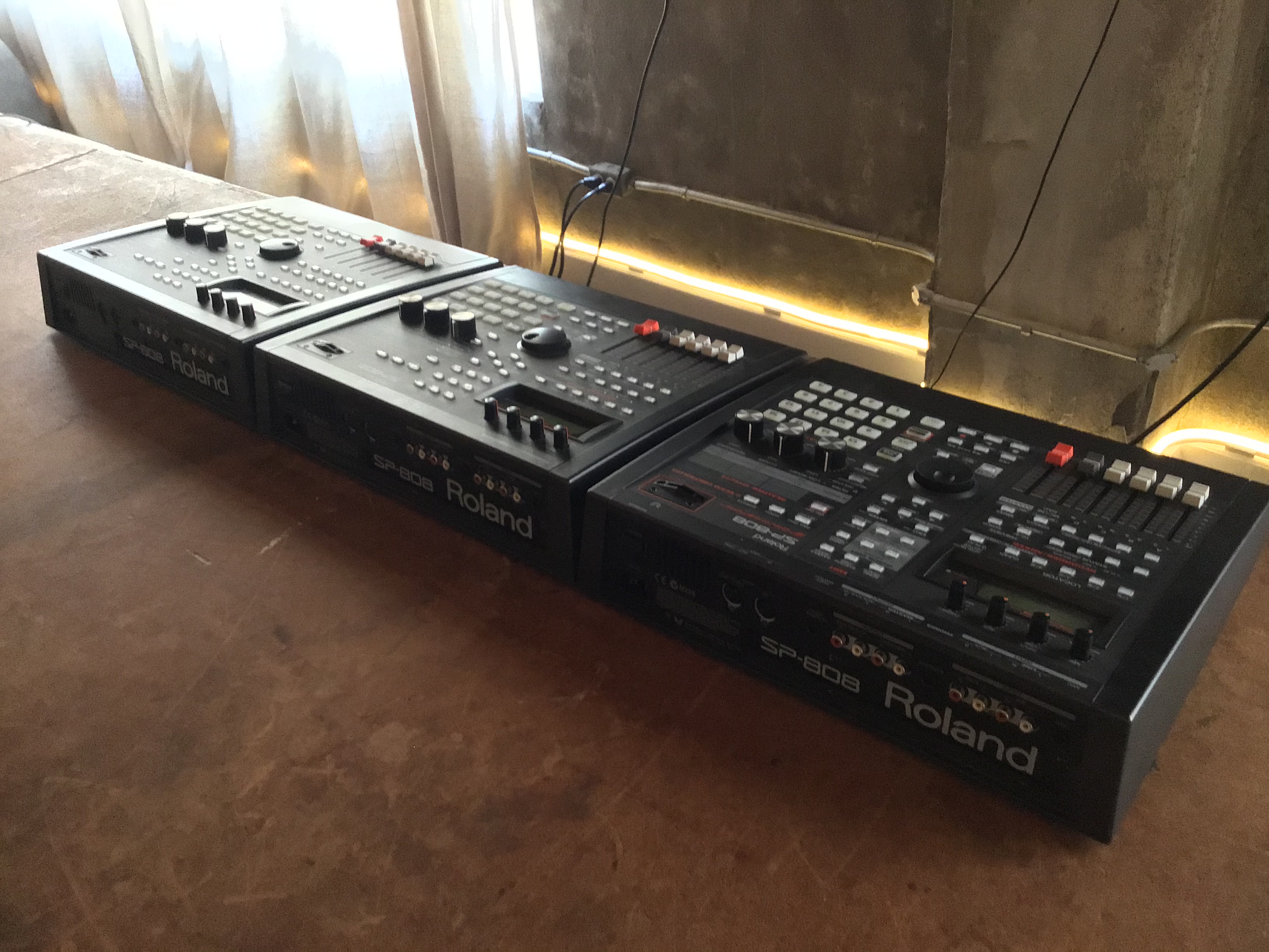

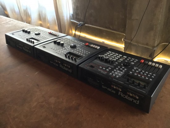

1) Talked to a very nice gentleman on the phone, who works at CPR Tools. He said that their Converter Card is absolutely custom-made for their specific, proprietary devices, and that it absolutely will NOT work in a generic fashion without being hooked up to their devices. He suggested checking StarTech (and I know we've generally ruled that kind of solution out) but I may just check again with them.
2) I ordered the SalvationData converter card from DriveStar. It's on the way from Hong Kong via DHL. A very friendly gentleman at DriveStar told me, via email, that they can get as many of those cards as I want -- so evidently they ARE still in production. I'll do the "ATAPI Resistor/Jumper Change" and give that a shot. (It doesn't look like this solution would support Hot-Swap, although I think the Epson chip it uses does implement that -- I think that's what the "Reset" command does?)
3) Hot-Swap is a moot point for me personally, since my plan is to put a WiFi-enabled 128GB USB Drive inside it. This is a good solution for me since that's 1,280 ZIP100 disks worth, plus I want to be able to run a script that will keep the data synchronized between my 808s anyway -- see attached photo:
I promise to update with what I find out, even if it's "it didn't work at all".
rs
ps - Fun Fact, I was the first known person (in the wild) to put the EX OS on the original SP-808 back in the late 1990s.
