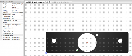

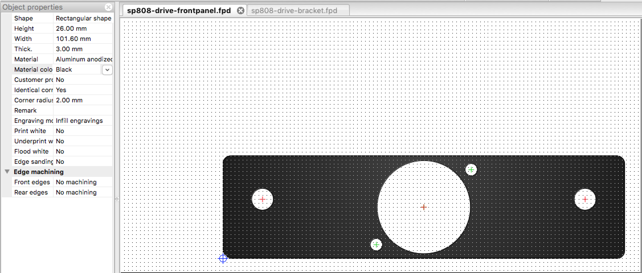

micmic, It was a friendly fellow with a deep voice, correct? He seemed to anticipate my question, though I didn't mention SP-808 by name, just a Legacy ATAPI Host that used a ZIP Drive. But yeah, right off the bat he was certain their card wouldn't work in a generic way.
1) DHL should have my SalvationData board to me by Wednesday, straight from Hong Kong. I expect to have it tested by next weekend.
2) I bought a WiFi-enabled USB thumb-drive to test, but it was too fiddly to just connect to it as an FTP site, which is what I'd want to do so that I could easily synchronize it via command-line. They wanted you to download a special Phone App for it and there were other quirks too. So I decided "regular" USB drives are probably a better choice for this application. However, that means I can't just seal the drive up inside the SP-808 -- I'll need a solution that allows changing the USB drive without disassembly of the unit.
3) Therefore: if the SalvationData card ends up working, I'll release the Front Panel Express files, for the Front Face I made for the SP-808 drive slot. It is designed to use a professional-grade Neutrik NAUSB panel-mount socket. I will release it along with documentation of the entire process and a BOM, all probably as part of a Github. The SP-808 has a metal "caddy" inside, which screws to the main chassis. This caddy is entirely separate from the housing of the ZIP Drive -- so once the Drive is removed, the caddy fully remains, and can be reused to mount another solution in fine style.
(The bracket I designed is "industrial grade", and runs in the $65 range shipped -- so certainly there are cheaper mounting solutions possible. I'll leave the exercise of determining those solutions to the reader.) (:
rs

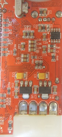

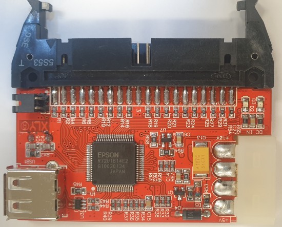

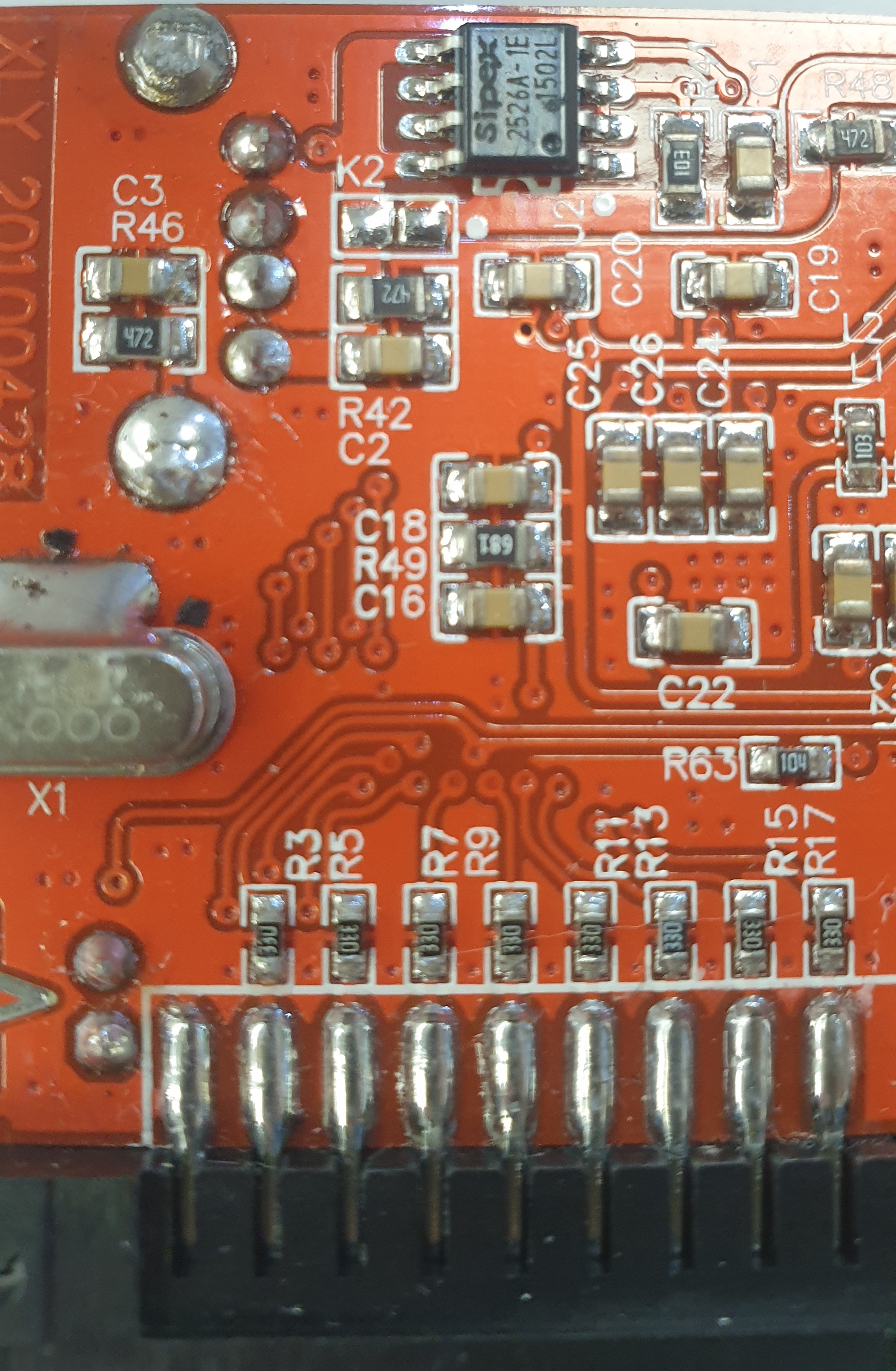

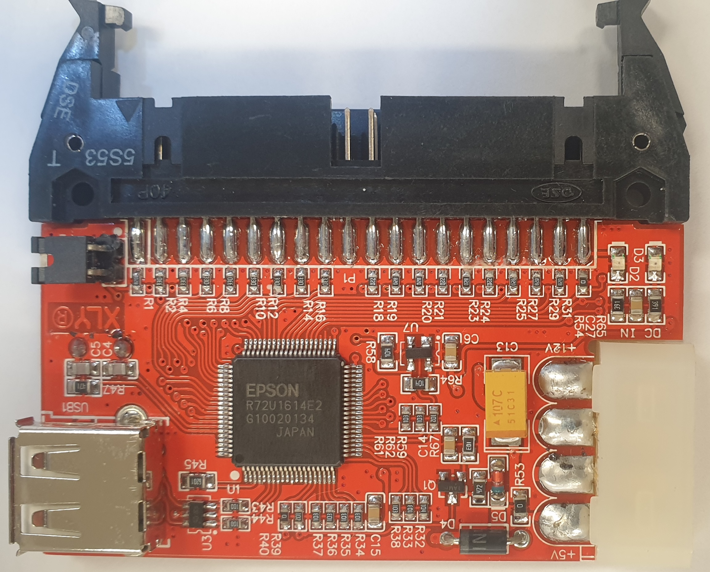

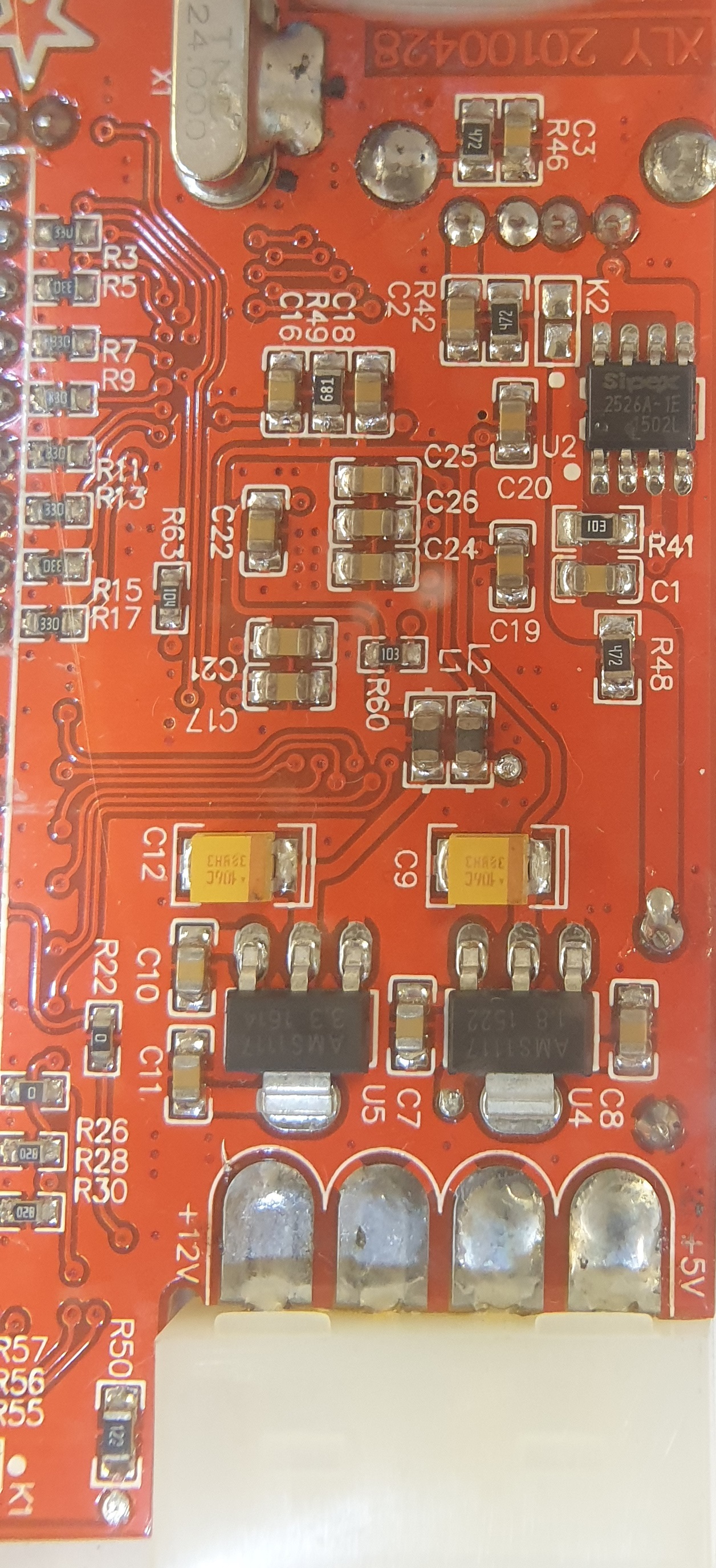

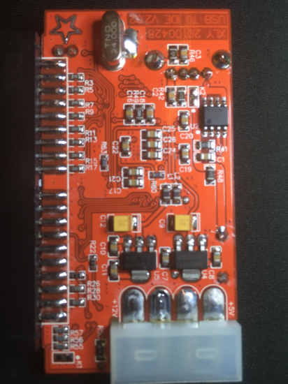

@fzabkar, see attached. My phone does not take great pics, sadly. I can't make out that the markings on that IC -- I ordered a 5x magnifier light which should arrive Wednesday and I can try to make out the markings then. Otherwise you say having it Scanned is a good method?
Update: I have installed the SalvationData board (in default mode, which is presumably IDE) and the SP-808 powers on, and both Status Lights on the SalvationData board illuminate, meaning it is at least getting power. The initial "Roland SP-808" screen appears, and then after exactly 20-seconds (which is the time within which it would normally be reading from the ZIP) it goes to the "Groove Sampler" screen, which is the second part of the intro sequence. Next, the screen reads "Please Insert Zip Disk" but inserting/removing a USB drive does not do anything.
Other variants I tried: Booting both with a USB Drive inserted and without one inserted, and booting with the Jumper J2 (which is the jumper on the corner of the board next to the USB socket) both in (default) and out. (I assume this is Master/Slave?) No change in behavior.
Next steps: Perform the IDE->ATAPI mod on the board by lifting the 10K resistor R60 (thanks @fzabkar for this tip a few pages back!). I will probably wait at-least until Wednesday night to try this, since that's when my Magnifier arrives, and I want to be extra-careful...
More as it comes, rs

I scan my HDD PCBs with a CCD scanner (not CIS) in 1200dpi resolution. It produces much better results than most cameras. CIS scanners are not suitable for this.

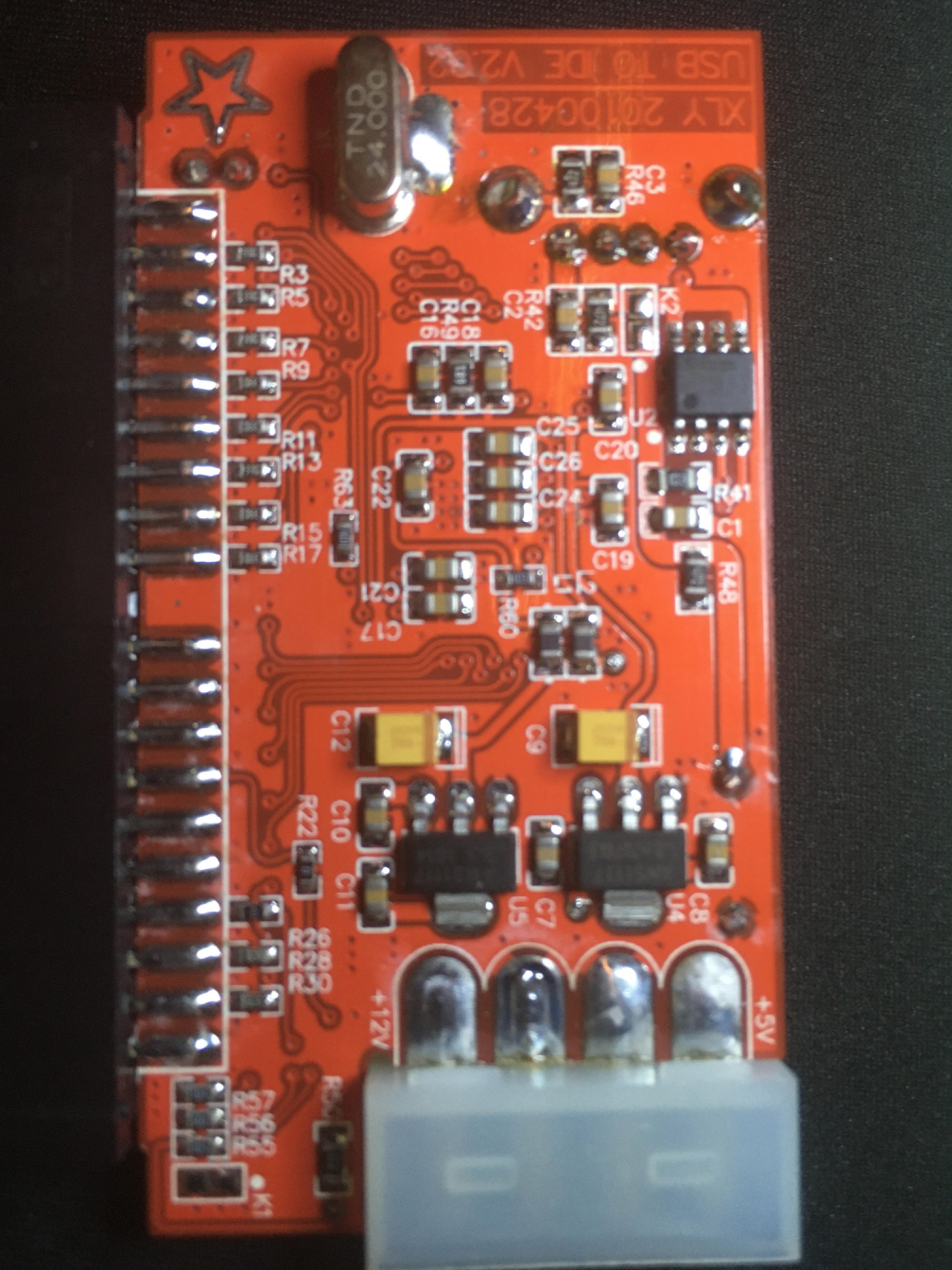

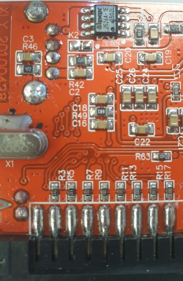

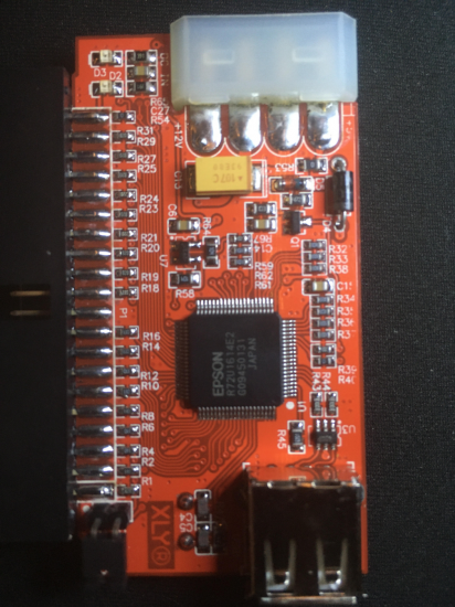

tip for great photos with a phone:
use a desk lamp or some kind of light to shine at the wall, a corner where both walls are white is ideal.
Put the subject close to the wall and manouvre it around until the writing on the chips show up well.
Change angles with the subject and the phone until you get a desired result.
Dont zoom in with phone controls, wait until you get a good pic and you can zoom in on the PC (or phone gallery).
play around and you will get great pictures.
 Post subject: Re: Sniffing control flow between legacy devices over PATA/A
PostPosted: September 1st, 2020, 2:58
Posts: 4001
Further to this,
crop out the unwanted area/background. This is good to reduce bandwith of upload and to help out people with slow connections. Yes they still exist, 1MB pic can be annoying for people. high res of course you wil have to make that sacrifice.

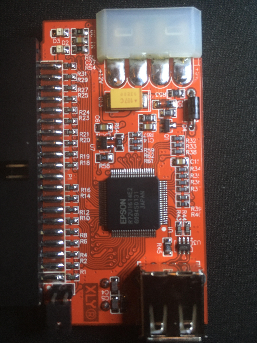

here is some I took on my Samsung 9+, just using a LED lit magnifying glass to shine some light where needed. You kinda need 3 hands for this!
If taking a pic on the phone and you want to remove EXIF data, win 10 has a handy feature. right-click picure and choose properties, then the details tab. down the bottom, click the link to create a copy that removes all personal info. You can also choose what properties to keep if you like.
I coupld probably read this Eeprom if required.

To reconfigure the PCB for ATAPI mode, you need to remove resistor R60 and connect a leaded resistor with a similar resistance between TP26 and a nearby ground point.

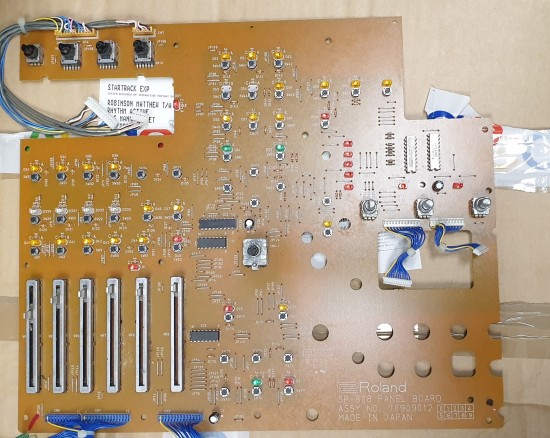

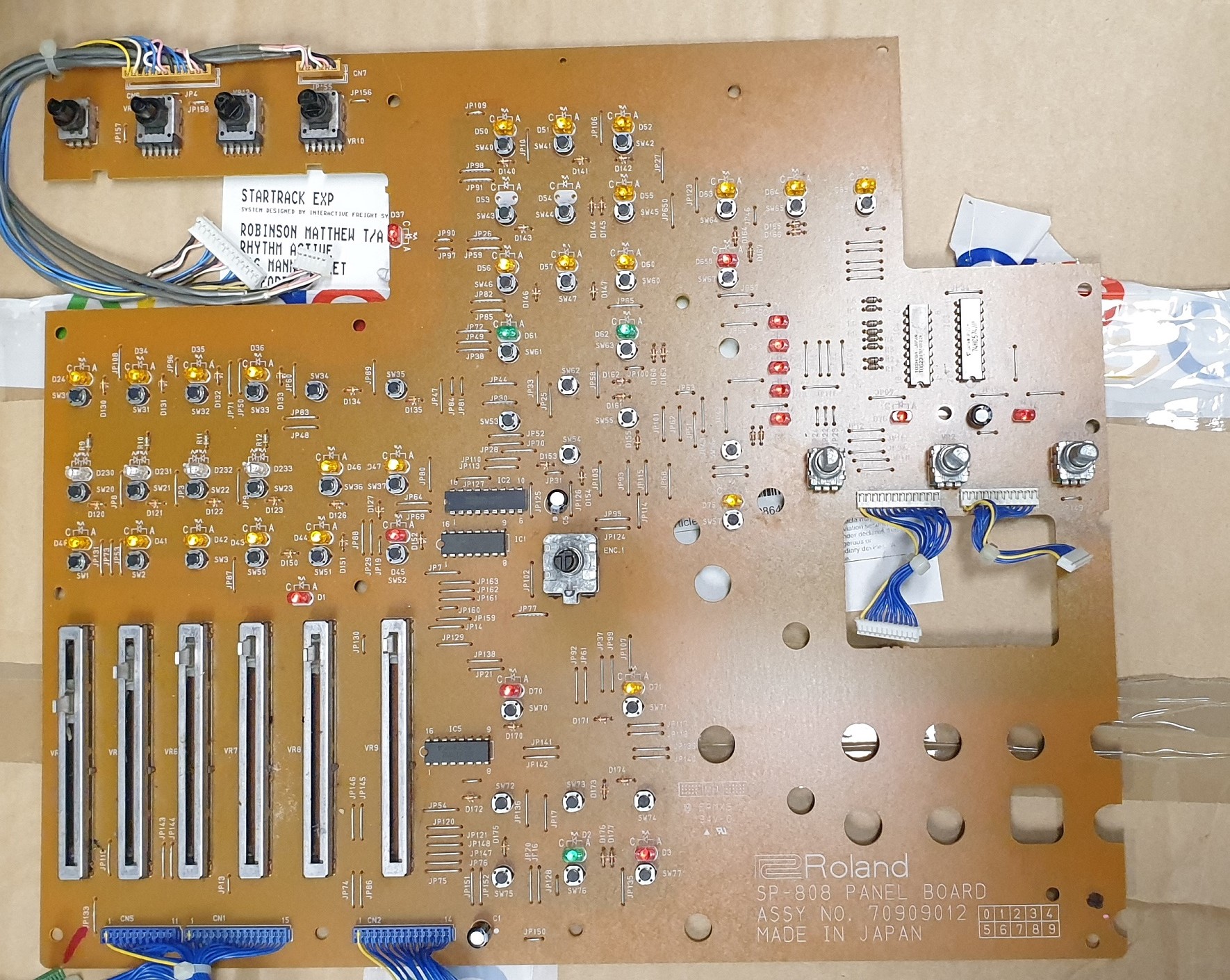

Back when I had intended to research the SP-808 a bit more, I bid on, and won a CPU board for the SP-808 on eBay.
The dodgy seller sent me this useless (to me) Panel board.
If you own a SP-808, and want it, let me know. I will post free to anyone in AU, or if international, you just pay postage.
First in gets it.

@fzabkar, the chip you asked about has the following markings. Looks like a USB Power Switch, according to Google?
Sipex 2526A-1E
1624L
I just got my magnifier (that was how I was able to read the chip) and some very small solder. I hope to attempt the ATAPI mod to the board sometime this weekend. (Also @fzabkar , thanks for the reminder on the exact board mods.)

Check the Enable pin of the Sipex chip, or check whether +5V is present at the USB connector.

@fzabkar, I'm certain that Power was getting to the USB Connector, because the USB Drive I was using to test has an LED inside it. The LED was solid "on" when the SP-808 was powered up. rs
