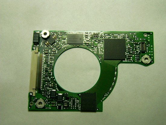

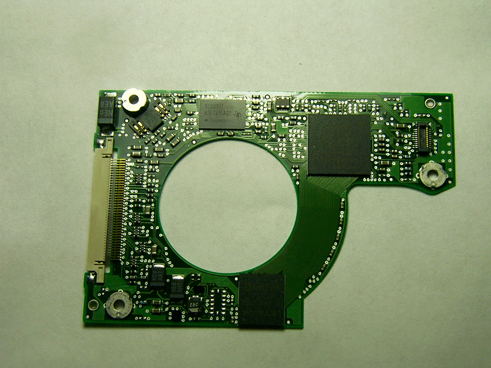

Can you post the other side too?
 Post subject: Re: Seagate 1.8" hard drives.
PostPosted: July 25th, 2009, 0:06
Joined: March 27th, 2009, 3:10
Posts: 76
Location: Wisconsin
Yep.
PostPosted: July 25th, 2009, 10:52
Posts: 1466
Location: Europe, Hungary
Junior0409 wrote:
I got the one drccsc had a link to. It was also the only one available :)
Anyway, here is a the pcb.
The more I learn about hard drives, the more Im impressed with the things that you guys have been accomplishing. Reading some of this stuff is like reading a whole different language and I guess it is in some ways.
Actually i am not sure, this pcb have a serial terminal. :shock:
Anyway, if there is, i can measure or trace it out....
I suggest to try to measure the testpoints around the "seagate" logo, in the top left corner.
Maybe you can find it.
Please keep us informed.
Janos
