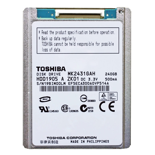

Bytes per sector (HOST) - 512
Bytes per sector (DISK) - 4096
So theoretically it emulate (at least Datasheet say so). So why XP doesnt see that hard drive? Any ideea?
The drives normally have a sticker to say go to their website so that you can see what if any extra steps are needed to use the drive. did you do that
Dell's driver page seems to suggest that Windows XP was a supported platform for the Latitude XT.
ftp://ftp.dell.com/Pages/Drivers/latitude-xt-all.html
The following section suggests that the standard drives were Samsung 1.8" PATA/ZIF models:
ftp://ftp.dell.com/Pages/Drivers/latitu ... Historical IDE and EIDE
So, no, I can't answer your question.
I'd be looking at your BIOS setup, and I'd also be examining the resources (IRQ, DMA, IO ports) in Device Manager (in Vista/Win7/Win8). Examine the properties of the IDE port (eg PCI Vendor and Device ID). Try refreshing the device list in Device Manager.
No it doesn't have ANY sticker - just, model, part numer and serial number.
I manage to install XP into an external hard drive (USB 2,5"). It still doesn't detect my internal 1,8" hard disk. (by the way hard disk itself it's ok, it contain windows 7 and work all right with it)
I think it is something about hard drive firmware or something.

HaQue wrote:
Good Point are all the chipset and storage drivers the latest ones. There may be some software support added.
I wasn't suggesting that there was a driver issue. AISI, Windows XP should have native support for IDE controllers, so I doubt that it needs some kind of pre-installation driver, as is the case with SATA controllers. In fact it would be interesting to see if Windows 9x could detect the drive, or even FreeDOS.
I WILL try to install an old Win9x and the latest version of freeDOS.

So IT DOES NOT WORK. I try with Windows 98, Win2k, and again Windows XP...NOTHING. This hard drive is not detected by ANY OTHER Microsoft OS until Vista SP2 (from Vista SP2 its working without any problem).
I really don't understand WHY is not detected, as the hard drive controller translate from 4k to 512 Bytes sectors to host OS.
What mechanism is inside Windows 7 for detection of hard drive ? Maybe can be implemented in XP (as a driver or a patch)
