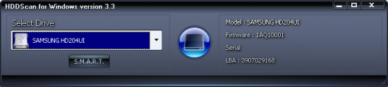

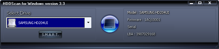

Doomer wrote:
dfr wrote:
When HDDScan is identifying the drive and its firmware does it sent the IDENTIFY DEVICE commands? Because it is identifying that without using SMART option. It does it by default.
It does if it could. Not all USB chips allow sending this command
As you can see on the screenshot it can in case of this Verbatim drive. So does it mean that HDDScan can provoke appearing of the bug, and data loss is possible in this case? SN was removed from the screenshot.
HDDScan Verbatim 2 TB 3.0 USB Samsung HD204UI - firmware report nosn.png [ 33.74 KiB | Viewed 25187 times ]
 Post subject: Re: Verbatim USB 3.0 external 2 TB HD with Samsung F4EG HD204UI
PostPosted: February 12th, 2011, 0:29
Posts: 3598
Location: Chicago
I have no idea and frankly I want to keep it this way
HDDScan sends command to a Microsoft (or any other) driver and driver sends it to USB chip. USB chip may or may not send it to actual hard drive and it depends on USB chip's microcode
Any program could do that and there is nothing special about it
From my understanding NCQ will work only with Native SATA commands (so you need AHCI SATA controller) and USB chips do not support Native SATA commands

I just wanted to let you know the firmware version will not change after flashing. The version did not change because it takes a long time to get customers approval for change notices. It would have taken over a month before we could have released the fix.
Please make sure that for each drive the flashing process is successful…
We have already implemented the fix to our production. So drives available on the market in 2 months time will have the fix applied. To be sure check the manufacturing date on the drives, January 2011 would be safer…"
http://lime-technology.com/forum/index. ... 9#msg90249
When I asked them why their patch tool is not changing the firmware number and how can one check if the patch was successfully applied their response was evasive to say the least:
"Even though there is no indication of the change in the patch please rest assure that the patch has been applied to the drive. If you continue patching it, it will continue to do so.
We suggest that you contact Samsung 1-800-726-7864 for further assistance.
Thank You for choosing Samsung."
