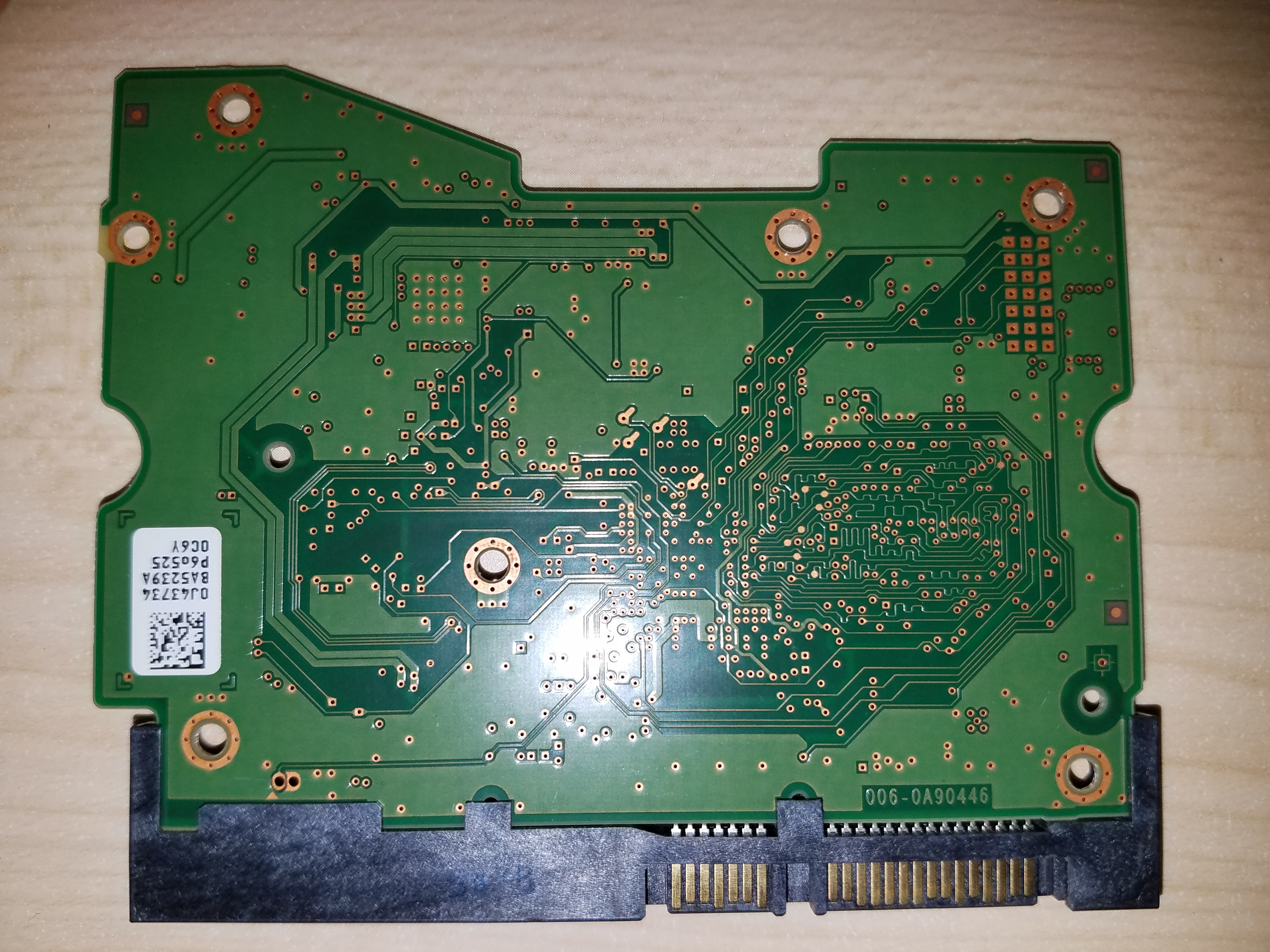

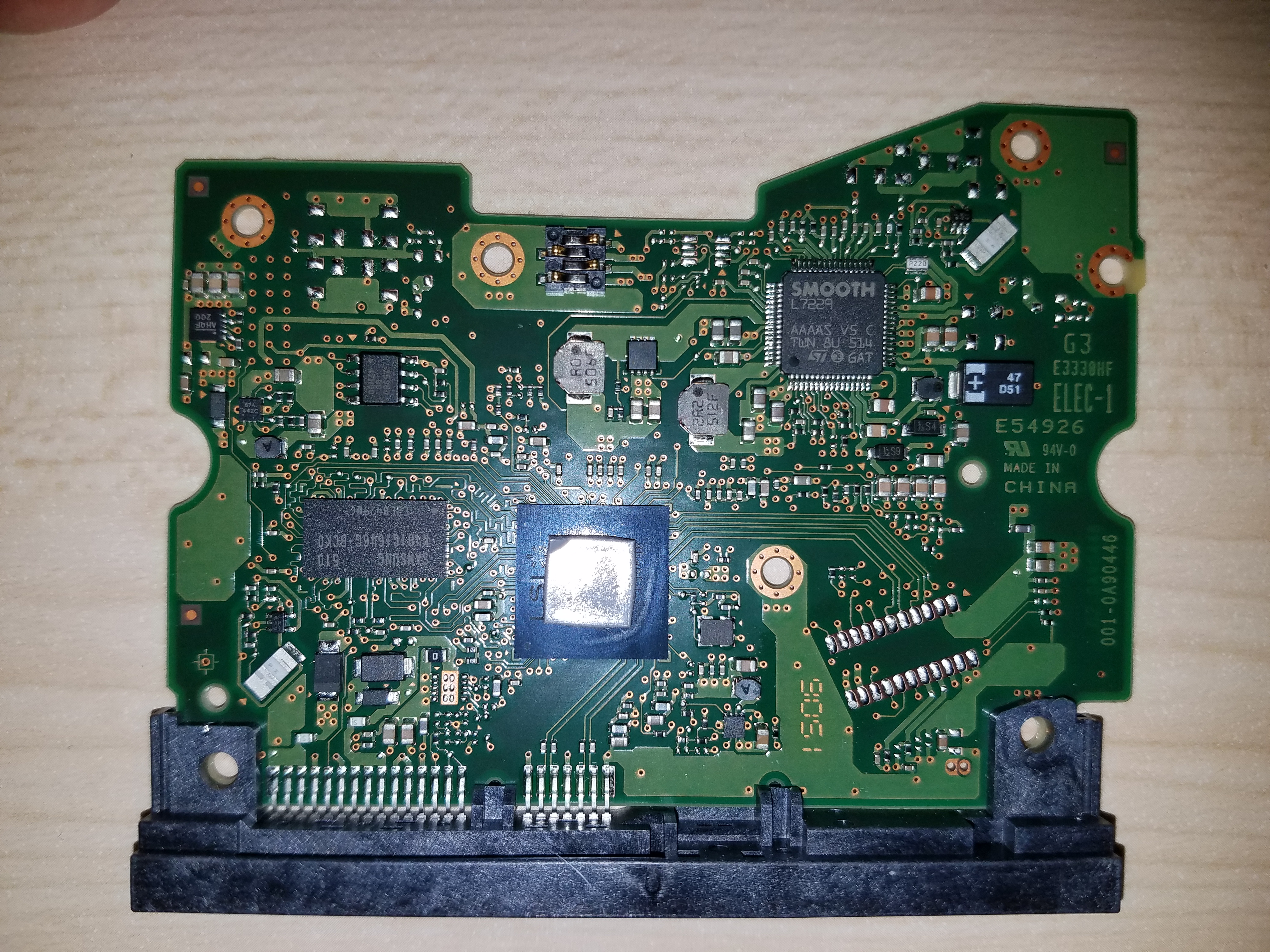

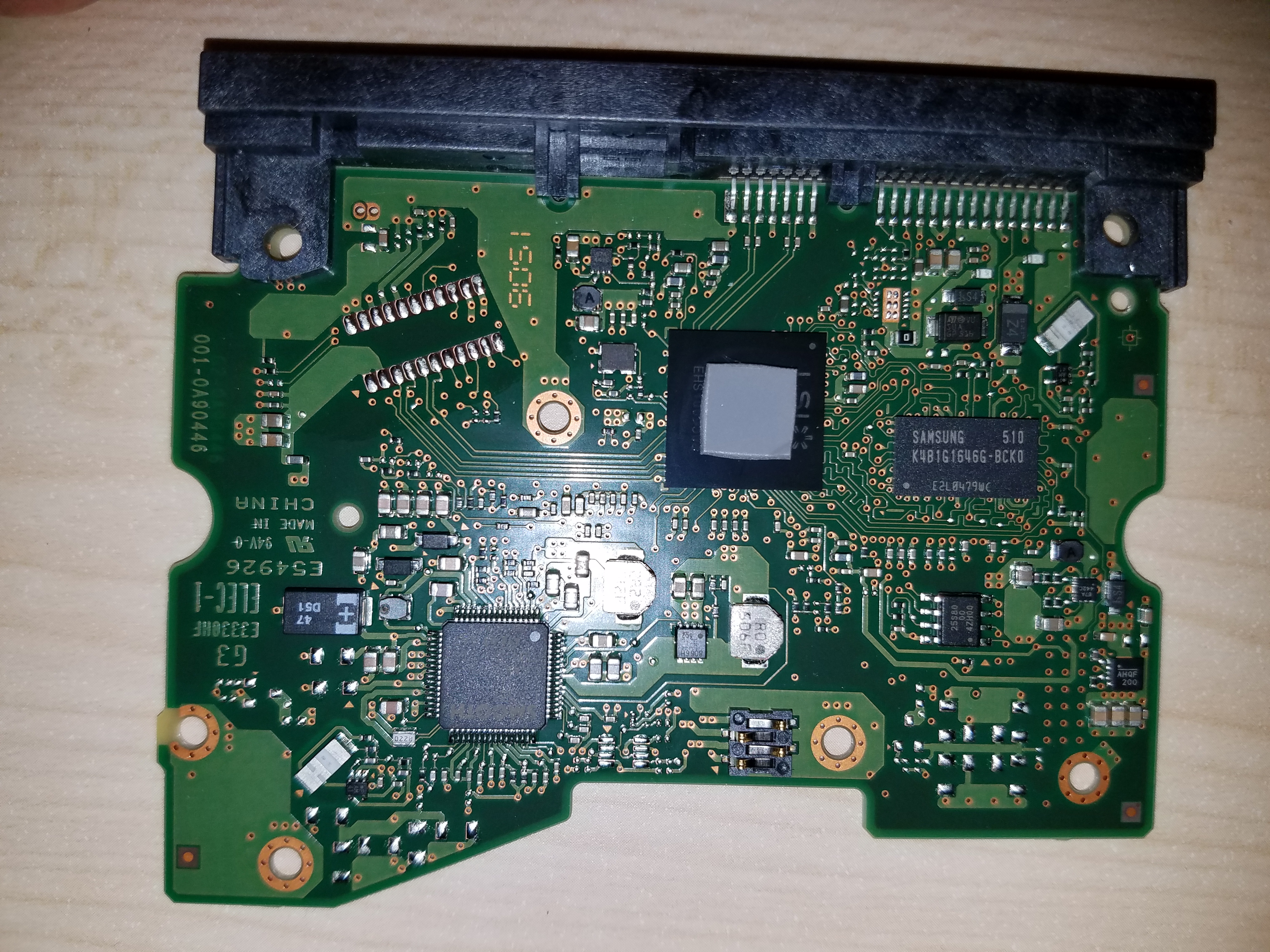

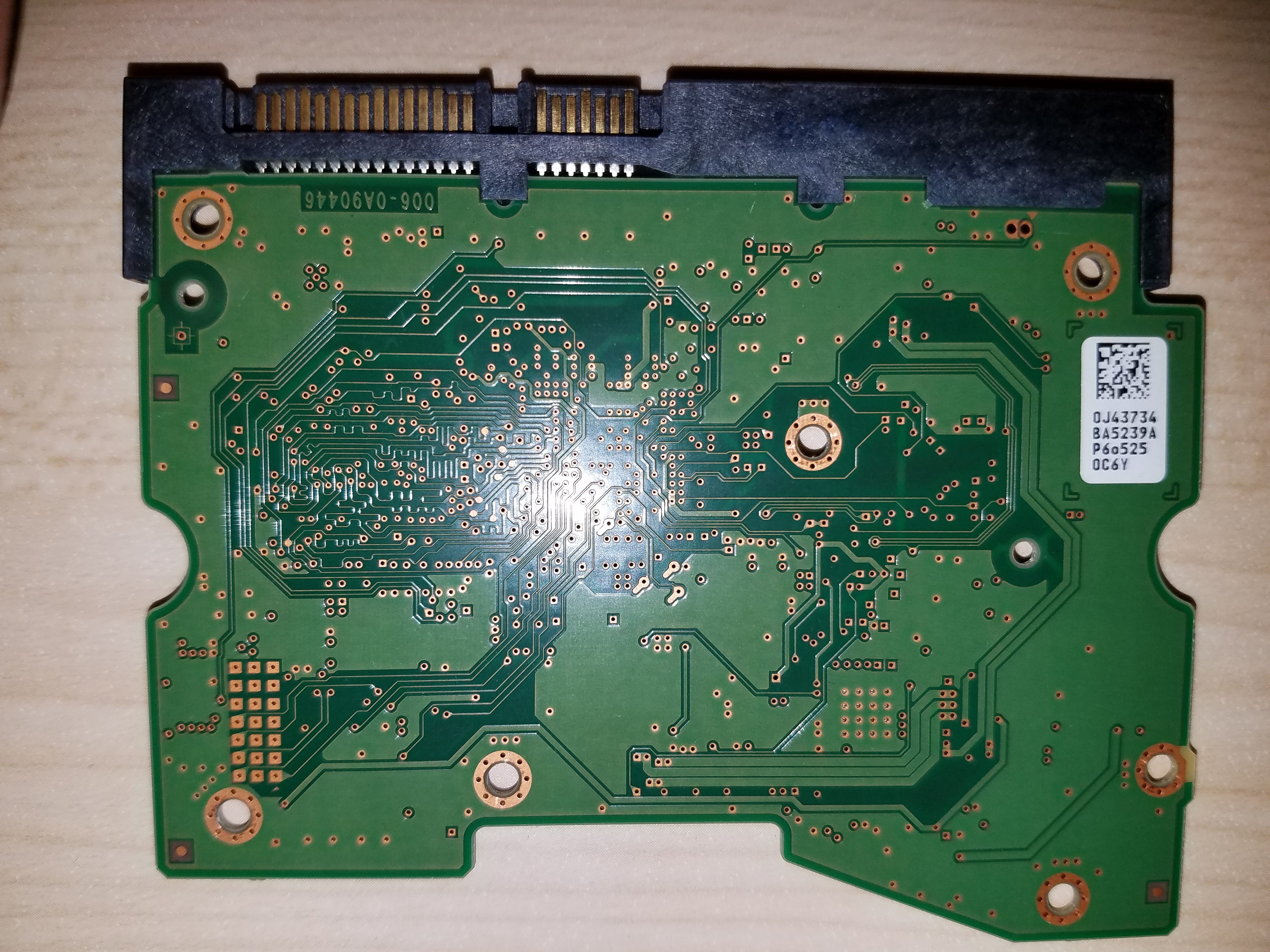

So as I get back to playing with this, I have a question. Is is possible to safely (I do not want to kill the drive!) short some points on the pcb to effectively make a head unable to read? I don't know exactly how the preamp works, so I don't even know if this is possible. I am attaching pcb pics, two pics of each side with the camera flash in a different spot.

The head select logic is multiplexed, so it is not possible to disable a particular head via manipulation of the PCB, AFAICS.
These preamp block diagrams should illustrate how things work:
http://www.hddoracle.com/viewtopic.php?f=59&t=229
I was afraid of that. Oh well, you can't win 'em all...
