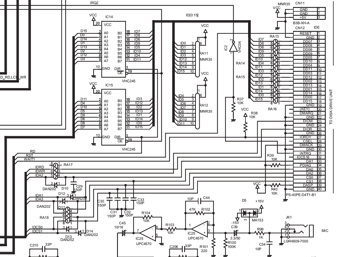

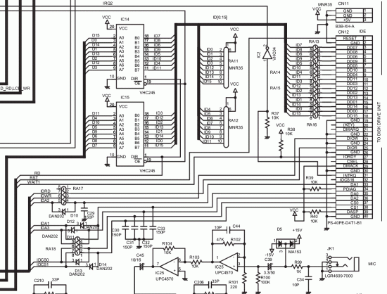

Maybe an excerpt from the schematics might be helpful to the discussion ...

Not a tech myself, but would think the answer would be on the IDE ZIP side i.e Roland knew they were only going to accommodate the ZIP and made the interface accordingly.
It would seem that we need to emulate the IDE Zip Mode somehow.
So that would be Mode 4 with a removable setting?

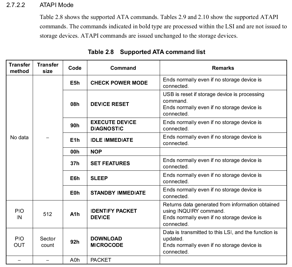

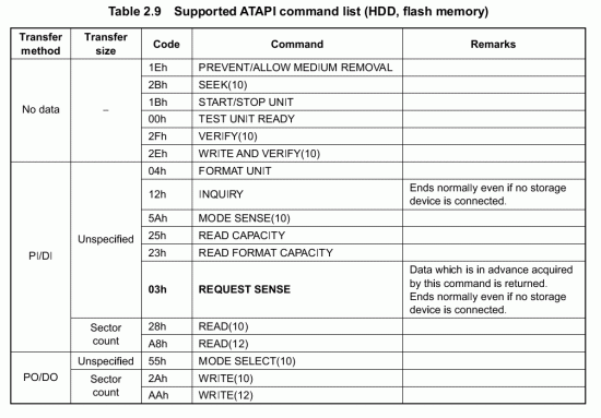

I have collected several technical docs here:
viewtopic.php?t=28469&p=197935

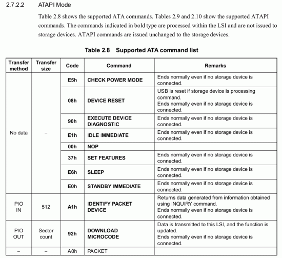

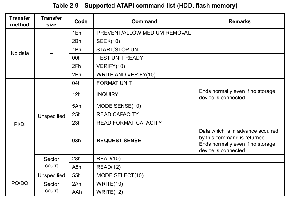

The adapter appears to be based on Epson's S1R72U16 IC which bridges an IDE host to a USB mass storage peripheral. This IDE has both an ATA mode and ATAPI mode.
It supports the ATA Packet command (A0h).

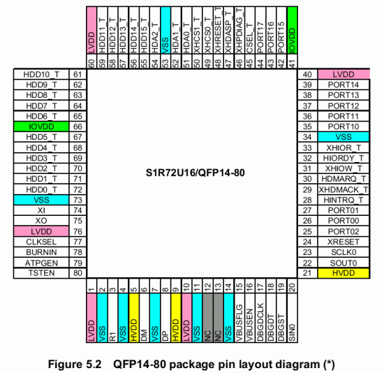

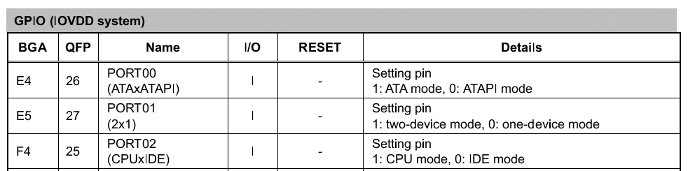

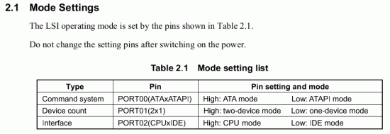

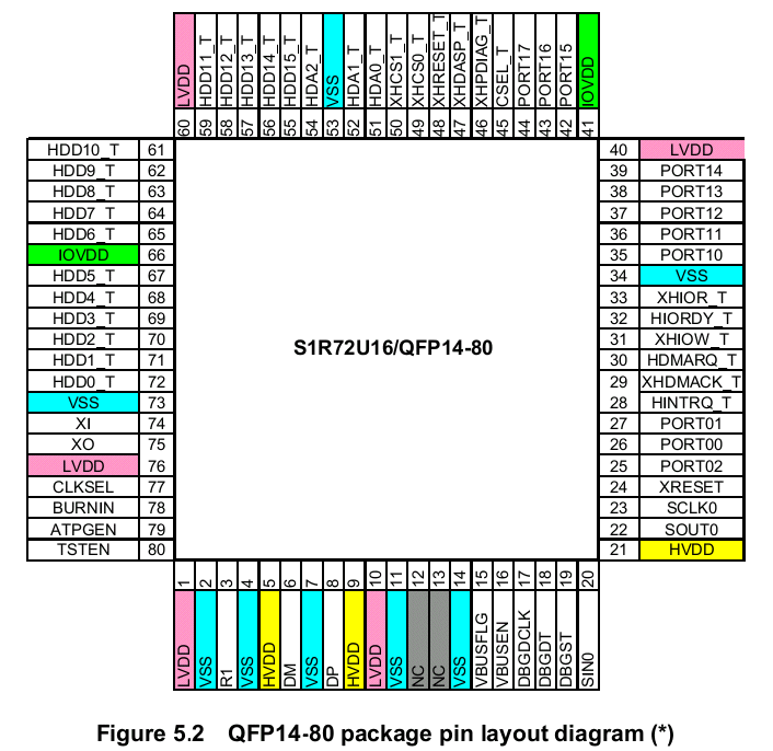

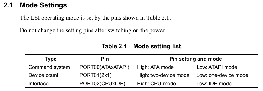

BTW, the S5U1R72U16F bridge has 3 configuration pins. You may need to ground these on any adapter that you buy.
