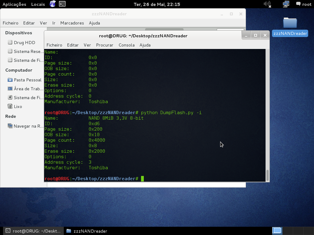

I'm starting to see progress, after all it was just a matter of re-wiring some pins and making sure all the tini pads were touching them.

DRUG wrote:I'm starting to see progress,
i don't see you're getting the right ID
Re: Dumping nand flash memory
May 26th, 2015, 18:04
well from 0x0 on all to this, seems a progress.
Is it possible that I have a sandisk chip with ID 0Xd6 and another one with 0x45 ? (what may cause this ? chip de-soldering not perfect ?)
May 26th, 2015, 18:30
i assume it's not the right configuration
whats the model ?

Why is the ID only 1 byte?
May 26th, 2015, 18:59
jermy wrote:i assume it's not the right configuration
whats the model ?
It's SDTNQCBMA-008G , a sandisk chip, strangely appears as Toshiba...
May 26th, 2015, 19:04
HaQue wrote:Why is the ID only 1 byte?
The ID always comes in that format, its like it shows on the pdf..
