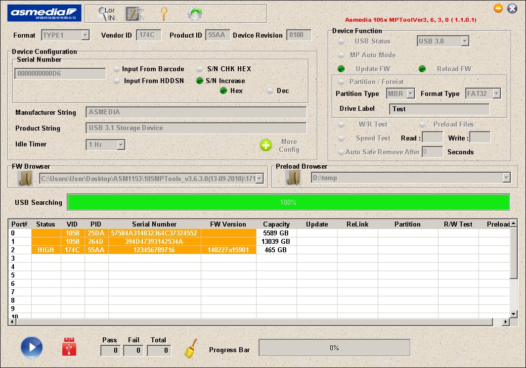

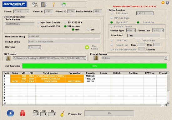

After a while I found some ASMedia tools (ASM105x MPTool and asm fw reader) to continue to elaborate with the WD enclousure.Interesting fact is, that ASM MP Tool is able to diplay a fw version of my Inateck USB/mSATA enclousure with ASM153E and Im able to dump the fw with the asm fw reader, however when run on the WD My Book or WD Easystore drives which have ASM1151M, the ASM MPTool does not show any info related to the fw and the asm fw reader gives an error on fw read.Wondering then if these chips have different registers or are simply locked for reading the flash over spi.The goal was simply to try to dump the fw from my 14TB Easystore and compare with my other 14TB Easystore dump.

Full capacity of 14TB HDD is 27349077168 (= 0x65E21CCB0) sectors.
A capacity of 0x065DE00000 sectors differs from the full capacity by 4312240 sectors (= 2.2GB). Does this mean that the USB bridge firmware is reserving the last 2.2GB for its own use?
Sorry, this is wrong.
The IDEMA standard has been superseded by SFF-8447.
SFF-8447, Specification for LBA Count for Disk Drives, Rev 0.5 May 14, 2015:
https://members.snia.org/document/dl/25903
Drives with advertised capacities that are less than 8TB still follow the IDEMA standard. However, those with capacities greater than or equal to 8TB are now subject to a revised formula.
The new standard capacity for a 14TB drive is 27,344,764,928 (= 0x65DE00000) sectors.

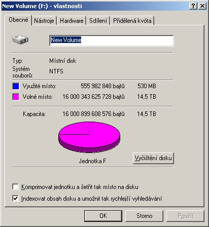

Meanwhile I got a enclousure from a 18TB Easystore, plugged my 16TB WD Gold WD161KRYZ.The enclousure got detected which was a 1st good sign.I fired the WD formatter, let it format and viola, 16TB partition is there ! Unfortunetly I could not make a FW dump, bcoz this board had a Puya P25Q21H SPI Flash instead of Winbond W20X20 like on the 14TB version and my EZP2019 program does not support it.Sorry the screenshot is in CZ lang, but I think you can figure out :) Now I would have time to investigate what went wrong with the 14TB enlousure.

Doesn't your software allow you choose a generic 3.3V SPI flash?
https://www.skytech.ir/DownLoad/File/9059_P25Q21H.pdf
