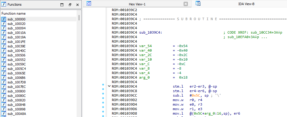

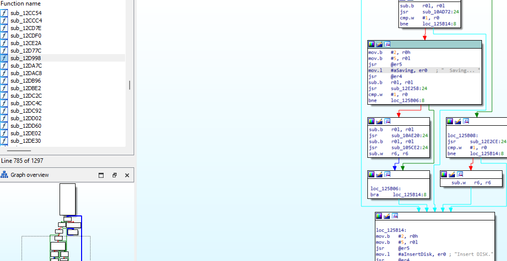

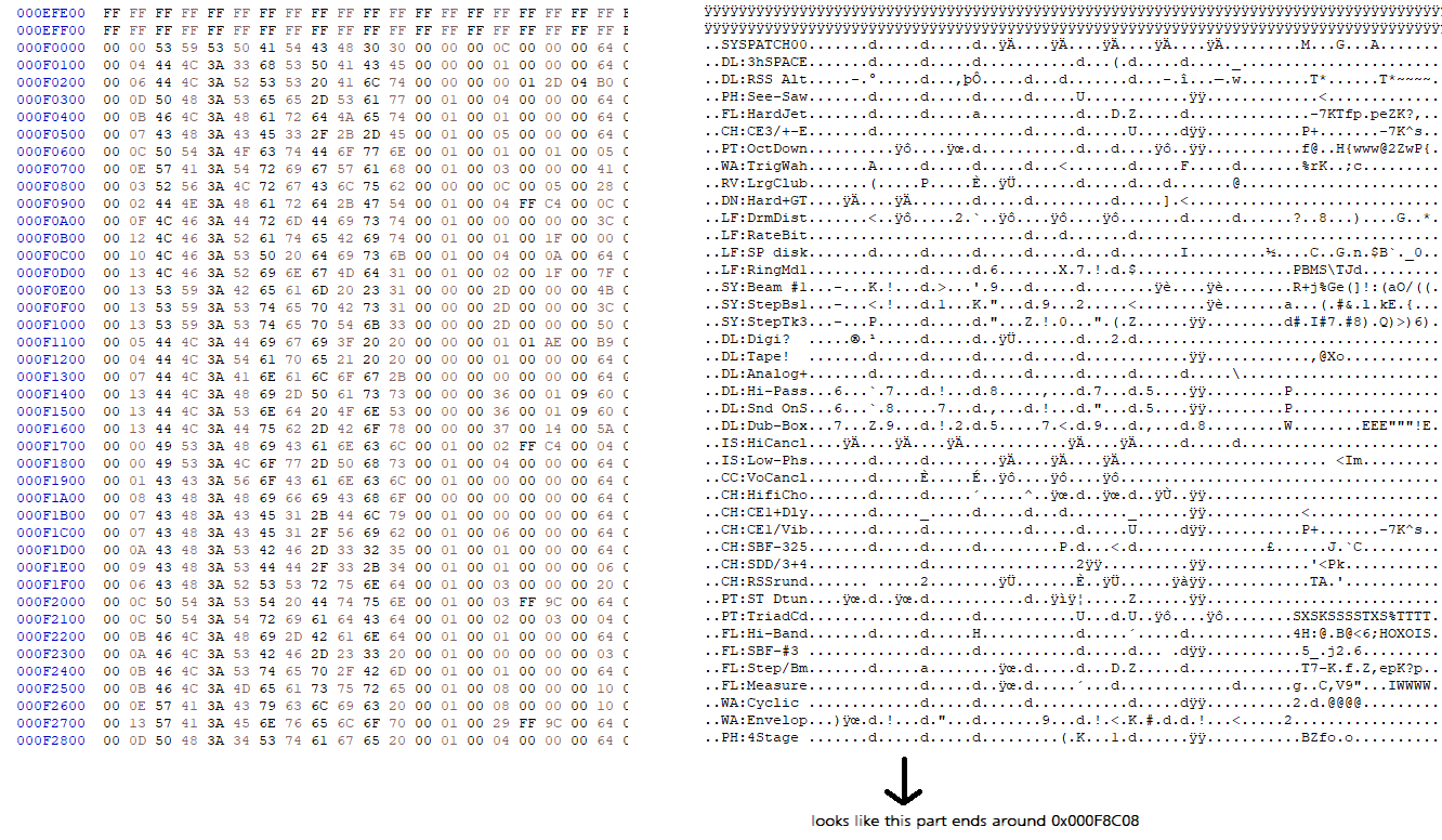

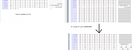

 Post subject: Re: Sniffing control flow between legacy devices over PATA/A
PostPosted: October 25th, 2023, 9:44
Posts: 4001
Hsiboy wrote:
Small correction to the above, it's
7A 00 00 00
And here's the odd thing. If I diff the Sp808 firmware and the A6 firmware, these patterns occur in the same place in both files. In fact, there are so many null bytes
00
that occurs in exactly the same place in the two files, it has to be an artifact from the midi update.
Question is, has it been extracted incorrectly, or, is it a further later of transport packing, because the firmware was being streamed in over a uart.
Also, there are strings that appear on the screen of both devices, that are not present in the firmware.
So, either the firmware does not update everything, or there is further compression.
The entropy of the two files is below 1, so I don't think it is compressed, but either way, the firmware that was extracted earlier in this thread, is currently a dead end, because it can't currently be compiled.
the proliferation of 0x00 is because many instructions are designed to have upper bits of addresses as 0x00
Program-Counter Relative—@(d:8, PC) or @(d:16, PC): This mode is used in the Bcc and
BSR instructions. An 8-bit or 16-bit displacement contained in the instruction is sign-extended and
added to the 24-bit PC contents to generate a branch address. Only the lower 24 bits of this branch
address are valid; the upper 8 bits are all assumed to be 0 (H'00). The PC value to which the
displacement is added is the address of the first byte of the next instruction, so the possible
branching range is –126 to +128 bytes (–63 to +64 words) or –32766 to +32768 bytes (–16383 to
+16384 words) from the branch instruction. The resulting value should be an even number.
(8) Memory Indirect—@@aa:8: This mode can be used by the JMP and JSR instructions. The
instruction code contains an 8-bit absolute address specifying a memory operand. This memory
operand contains a branch address. The upper bits of the absolute address are all assumed to be 0,
so the address range is 0 to 255 (H'0000 to H'00FF in normal mode, H'000000 to H'0000FF in
advanced mode). In normal mode the memory operand is a word operand and the branch address
is 16 bits long. In advanced mode the memory operand is a longword operand, the first byte of
which is assumed to be all 0 (H'00).

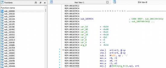

Initially promising, I found my disassembling lacking. The MAME emu has *some* support for H8's and there exists a disassembler in the tools. I couldn't get reasonable results.
PS C:\SP-808\disassemble>unidasm.exe
Usage: C:\SP-808\disassemble\unidasm.exe <filename> -arch <architecture> [-basepc <pc>]
   [-norawbytes] [-xchbytes] [-flipped] [-upper] [-lower]
   [-skip <n>] [-count <n>] [-octal]
Supported architectures:
  8x300          h8             m68020         sc61860        upd177x
  adsp21xx       h8h            m6803          scmp           upd7725
  alpha          h8s2000        m68030         score7         upd7801
  alpha_nt       h8s2600...

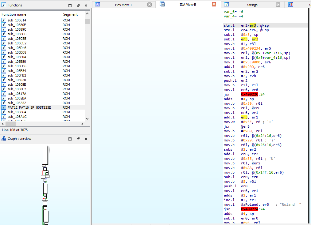

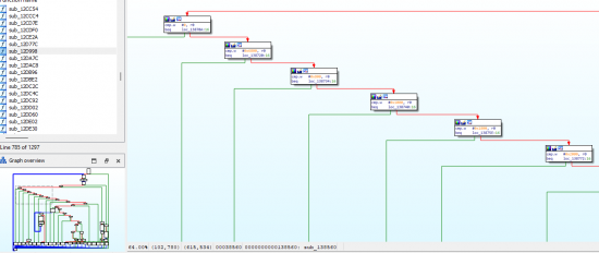

I am looking at how likely it is I could write a processor module for Ghidra. The instruction set is only 69 odd instructions, but the variety of modes possible, and the many nuances look tricky. The H8 processor module doesn't look that scary, but you would need to get it pretty right, so you don't spit out garbage.
I see MAME has a few processors and looks like they build on previous versions. example H8S2600.h would have a H8S2000.h include which includes a H8300 include... and the last is simply a H8 include. but MAME processor definitions look HARD!
been looking around at some other stuff H8 hacking related to see if there are any that might help. more to come tomorrow

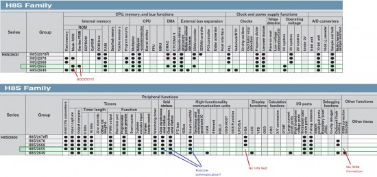

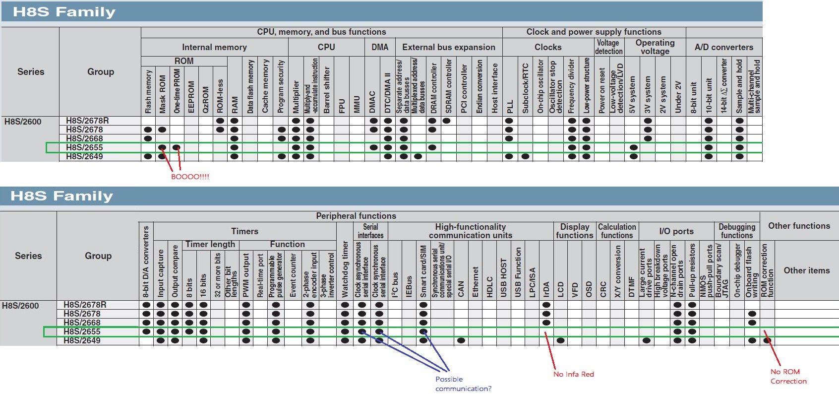

here is a lesson on hacking a MCU. fascinating. I don't think in my lifetime I will get to this level, sadly.
http://dmitry.gr/?r=05.Projects&proj=28.%20pokewalker
Seems the HD6432653 is one of those in-between models that the vendor will say.. what 2653? I dunno what you are talking about..shhh!!!
There are a few differences between closer models (would have been nice if it was one of those!) that is going to make it difficult to proceed.

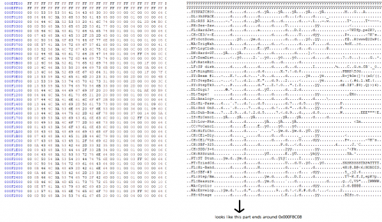

anyone have a dump of the Sharp Flash LH28F800SUT? Looks like it is where the .mid files write firmware to. maybe we are not supposed to cat them all together? possibly they need to align to specific memory map. Also, maybe this file is not a single program to execute, and therefore decomplie, but a collection of small programs/code to jump to and data.
this site appears to have worked out any sp808-ex will work fine with a HDD once updated with A^ .mid files, and so might not be too much in reversing the Hitachi 2653, but more effort on these .mid updates and the flash.
https://sp-forums.com/viewtopic.php?f=10&t=4353
I asked a chip revere engineer/decap company if they could get the mask and PROM from the hitachi, and they said they are working on it but not able to yet. GO HITACHI!!! ;-)

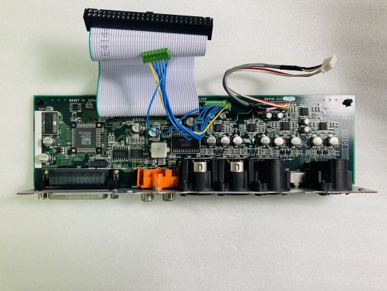

Anyone know anything about these expansion boards for the SP?
https://reverb.com/au/item/56525330-rare-roland-sp808-op2-scsi-digital-i-o-expansion-board-for-sp-808-sp-808ex-worldwide-shipping
Very Rare Roland SP808-OP2 expansion card for SP-808, SP-808EX.
Adds SCSI, Digital In/Out, and balanced stereo input / output with XLR Mic input.
Two XLR Inputs with Line/Mic switch - Two XLR Outputs - Digital SP/DIF In/Out - SCSI port for adding an extra Zip drive.
I wonder if this port is useful in any way?

I have the OP1 board fitted in my SP808, sadly the SCSI also only works with Zip drives, I have a SCSI CF drive and tried it with various CF cards but no bueno.
Interesting to note about using the Akai MPC2000XL MCD drive in place of the Zip drive, you can still get disk busy messages if trying to cut and paste small sections of audio, albeit less so than with the Zip drive. AFAIK the Roland A6 which was fitted with a IDE HD did not suffer from disk busy errors, the A6 also has some other useful features like split phrase and adding fades which would be useful on the 808, but A6 lacks quite a lot of key features that the 808 has, if a hacked firmware could be possible someday, it would be great if some of the A6 features could be added to the 808 as well as of course the drive handling stuff.

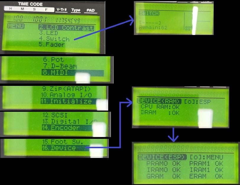

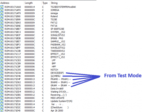

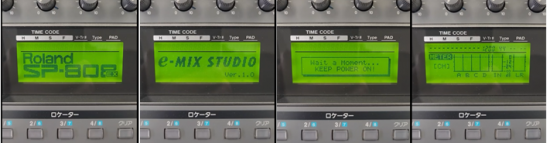

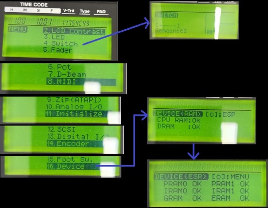

So this part of the manual appears to confirm there are 2 'firmwares'
Verifying version
While in the test mode, the top of the screen displays the CPU
software version and the system software version in the
format shown below:
1.00 1.000
Left: CPU version; right: system version
It is kinda obvious, but still good to confirm things

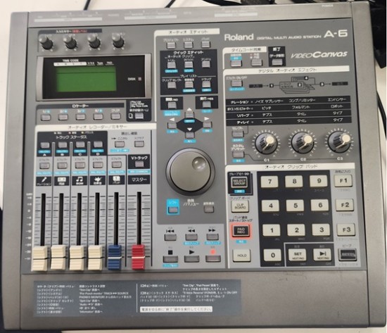

PostPosted: November 21st, 2023, 9:12
Posts: 4001

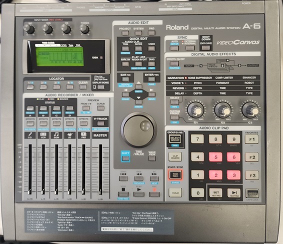

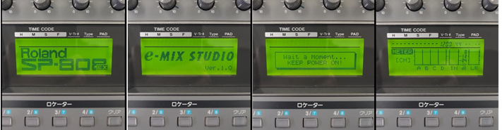

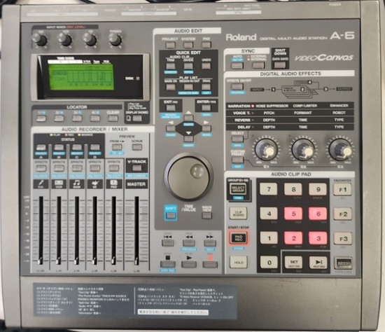

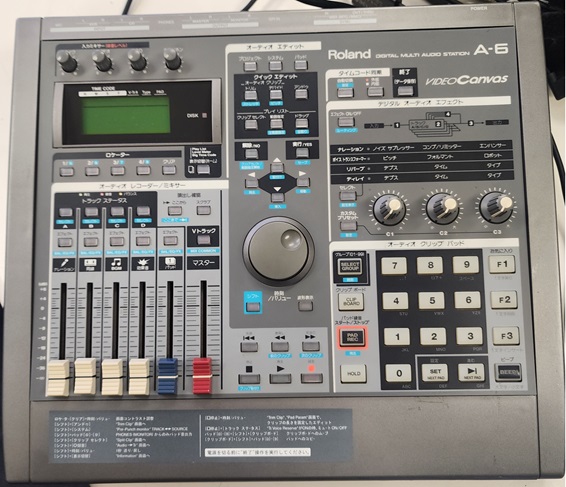

Received my A-6 today. labels all in Japanese!
Luckily this was an overlay easily removed.
It already had SP-808EX on it.

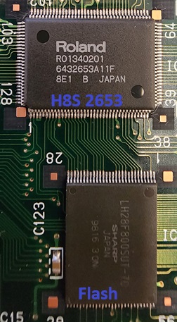

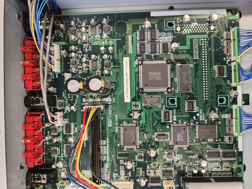

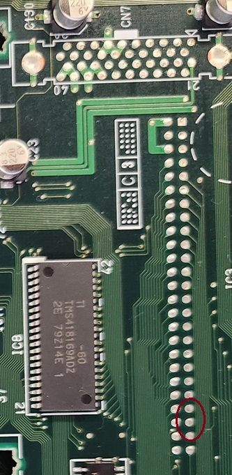

Nothing lasts long without me getting a screwdriver to it! Here is the MB:
I thought the pads at CN7 looked like they had been probed, but no this was just some flux. but the 2x25 row of pads when looking under microscope definitely show there has been probes pushed into the pads, each pad had about 3 probe marks. the circled ones I only had time to check, but they go straight the the H8S processor.
The processor and flash chip are my targets. I am going to hit the SCI Serial Communication Interface on CPU, test pads and other Ports of chip with the Saleae logic analyser, read the flash chip once my new T56 Programmer arrives and see if any signals are evident. Also looking at the test programs mentioned in the manual and finding some way to run code from ram to try and read out the mask rom on CPU. if there is a vulnerability in the system somewhere, it may be possible.
There is Beam board and MIDI peripherals that communicate with the processor, so maybe there is a way to use these I/O ports to gain more access.

Wondering if it is possible to use the technique in this post to somehow access other parts of the system. Namely put CPU in a different mode that ignores onboard OTPROM and boot from flash with some code.
https://hackaday.io/project/188508-repu ... 039-h8300h
Also wondering about how the buttons tell the OS what to do. Looking to see if a button press is sent via an ascii code or some protocol, what happens if we send something unexpected?
I edited together some images of the test mode. The RAM looks interesting. Not sure what PRAM0, PRAM1, IRAM0, IRAM1, GRAM and ERAM are. I have seen reference to IRAM being CPU Instruction RAM, but not so sure that is what it is here.

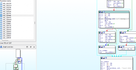

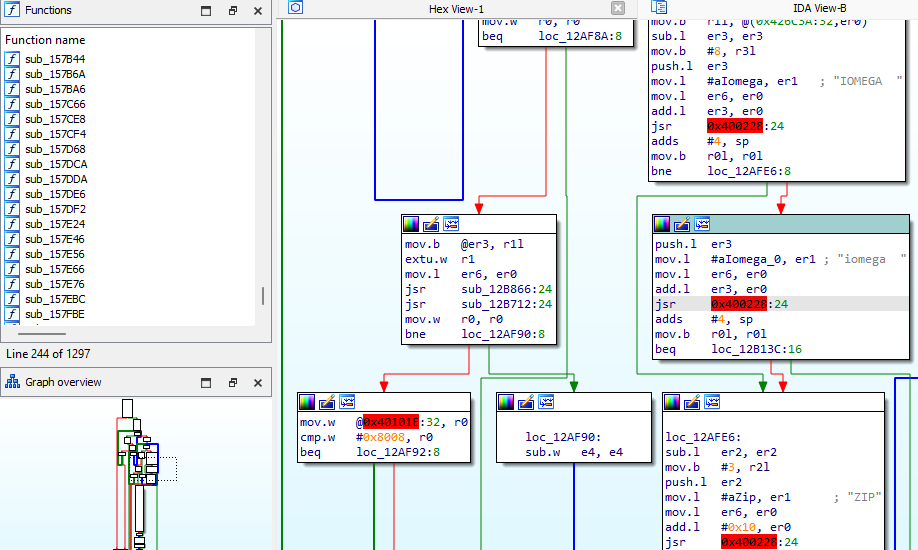

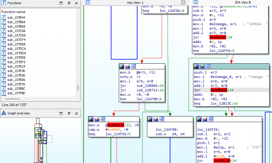

Appears the update file previously put together decompiles. Have got a nice disassembly of over 1200 subroutines. Subroutines appear to mostly look well disassembled. The pic shows the start of a function with parameters passed at the start.
Some disk routines found:
This looks to be a menu or at least a case statement, if or similar. likely responding to a user input:
Test Mode looks to be part of Flash:

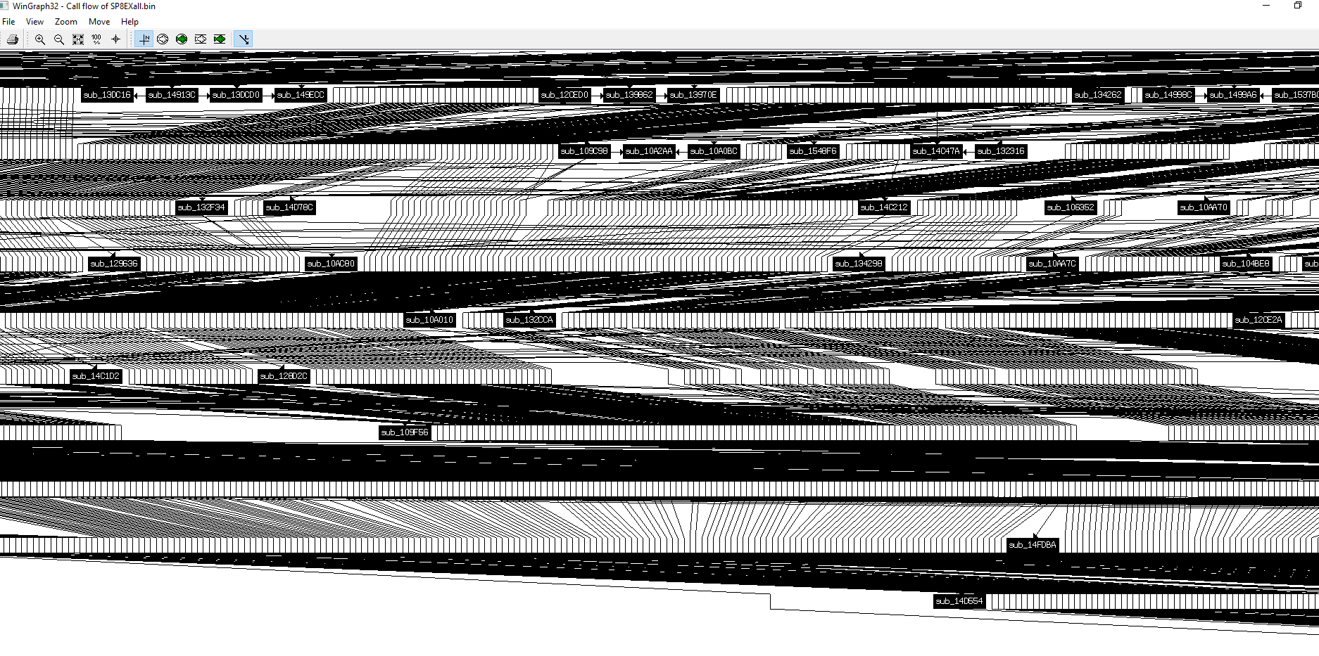

Getting some nice idea of program flow:

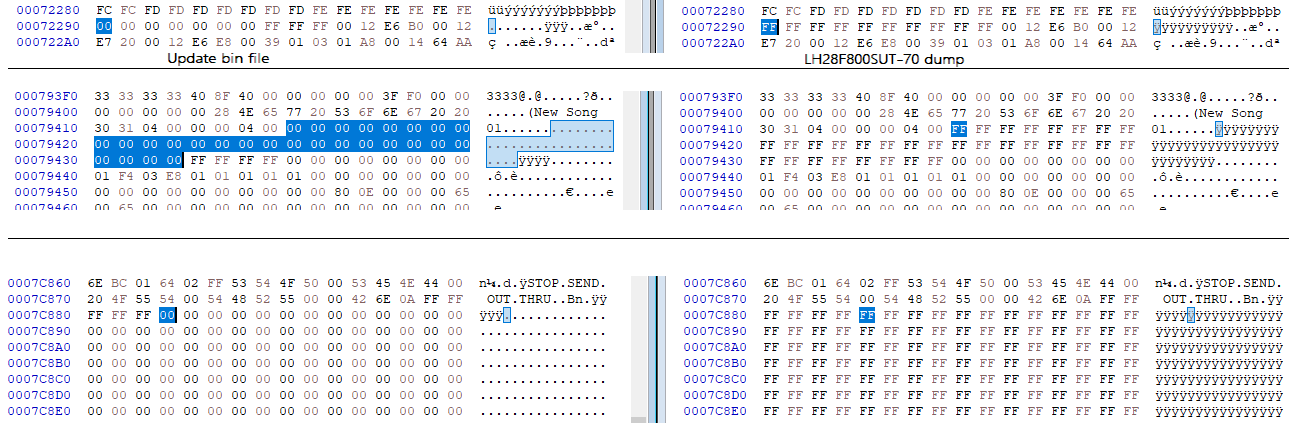

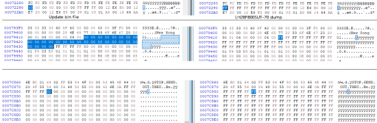

I received the programmer to read the LH28F800SUT flash chip.
Interesting. The start of the flash dump is essentially the same The SP808.bin that we have from previous work extracted from the .MID updates.

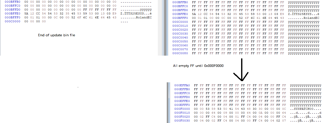

The dump is bigger, and continues with assumed empty space until 0x000F000
Then there is some more data:
if you make the view 256 bytes, there is a visible pattern.

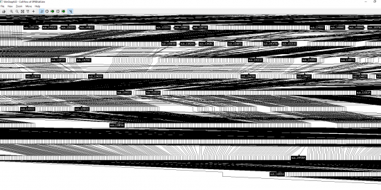

the flow looks to be easy enough to follow, so starting to drill down into the disk ones and analyse them.
Luckily we can isolate functions so as to not need to follow this
