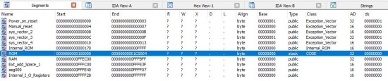

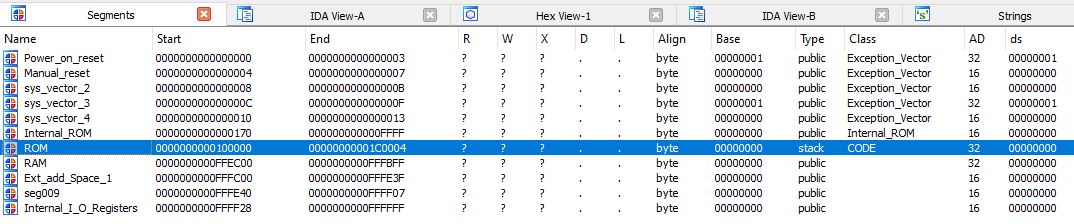

as for disassembly, specify Hitachi H8S advanced, and H8S/2215R. Closest I go to the actual CPU.
the following seemed to work for a dodgy memory map. not sure how accurate it is because this is from my work PC, and I may have worked on it more on my laptop that is currently only got a new install of win11, with the SSD out of it hoping I can recover it. My fault for getting a new laptop and simply swapping SSDs, installing new drivers and hoping it would carry on. didn't expect blue screen and all methods of recovery not working. dammnit!
I started adding the memory map from the CPU docs, but to be honest, wasn't making a whole lot of sense to me!

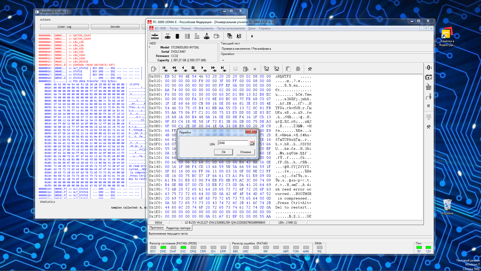

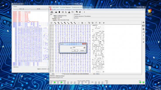

I noticed Roger (Midi Maniac) on youtube has done a video about using the ZuluIDE board, I still think a firmware have to allow any IDE card reader is better, because it will hopefully allow larger cards like the Akai MCD does, and it will be a better long term solution. The ZuluIDE currently only supports 100mb which hopefully will change in the future.
 Post subject: Re: Sniffing control flow between legacy devices over PATA/A
PostPosted: January 31st, 2025, 3:45
Joined: September 11th, 2024, 10:21
Posts: 64
Location: Russia
Is this topic's theme still actual? Because I did something... Coming soon.
PostPosted: January 31st, 2025, 5:50
Joined: January 7th, 2022, 6:43
Posts: 27
Yes, still actual.
Interesting screen shot.
I wait for your story.
