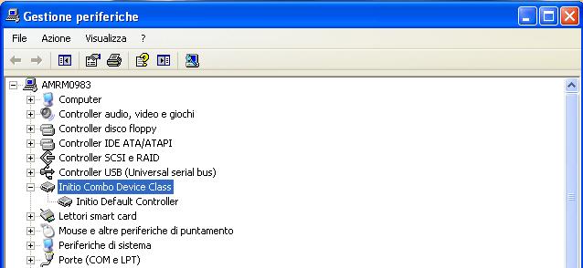

I disconnected, on the adapter, pins 2 and 6 (Data Output and clock) from the flash memory 25X10avnig.
then i connected the adapter with the disk to PC and the compuer find a new device. The PC automatically looks for a driver on windows website and finds a device named "initio combo device class", and inside it i find a "initio default controller".
on MyComputer i can not find any V-CD neither any external hard disk.
here annexed it is a screenshot of "device manager" and a report obtained with USBview:

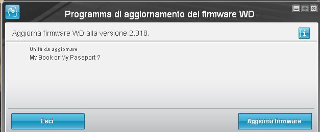

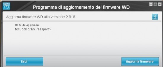

now that flash is disconnected i tried the WD tool named "Apollo 1607E Firmware Updater v2.018-v2.019 (1.0.8.6).exe" but it crashes during firmware update process.
here is a screenshot before it crashes:
imagination is more important than knowledge.
 Post subject: Re: HP HD (WD disk with SATA-USB adapter) -remove virtual CD-ROM
PostPosted: February 16th, 2011, 11:33
Joined: May 6th, 2008, 22:53
Posts: 2138

Once again, that's very interesting information. As expected, the Initio bridge chip identifies its own manufacturer (idVendor: 0x13FD) and its own internal part number (idProduct: 0x1617).
You have confirmed that the flash memory contains code that enables the VCD, and that it contains WD's Vendor and Product IDs.
Does the "Apollo 1607E Firmware Updater" also hang when the bridge board is not plugged in, or does the program fail in some other way?
I would try wiring the data and clock pins to a DPST switch. Open the switch before powering on the bridge, and close it afterwards. This should simulate the case where a new bridge board with a blank EEPROM is being flashed for the first time. Hopefully the updater will be OK with this.
PostPosted: February 16th, 2011, 19:32
Joined: February 5th, 2011, 7:54
Posts: 30
Location: italy
the firmware updater allows to press the "Update firmware" button only if it detects compatible device.
If adapter is disconnected or recognized as HP device, the button "update firmware" can not be pressed.
Good suggestion Frank. I'll try it.
PostPosted: February 19th, 2011, 0:50
Posts: 17315
I hesitate to suggest this but, instead of lifting the clock and data pins, it would be easier just to short one or the other to ground with tweezers. However, I'm not certain that this is safe to do. (If it were my drive, I would do it.)
