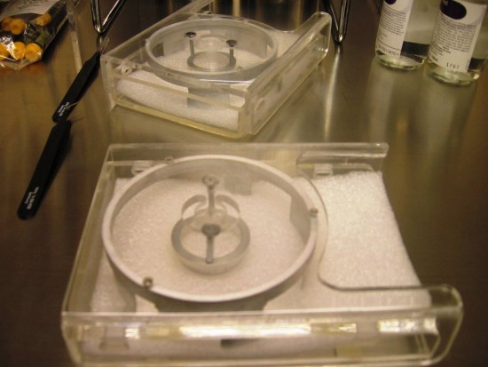

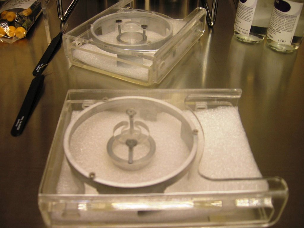

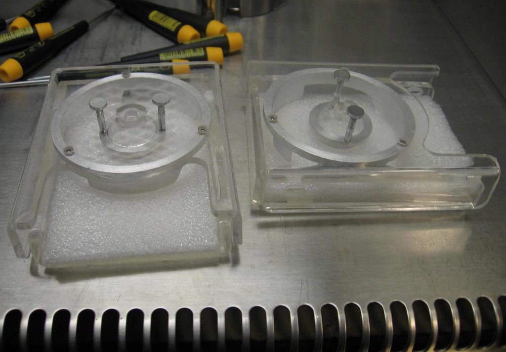

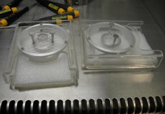

pcimage wrote:
I've ordered these HDRC tools too, to see what they're like.
I'll do full tests and post review and pics as soon as I can.
data recovery service[/b]
 Post subject: Re: HDRC UPDATE: Read Write Head Change Tools Review
PostPosted: November 18th, 2008, 23:18
Posts: 3235
Location: USA
Here. I'm not certain that I quite grasp what exactly these are supposed to do... I guess they come apart into separate pieces?
PostPosted: November 18th, 2008, 23:39
Posts: 1898
Location: In your hard drive.
I never use the bottom. It gets in my way.
PostPosted: November 19th, 2008, 18:16
Posts: 489
I am having trouble understanding how these are supposed to function; the salvation data HPE are easy to understand just by looking at the tool, but these seem hard to understand unless you have the tool in front of you, or instructions of course. Is there a link to anywhere that shows how these actually work?
PostPosted: November 19th, 2008, 23:43
Posts: 935
Location: NJ
Two words should make it clear... Friction Fit.
PostPosted: November 20th, 2008, 1:06
Posts: 1079
Location: canada
the problem with salvation data is that the platters can fall out if your not careful
but with these tools it looks like you screw the platters in so they can never move.
i know its basic but its the ideas that has gone into this tool.
salvation data are bringing out a new hpe recovery for spacers in hard drives.
PostPosted: November 20th, 2008, 1:59
Posts: 935
Location: NJ
The screws are to:
hold the metal friction fit piece to the plexiglas
hold the screw-catch metal piece to the plexiglas
No screws hold the platters. That is why this is desperate, last chance junk for those who haven't figured out other methods of bypassing spacers. The friction fit is iffy at best, and only gets worse over time. Salvation's tool has a much better, more consistent, more reliable grip on the platters.
