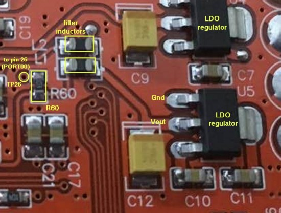

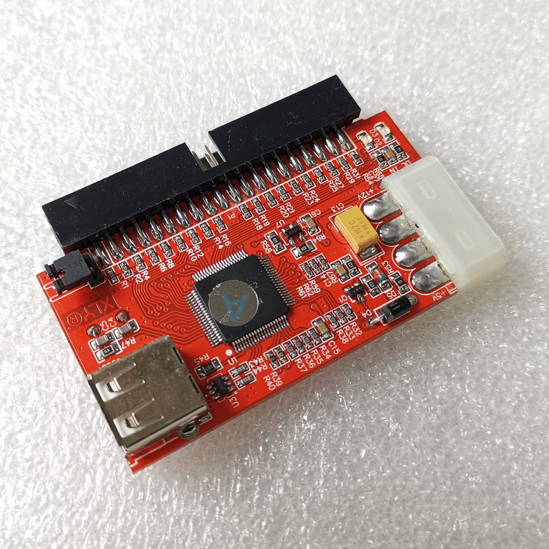

SalvationData Front and Back pics:
https://drive.google.com/file/d/0B2aVIe ... sp=sharing
Dimensions: 6.6cm x 4.4cm

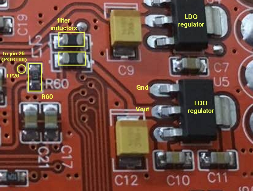

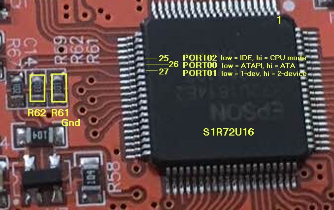

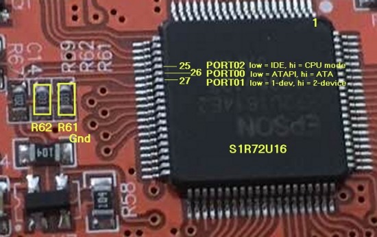

 Post subject: Re: Sniffing control flow between legacy devices over PATA/A
PostPosted: August 7th, 2017, 4:28
Posts: 17323
Wow, that's good support!
As I suspected, the card is preset for ATA mode.
Resistors R60, R61 and R62 configure the PORT00, PORT01 and PORT02 mode pins, respectively.
R61 and R62 are both pulled to ground (low), but R60 is pulled up to the supply (high).
To reconfigure the PCB for ATAPI mode, remove resistor R60 and connect a leaded resistor between TP26 and a nearby ground point. This resistor should have the same resistance as either of R61 or R62 (I can't make out their markings).
BTW, I found this useful tip:
http://lifehacker.com/share-direct-links-to-files-in-google-drive-and-skip-th-1493813665
As tech tips blog Digital Inspiration points out, most of the links Google gives you to share will open a file in the web viewer. While this is nice, you may not want to make the recipient jump through hoops just to download those TPS reports. If you want to share a direct link, simply change the format of the link from this ...
https://drive.google.com/file/d/FILE_ID/edit?usp=sharing
... to this:
https://drive.google.com/uc?export=download&id=FILE_ID
https://drive.google.com/uc?export=download&id=0B2aVIexl9TLZeFNtM19fbklPUjMxV1ltNUl6N2JHT1cxemhr
https://drive.google.com/uc?export=download&id=0B2aVIexl9TLZNEFjNWN5Wlh1cHBUeEF2dGZuZ2t4RTkzRGhB
PostPosted: August 7th, 2017, 4:53
Joined: August 17th, 2015, 21:40
Posts: 39
Location: Adelaide, South Australia
[quote="fzabkar"]Wow, that's good support!
Nice info all round...thanks!
I've forwarded that info and asked if units can be ordered from their supplier pre-configured to ATAPI.
Not holding my breath but you never know.
