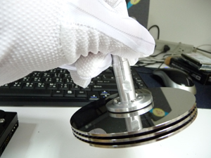

 Post subject: Re: Another platter transplant tool?
PostPosted: July 13th, 2010, 14:52
Joined: August 1st, 2009, 11:16
Posts: 61
Location: Taiwan
We developed some similar tools, and I think it is easier and even don't need a sturdy table.
You can work with only a clean champer.
I have tested in some of Seagate ,WD and Hitachi models and work well. :D
I don't sell the solution, but if you are good enough in DR, we can exchange the experience.
I'd like to collect tricks in data recovery.
:lol:

What the hell is that? A tool to rip the spindle out of the motor together with the platters :mrgreen:
The top shaft looks a bit like the tool I have to free seized bearings, but the mileage is poor - less than 1 out of 10 drives run smooth enough to allow for imaging, so my mech is working on a platter transplant tool. Don't like the tools available at the moment...
I agree with " to free seized bearings, but the mileage is poor "
:lol: and the tool is disigned to get the platterstack to another donar drive directly. and almost 100% successful rate.
