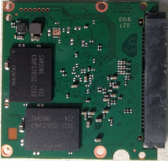

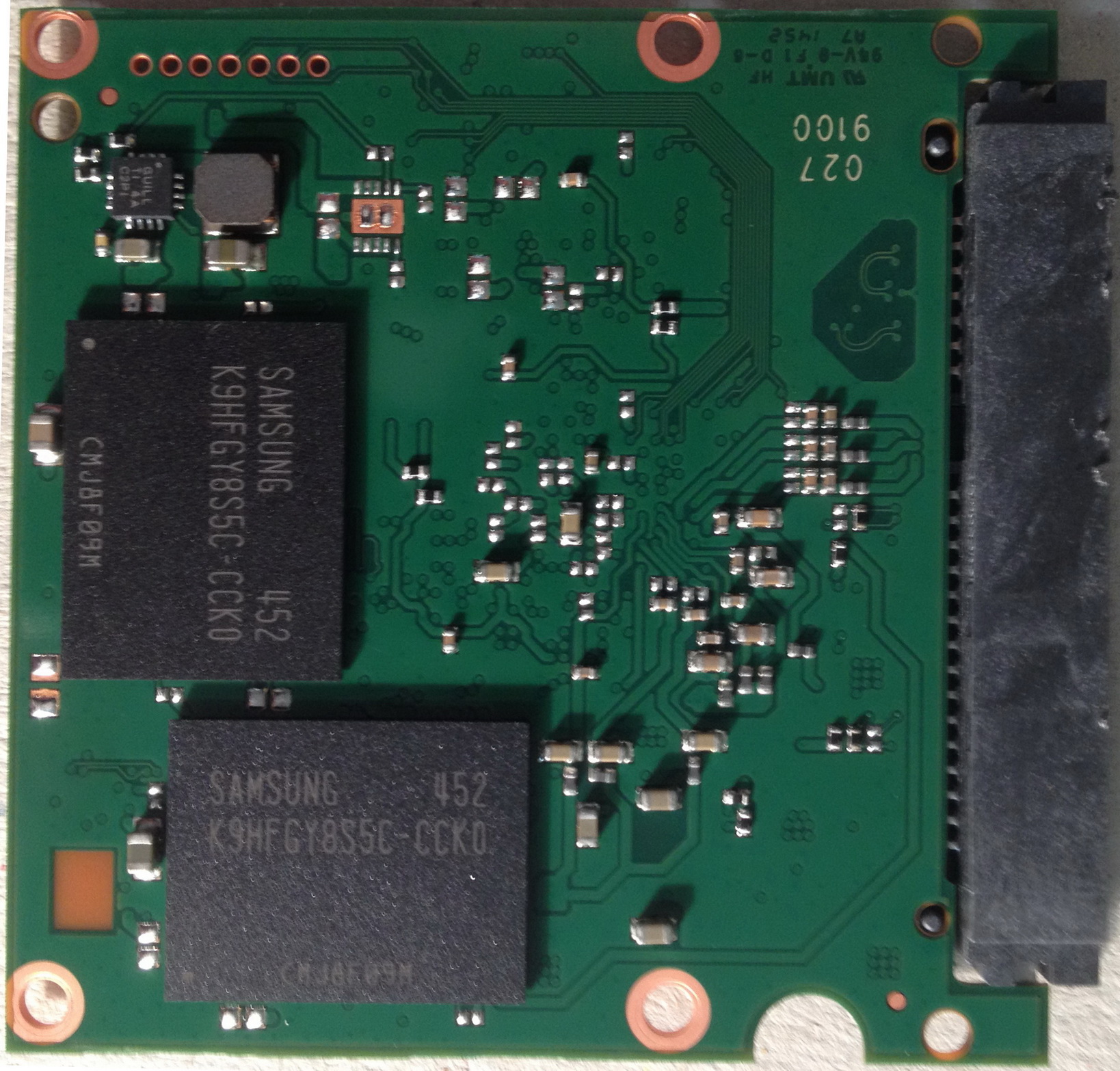

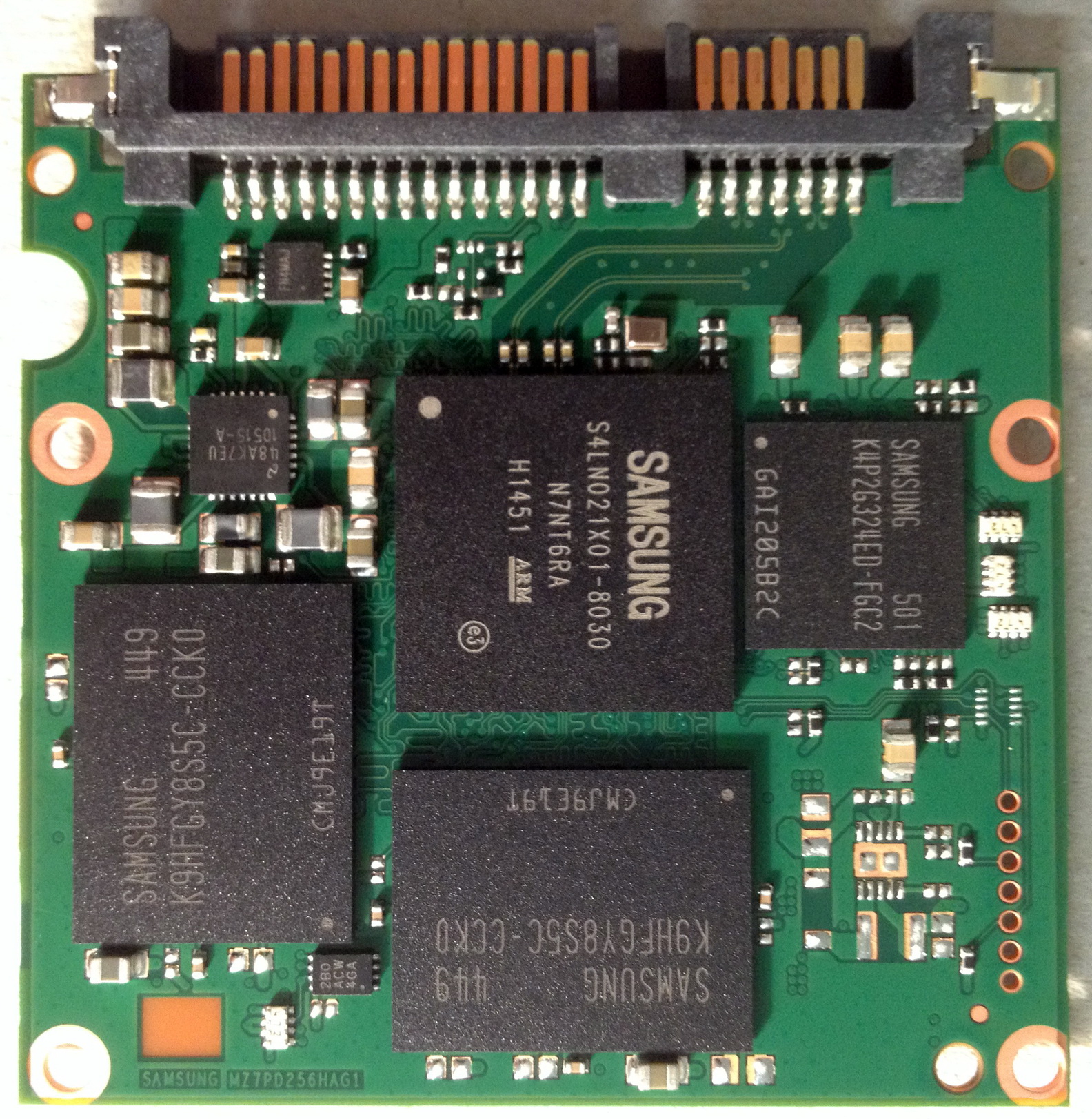

Samsung MZ-7PD128M

I'm certainly not the expert, but those seven plated wholes are pretty suspect.
Assuming just a two sided board it looks like at least six of them have traces.
Could be jTAG, and, or, serial there.
Meter them out. See if some have the typical 3.3 or 1.8v logic levels.

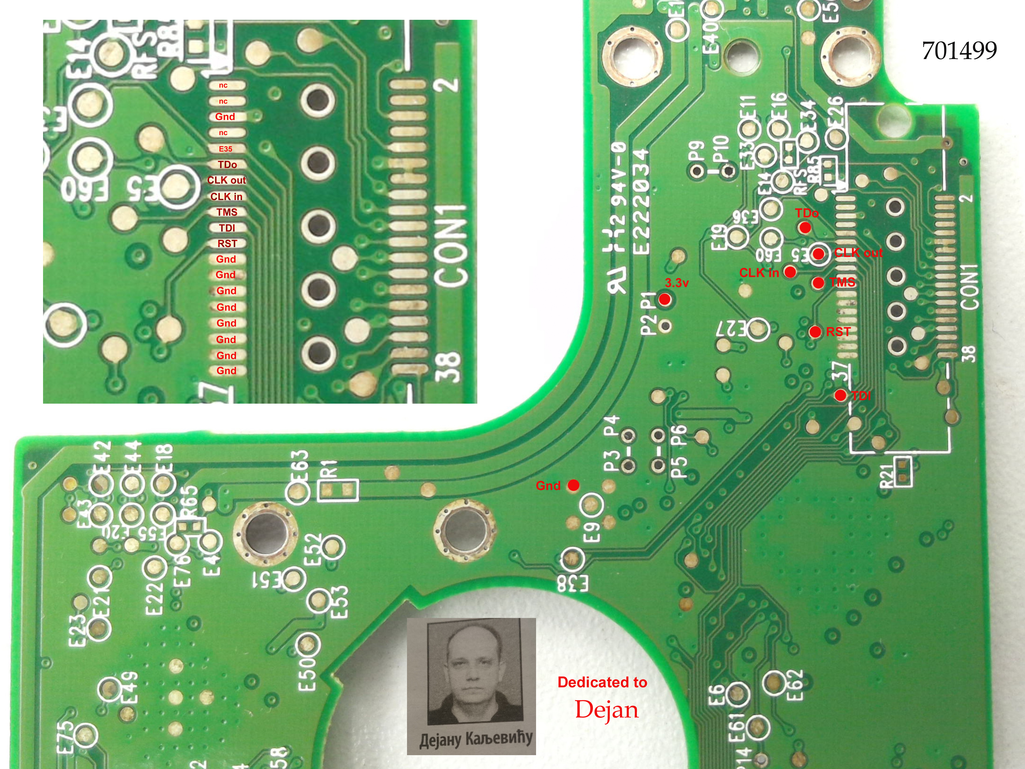

A better image to the Source Code of Marvell JTAG
R.I.P. dejan....
Its Hard to forget someone like you....
