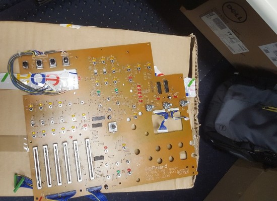

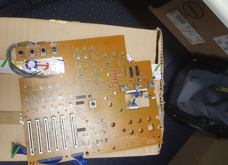

Well I got the board, only problem is they sent the wrong board :(
What the.... that is supposed to be the SalvationData card?

Posts: 4001
no - I won a mainboard http://www.ebay.com.au/itm/ROLAND-SP-808-MAIN-BOARD-CPU-70909001-IN-OUT-PCB-PANEL-SPARE-PART-REPLACEMENT-/322465463551?hash=item4b14707 but didn't get that in the post!
