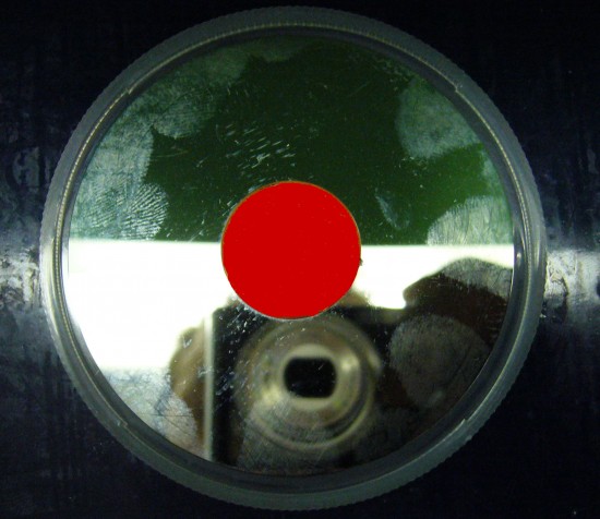

Has anyone done any experimenting with different cleaning solutions for the platters?

what kind of contamination are you seeing? fingerprints and dust from working on the disk or "ground up head and platter"?
post a picture or two to make things fun and tempt useful replies..

Mostly fingerprints. Some dust. I'm studying the platter surface's lubricant. I have a pic of one of the platters in the study. I have tried 3M's PF-5060 as a lubricant. Unfortunately I don't know of a way to apply an equivalent layer of lubricant by hand that is equal to the way the manufacturer does. I have also run into a couple issues with using the lubricant under a cleanroom. The direct air causes it to react differently than when in a normal air environment. Has anyone seen or factually learned the application process of the lubricant layer on the media surfaces? I've read of laser application to form molecular bonds with the previous layer but I haven't found any real documentation.
Please keep all posts focused on the subject matter. This isn't in a data recovery stage. This is just the study of the different cleaning methods and the re-lubrication process. Basically, please don't waste time with "Send to a pro" responses.
All subject related responses are greatly appreciated.

wow, thats a messy platter swap attempt ;)
I am very new here so forgive my lack of depth, but I would like to understand why you want to re-lube. AFAIK not all disks use lube. Assuming that your only intention is datarecovery I would image you could just clean and replace without worrying about lube. as long as the head was on the landing zone or ramp, and the disk spins up OK, it shouldn't stick.
to remove fingerprints: a clean cotton wool bud (called Qtips in the US I think) with 99.9% alcohol in very slow circles, working outwards to edge of platter. working with the air flow of your clean bench in your favour also helps.

I've had good luck with isopropyl 99.99% pure alcohol and a lint-free tampon. I spin the platter and wipe the tampon from the inner track to the outer. The platter comes out clean and shiny.

No attempt at a platter swap here. Straight up testing. Pull the platter out. Put marks on it. See what cleans it the best. Advanced stages will include an attempt at recovering data off of the platter. I thought that I needed to relubricate the platters. I've done many successful headswaps (without any worry about lubricant). As well as firmware repair and logical file system repair. I just don't have any decent, trustworthy sites to pull information about the the platter manufacturing process.
