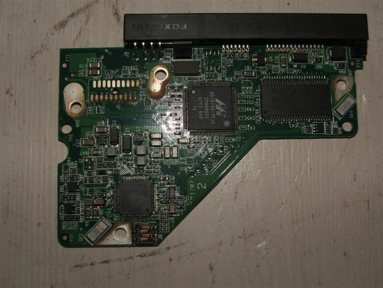

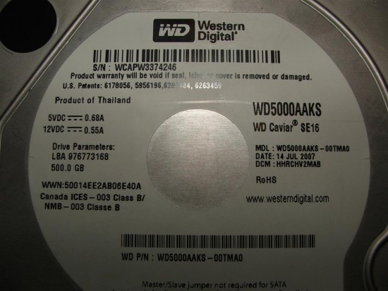

a few weeks ago my Mybook World Edition external harddrive stopped working. After opening the external cover I found a 500GB WD5000AAKS-00TMA0 SATA harddrive.
I tried the hardrive directly inside a PC, but it gave the same problems. The drive just starts spinning, but seems not to find the starting point. After spinning the drive makes some noice, like a hardrive which is searching/copying data. After a few attempts the drive stops and starts spinning again. This cylus repeats a few moments. After the bios could not find the drive, the drive stops spinning.

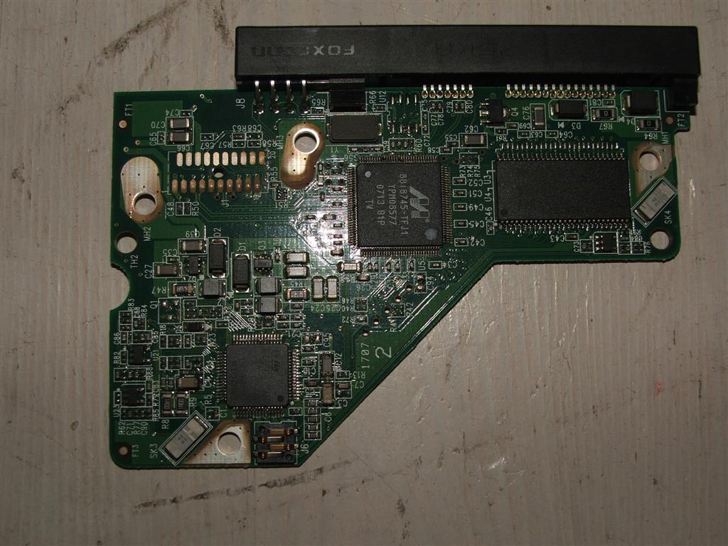

I found a lot of information about these kind of problems and in most cases the PCB is faulty. I removed the pcb and found some foam between the metal cover and the PCB. Th foam shows black spots, which seem to be the result of a too high temperature furthermore some pins of chips are black.

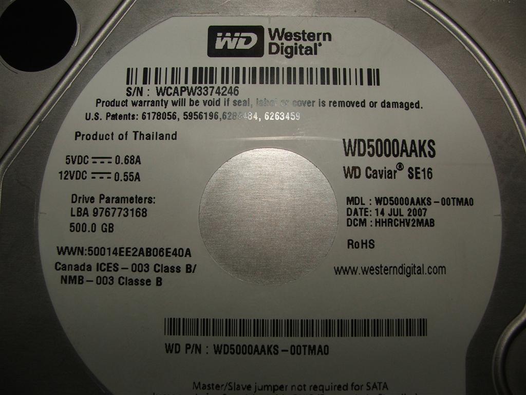

It seems my PCB is broken, so I need a new PCB. I found a lot of information you need to replace the PCB with the correct version. I've a WD5000AAKS 00TMA0.
Can anybody help me in finding this PCB or assist is solving these problems? Unfortuantely the data on the drive is not backuped and very important to me. A professional data-recovery company told they could recove the data, but the costs where too high for me.

This sounds more like a head problem, not a PCB, that is why DR company gave you a high quote.

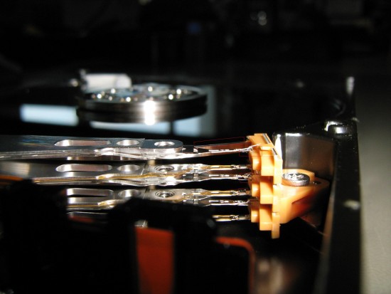

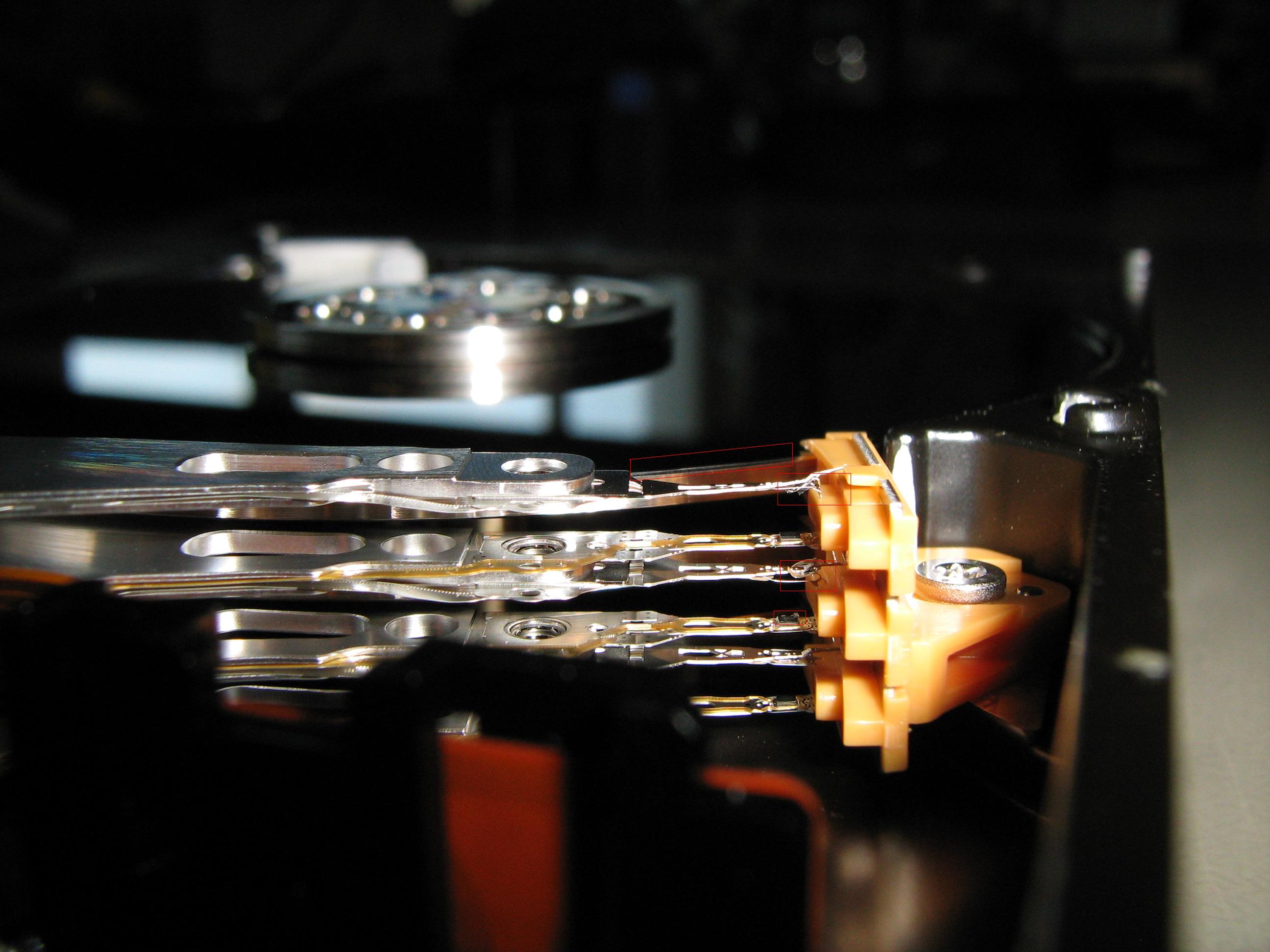

I had a bunch of these this week. Listed in order of most common
1: Head Crash
2: Stuck Spindle
3: Heads stuck between platter and load/unload ramp ( See picture as example)
I haven't seen any this week with a bad PCB even tho they do look oxidized :roll:
