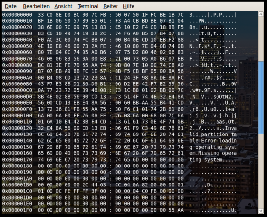

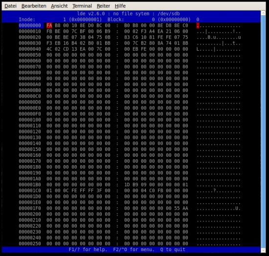

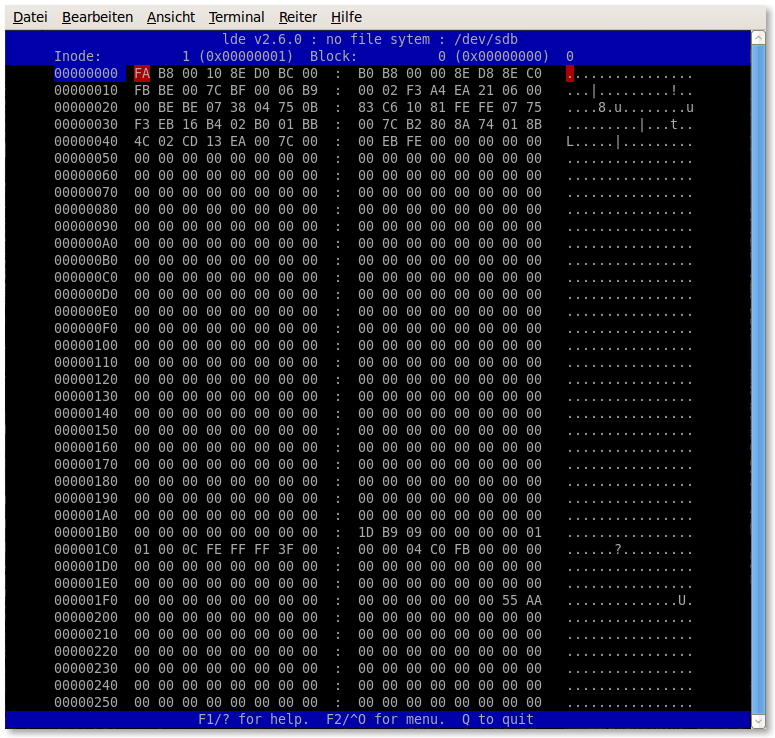

Hi everybody,
at the moment I'm trying to analyse what exactly the formating of a partition in FAT32 does. I know, that has been done before, but I learn better by doing it on my own. :)
Know I realized that the Boot Code in the Volume Boot Record matches exactly to what I find in the Internet. But not the Code in the MBR.
What I did ist this:
-1- Write 0x00 to every sector using dd if=/dev/zero.
-2- create a primary partition.
-3- Format this partition with a Windows XP prof. SP2 OS to FAT32.
So this is a pure data storing HDD, no OS installed there.
Now my question :
where can I find the code explanation for an MBR with these specifications?
I looked at, for example, http://mirror.href.com/thestarman/asm/mbr/index.html
but they don't have the code i found...
I added a screenshot of "my" MBR.
Any ideas?
Thanks,
Erik
File comment: MBR without OS / FAT32

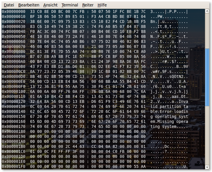

Sorry, wrong screenshot. This is the actual screenshot and this is the typical Win XP MBR. I'm sorry, my fault. :(
Can be closed... better deleted :)

well if u want to know on deep what its this code,one way u can use Debug a powerfull tool :D command acccesing by Int13h , to unassembly it and let u know what does it mean the opcode 33 C0 and so so : if im remeber that means disable ints.after that setting stack to segment 000 ,setting stack to pointer 7C00 to load on that memory zone the MBR , im not sure :roll: that first bytes are the called Bootstrap code, then at offset 1B0 its starting the Partition table info,but the best its "unassembly" from this way u can understand what its happening on deep well u need to know assembly Opcodes to do that :) aaah!.. a little tip when u find " CD 13 " that means Int13h
55AA its the boot signature...
