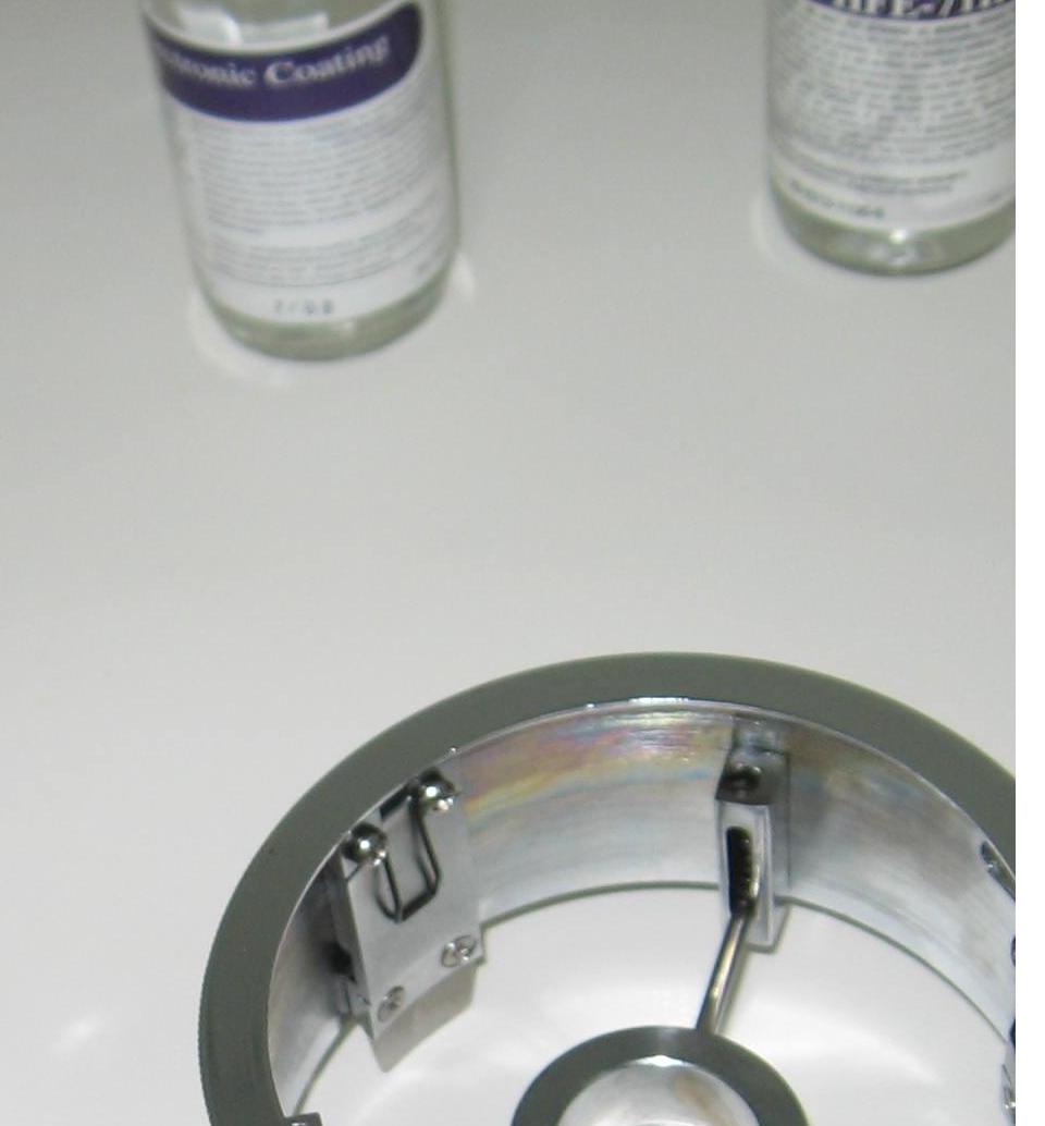

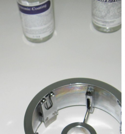

 Post subject: Re: cleaning the platter
PostPosted: August 26th, 2009, 17:06
Joined: June 9th, 2008, 12:06
Posts: 213
chamxz wrote:
pcrecovery wrote:
the end
Look man if you don't know to answer is better if you don't say nothing I always thing that the forums is for people who want to share experience so if you all of you don't have a real answer for the problems if you don't know the solution its peter to stay away......
Sorry, but in the previous post, it appeared Pepe answered precisely to your case. Also, I have started several posts about cleaning hard drive components, and I do not think it is plausible that I don't "say" or "know" . In fact, here are some samples...gratis
