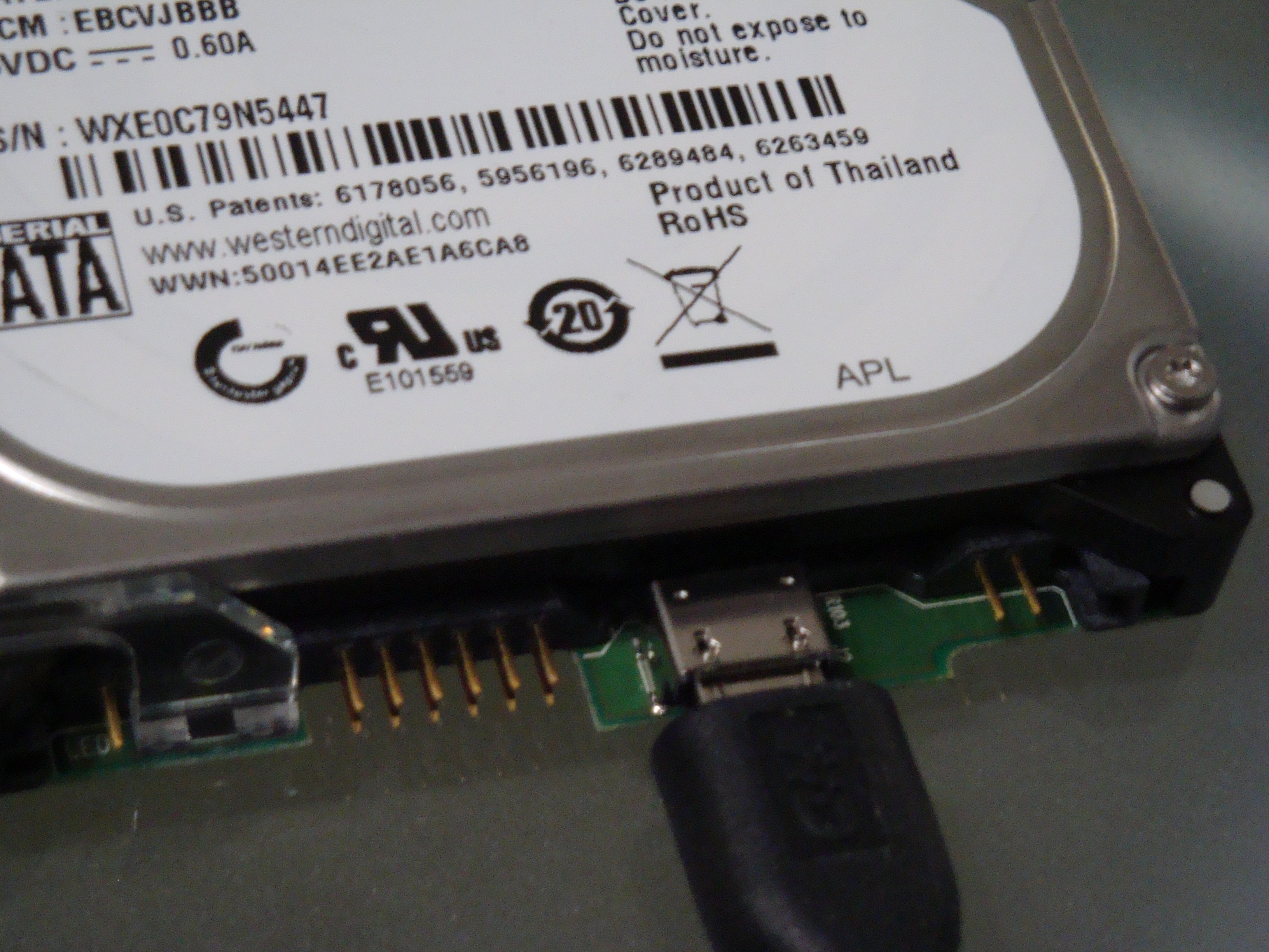

It has a micro-usb connector, as can be seen on the picture here:

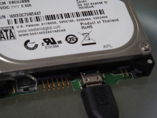

Once out of its casing it also has pin connectors. 2 rows of 6 + one isolated one of one side of the micro-usb connector, and a pair on the other side:
It has no power jack, when used within its casing it takes its electricity from the usb connector. On the other side there is a board nearly as large as the disk casing itself.
The problem with this disk is that it cannot be used via the micro-usb connector because it has a dual partition. One normal partition for data storage and one vcd (virtual cd) partition. The vcd is seen a read-only cd drive and some machines (cameras, VCRs, etc.) won't have anything to do with this external drive because of that. The vcd partition takes 700MB out of the 1T storage space, not a high percentage so this is a side issue. All my attempts at removing this partition, reformatting the whole disk, etc. have failed. I tried some Windows tools, including U3uninstaller.exe and DBAN, and some Linux tools (fdisk, sfdisk, parted, gparted, u3-tool). WD offers to its customers a way to hide the vcd partition but this does not delete it and this has to be done on every pc the drive is connected to. So it does not solve the problem for cameras and VCRs. After long researching online the only people who reported success deleting a vcd were saying that they had accessed their drive via the SATA connectors. But they were not talking about exactly this external hard disk drive, only about other WD products. One example of such advice was someone who said they had connected the disk in place of their usual internal hard disk and installed Windows XP on it. They said Windows XP reformatted the drive which could then be taken out of the pc, replaced into its casing and used as wanted.

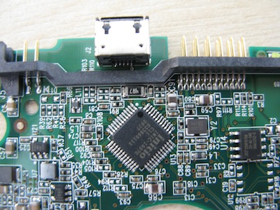

Hi there, the virtual CD that loads is the WD SmartWare software that encrypts the content of the drive.
There is no way of removing this functionality as far as I am aware, however I have not actually ever attempted to do so, we normally just unlock then clone and return the device.
If you take off the PCB you will find an Initio chip, this provides the real time encryption/decryption of the data. The virtual CD is needed by the device to launch the authentication program that allows for access to your data. Without this I do not believe that the disk would work at all.
I don't think WD are transparent enough about how this system works with their end users.

Here is an image of the chip (just in case you didn't want to remove the PCB)!
