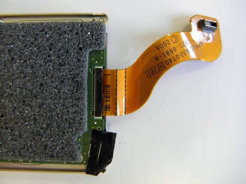

Do you know if it's exist adapter sata or ide for the HDD Samsung HS212UHE ?
This isn't ZIF connectivity. We havn't find a compatible adapter to SATA or IDE.
Model : HS12UHE
HDD P/N : HS12UHE/A
REV.A

could you please provide some images for the Interface
specially the ribbon
and the pcb if possible
thnx

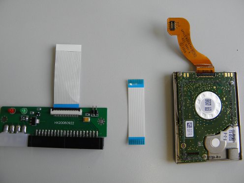

Thank you for your answer einstein9 but check the number of the pin on my picture and on your ebay auction.
This is not the same. See my new picture. On the left, this is a ZIF adapter to PATA, in the middle, a compatible cable for my HDD and on the right, this is my HDD.

thats why i asked about closer image
so this doesn`t work

yan1982, can you upload closer very close image of the ribbon i wanna see the pins how many if possible
many thnx

We just had one of these nightmare drives.
It's a LIF-connector - not a ZIF - It only has 24 ribbons in the cable. But it’s just a SATA connector wired differently (and some power /ground) … at least that’s what I could get out of google and http://forums.macrumors.com/showthread.php?t=657341
(Been told there exist a small-LIF as well with an even smaller FCC-ribbon).
We haven't been able to find an adapter to SATA - but there is an usb adapter, (thank you to the guys at Data Clinic)
http://www.mydigitaldiscount.com/SPD/runcore-1-8--sata-lif-usb-2-0-hdd-ssd-enclosure--80000D7A-1270043844.jsp
But then again... a usb connection is far from optimal, if there is some kind of damage - guessing you can grab the SATA data stream from within the usb-adapter - if you do find a way... please upload the schematics;)
Best of luck
Michael, PAD-dataservice
PAD-dataservice
http://www.pad-dataservice.dk
 Post subject: Re: Samsung HS212UHE connectivity - Apple Macbook Air
PostPosted: October 18th, 2010, 17:46
Posts: 17223
PAD-dataservice wrote:
... guessing you can grab the SATA data stream from within the usb-adapter - if you do find a way... please upload the schematics;)
SATA requires 2x TX and 2x RX wires, plus ground.
If you can upload a detailed view of both sides of the PCB, then it should be very easy to identify the signal pairs.
