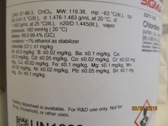

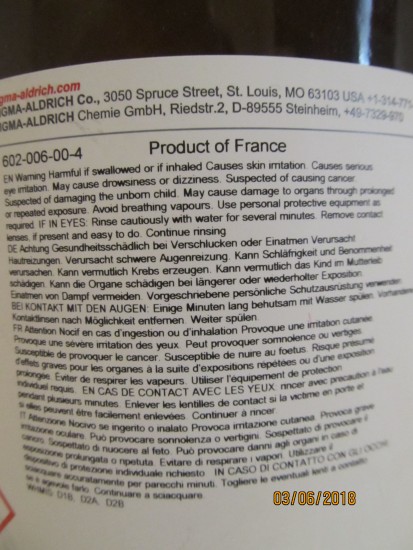

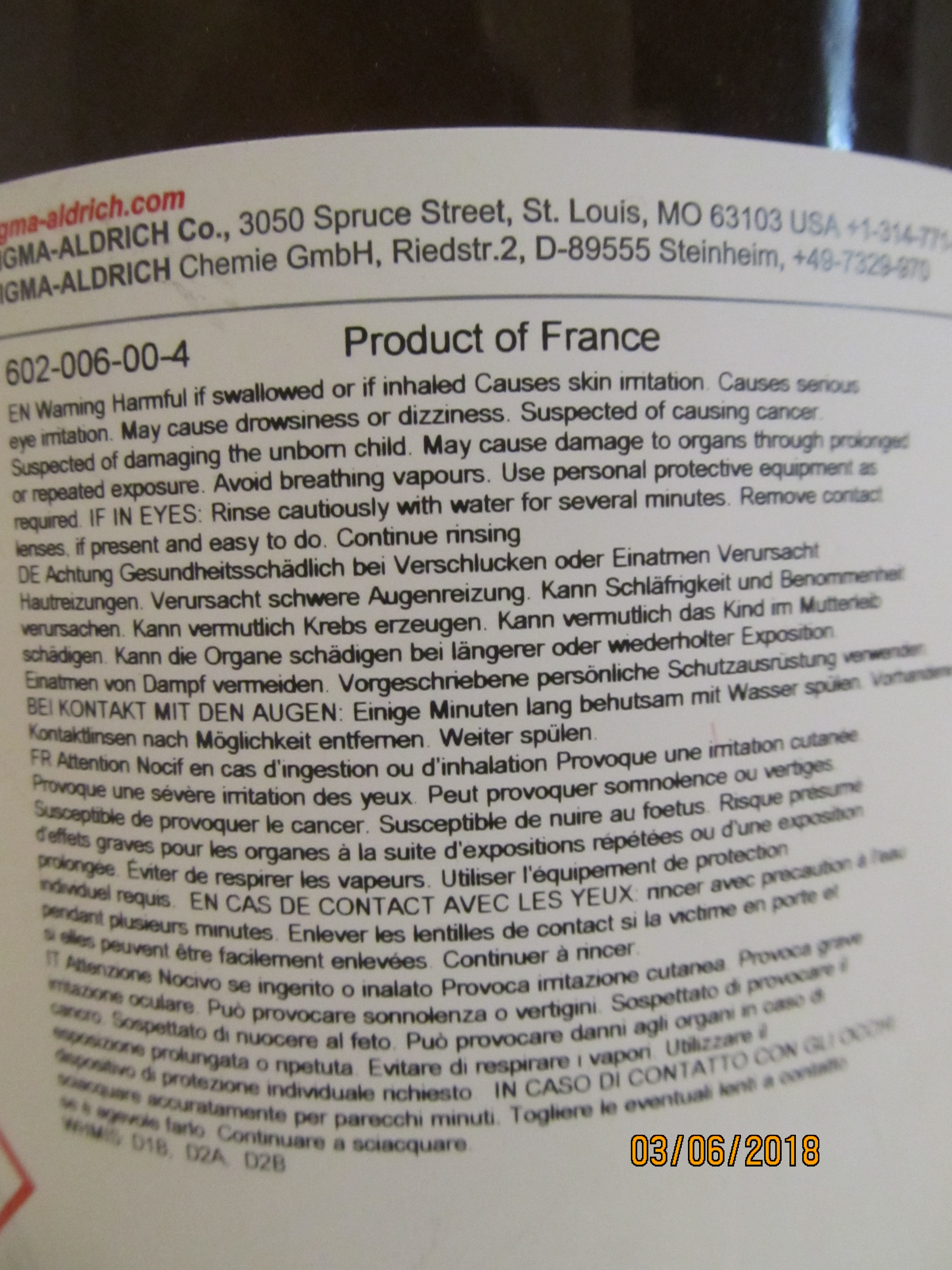

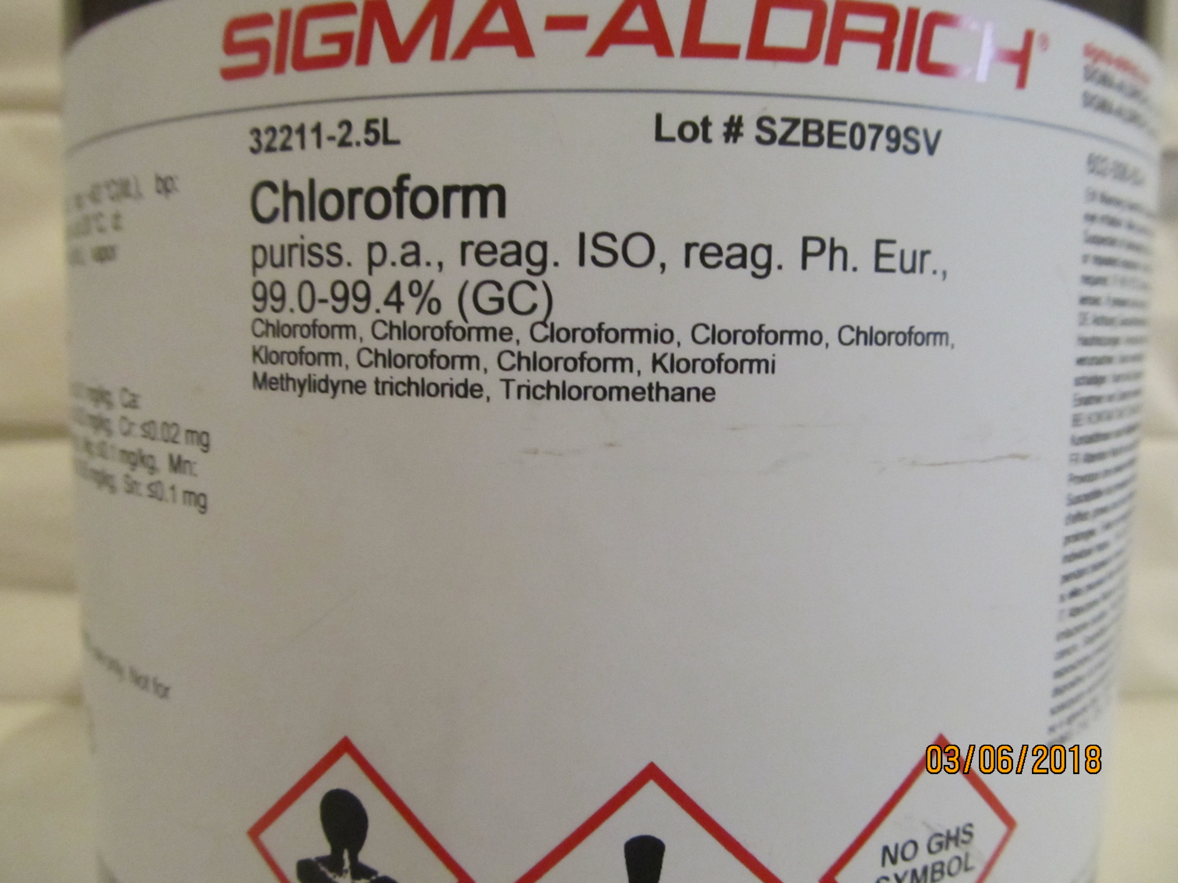

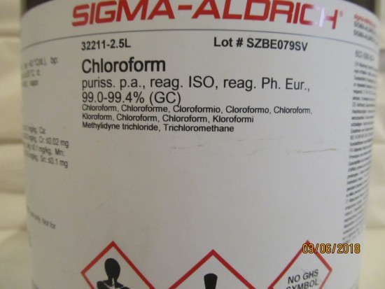

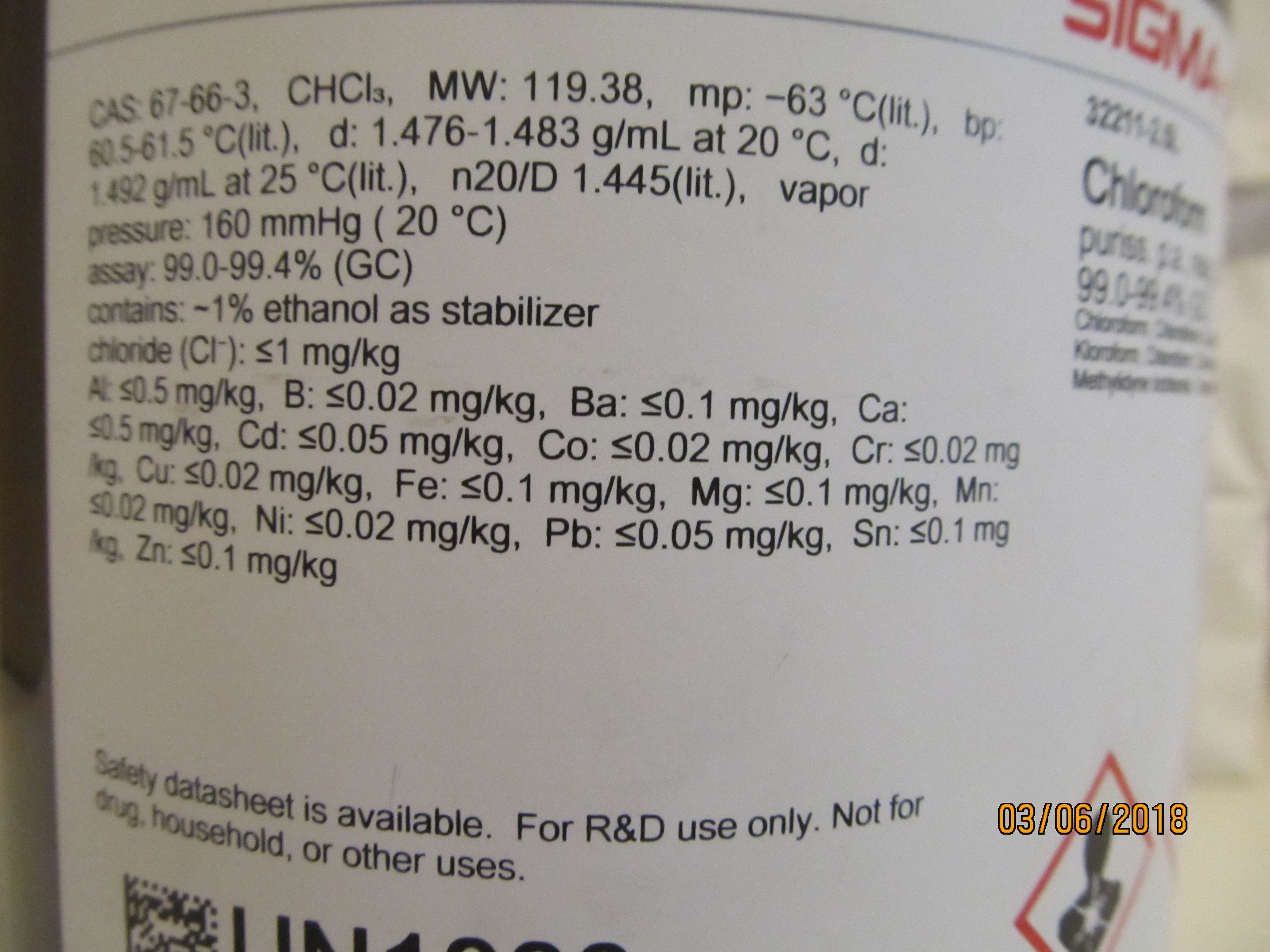

As an update here for this topic, here is what i used for cleaning and you have to be extreme careful when you are working.
Used 2 chemicals:
-isopropyl (you can find it) Ref. https://en.wikipedia.org/wiki/Isopropyl_alcohol
- CCL4 Warning: you need to be Extreme careful when using it (image attached)
its too difficult to get it since its banned coz it cause cancer and more.
Ref.: https://en.wikipedia.org/wiki/Carbon_tetrachloride
The other 2 am still testing but those 2 are tested 100% and gave better reading performance.
If you plan to try/use the CCL4 you SHOULD consider Maximum ventilation system
For those who sent me PM`s will have more details. :beer: :agree:
Thank you
File comment: CCL4
File comment: CCL4
File comment: CCL4
